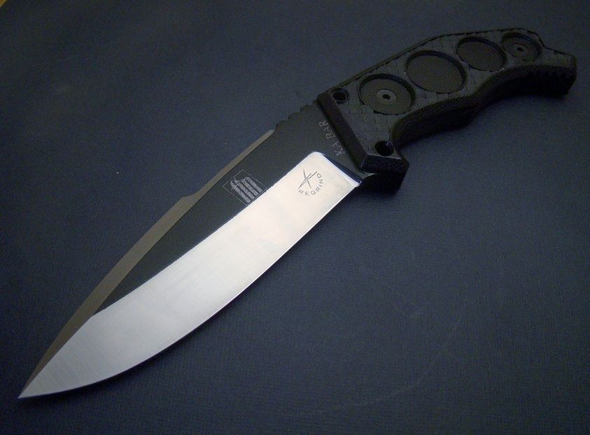

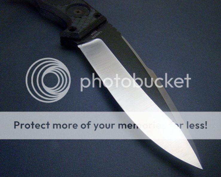

Just finished this one up - the owner carries it all the time but found it a touch heavy. I converted it to a hollow grind, raised the grin-line a bit and removed some of the tang under the scales to get the balance back over the first finger again. The diet was pretty effective
Thanks for looking
