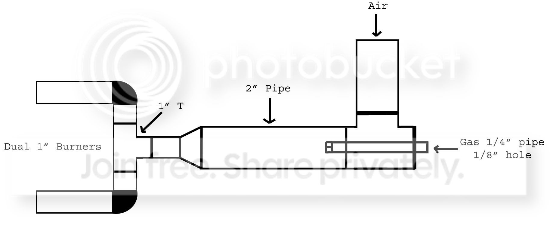

Then secondly. I was brainstorming today and wondered if this is even an option for burner design? Having two burners inside a 6"x16" chamber has got to be better than one, and I don't need double the parts. Thoughts?

Sorry I should have labeled it "Forced Air" instead of just "Air". I have a blower for the burner....so if its a blown burner, do you think splitting it will work?

You are close on the burner design.
make an air manifold, and have the two burner tubes come off it at 70-80 degrees. have a separate gas inlet on each burner with a needle valve. that allows tuning the burners. As drawn by you it would be impossible to regulate the burners very well. I'll try and draw up a quick sketch.

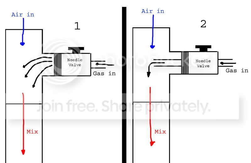

So in "Vulcan's Charriot" and also in your drawing Stacy, does the gas entering the "T" have a tube that extends into the Air Tube so that it is centered for mixing, or does the gas line just screw into the "T" fitting and you call it good?

Also, I'd use an elbow instead of a T at that bend in pic #1.

I've never made a two burner forge manifolded as you've drawn. However, you are choking your flow down prematurely by necking the inlet to the "t" to 1", especially if your blower isn't a high pressure (not volume) unit.
Diagram 1 is correct. No need to inject the gas, it mixes with the air flow just fine.

How would inserting and elbow, to replace the tee improve the operation of the forge?
