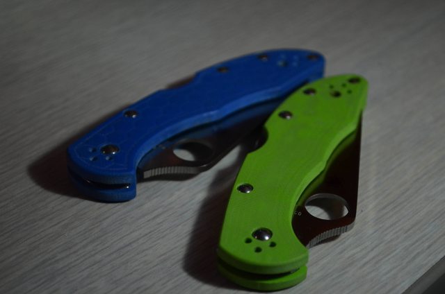

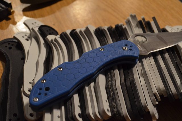

This has been a LONG road traveled and I couldnt even count the hours spent on this project but the code is finally perfect. What do you guys think?

Looks good! How did you overcome the strength issue around the spring? Also is there some difficulty in installing these because they house the spring? If I'm way off then correct me. Thanks.

No you are not way off at all. In tests i found many materials that would not last and support the spring as needed. The "nubs" of the back spacer would just break off. However the g10 (if machined correctly) has not broken yet. The real risk I have seen is during assembly of the knife, when only 1 of the nubs is holding the spring back you are putting a lot of stress there. Once both liners and scales are installed it holds as securely as the factory scales.

I agree. As far as the G10 breaking, it should be a non-issue and is likely stronger than the factory FRN scales to begin with. Might be interested in a set of non-patterned ones myself in the future. They look great.
