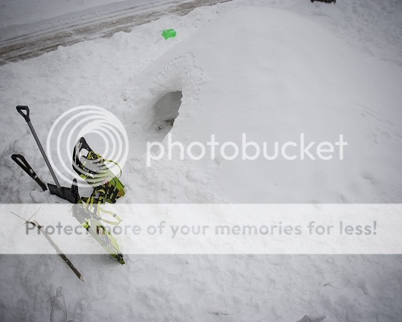

After that, it was Quinzee time. Before starting to shovel, I started piling and piling the snow up.
The size can be hard to tell, because there is not much for scale, and the shot was taken at 17mm. Ideally, I would have like the shelter a tad bit bigger. But, I really don't have much yard, and I really started running out of snow.

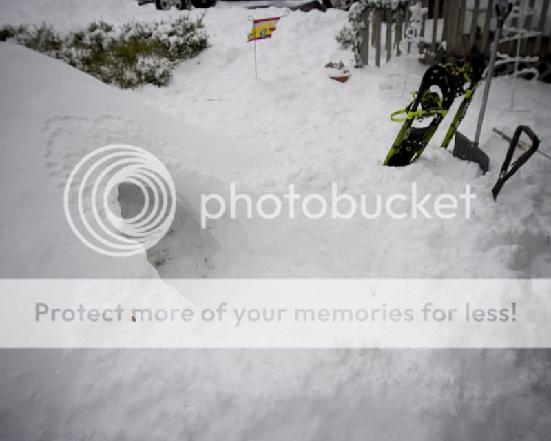

The entrance way.

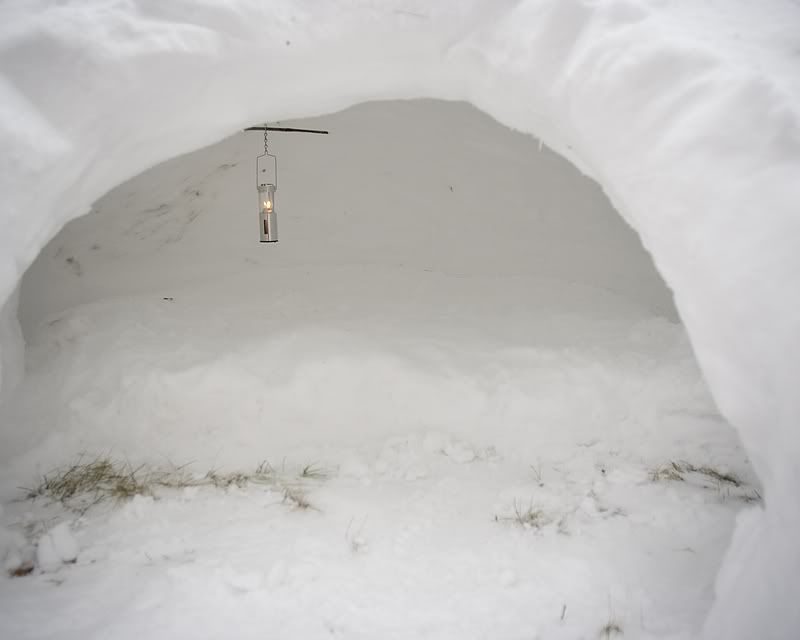

Finally, the inside.

That looks great! ONe question though, how thick are the walls/ how deep did you go with the depth gauges?
Again, this is one of the "opinions" that seem to vary wildly. Have heard or read the following:
- 12"
- 18-24"
- When you can start seeing light through the snow, the thickness is about right. I have personally found this to be too thin.
With all that being said, I shot for between 12 and 18".
Some of my friends make them very regularly while snowshoeing and backcountry skiing. When they are done, they generally stand on them to see how strong they are. I will ask them what they shoot for, but I am guessing it is not too far from the first two mentioned above.
