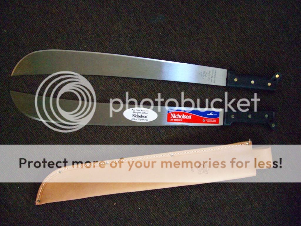

Just pictures/brief descriptions for now. I'll do a review when the circumstances present themselves since I'm unfortunately not in an area right now where I'm at liberty to swing a big blade.
To start with, I picked up two of these things since they were only $6.00 a piece. Here they are as they arrived.

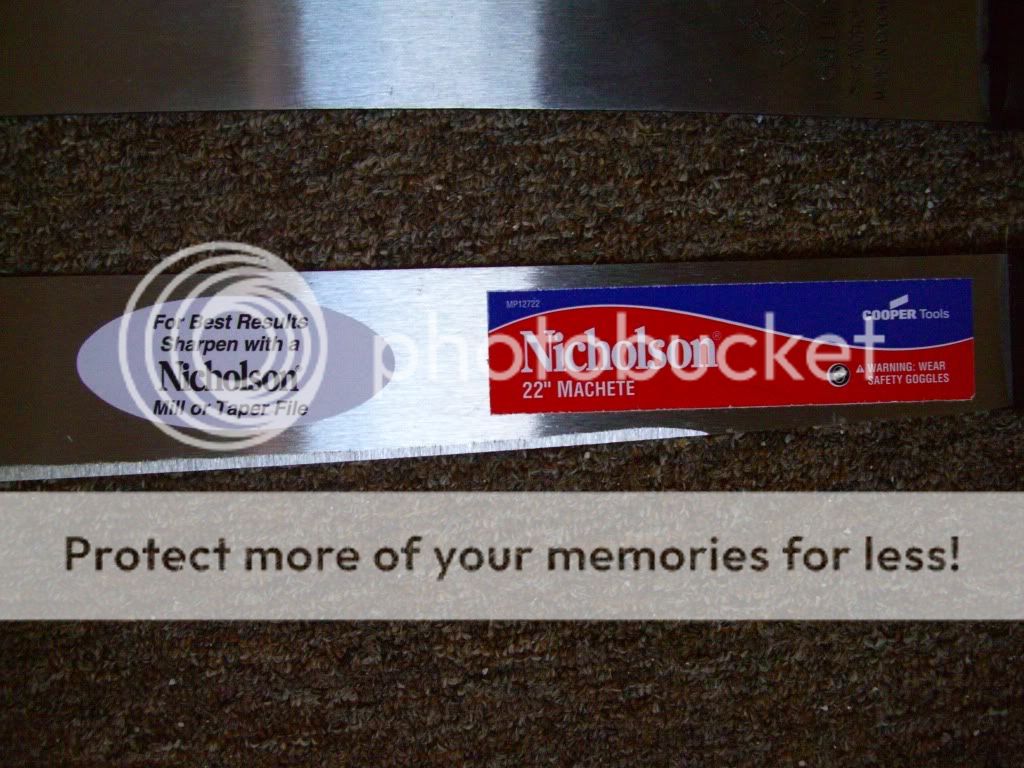

These were labeled on the packaging as Nicholson machetes made by Cooper Tools. Of course, as you might expect, it recommends sharpening it with a Nicholson file!

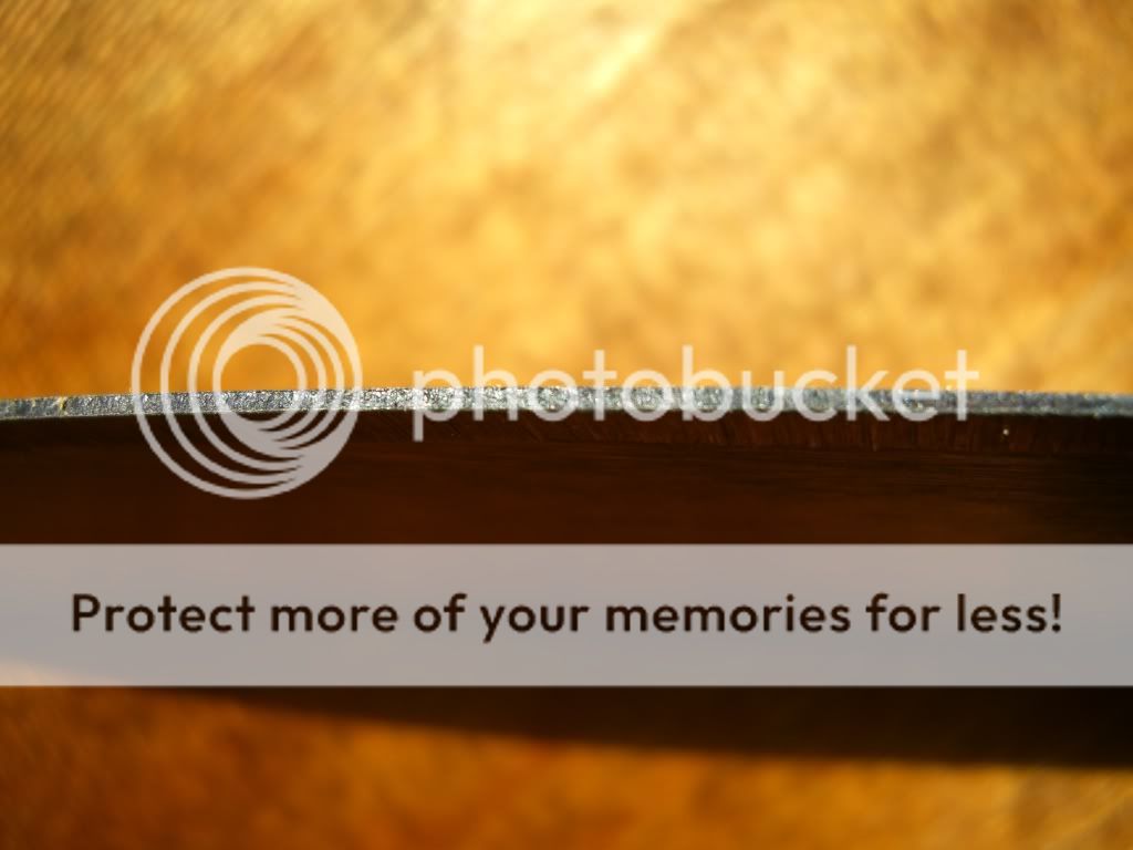

However, you'd better make it a pretty coarse one to start! Here are a few macro shot of the "edge" :D

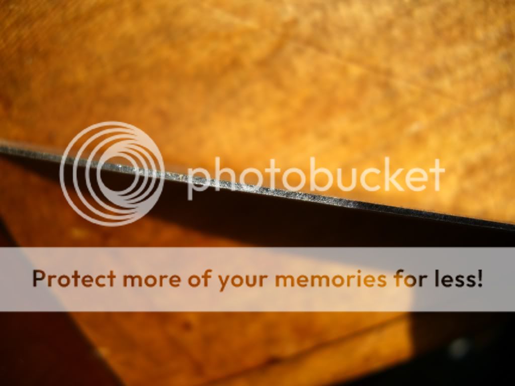

Here's a shot of the spine. Hard to tell it and the "edge" apart, eh? :D

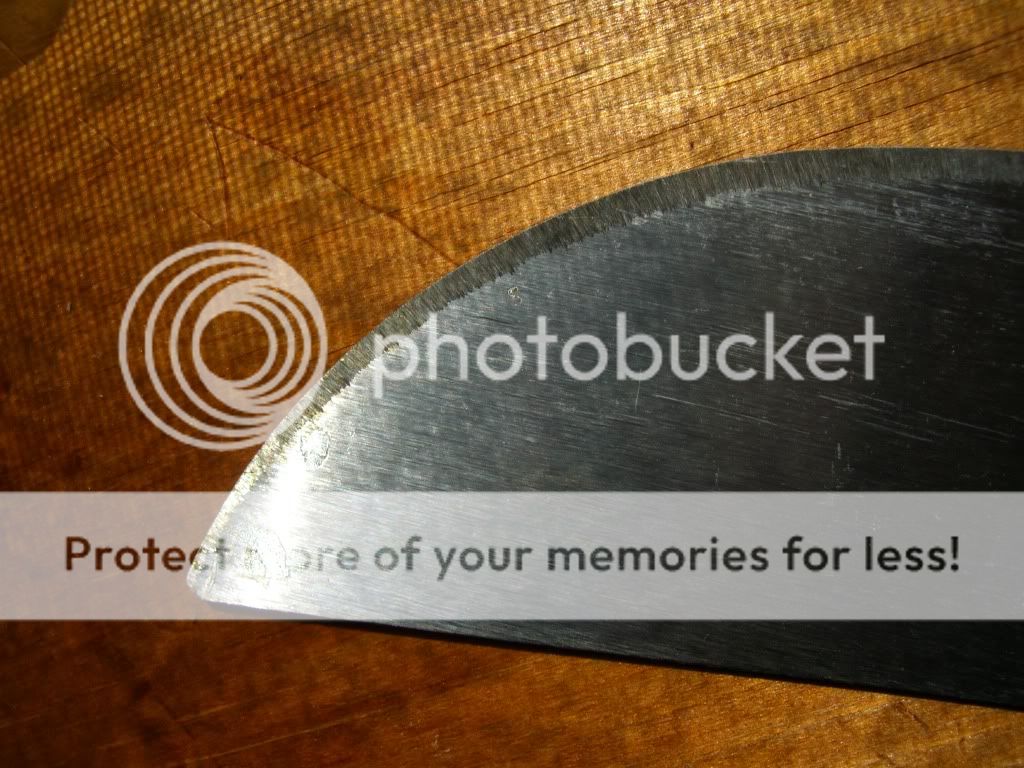

In spite of this whoever was at the grinder still had managed to round the point pretty badly.

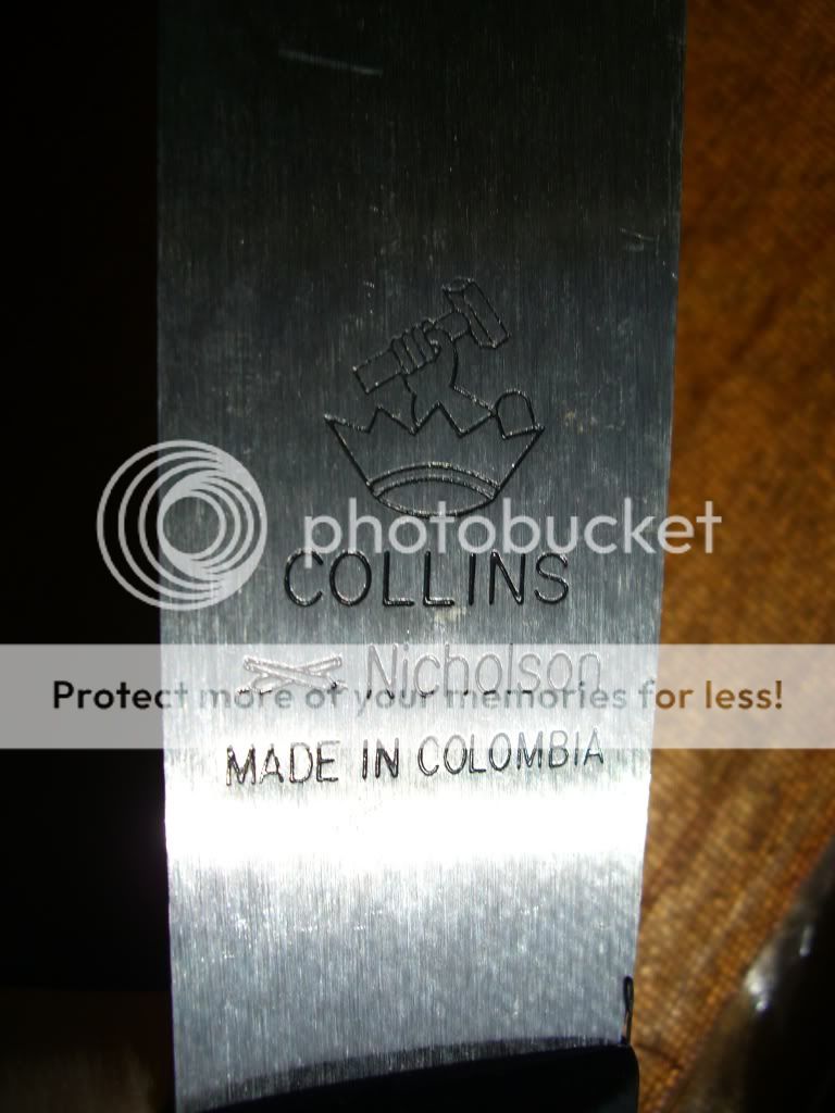

In spite of the whole Nicholson/Cooper labeling, here's a shot of the blade stamp.

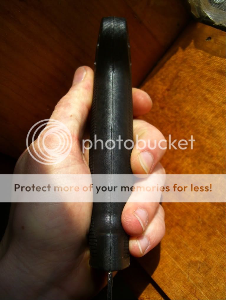

A few close-ups of the handle. Notice how the scales encapsulate the tang. I found this rather interesting, given that it's not injection molded to the tang.
After a LOT of friggin' hand sanding (I'm in a small loft-style apartment and don't have appropriate power tools) I was able to smooth and round the spine and ricasso, put a point back on it, convex the edge, and bring the whole thing to a satin-mirror finish. It took FOREVER, even starting at 60-grit, given how rough the original finish was.
MUCH better. This is gonna' be one hell of a sweet chopper. The steel has a real nice firm flex to it, so in spite of being so long it doesn't flop around. Felt nice and hard under the file as well, so I'm guessing that edge retention will be pretty decent. :cool:
