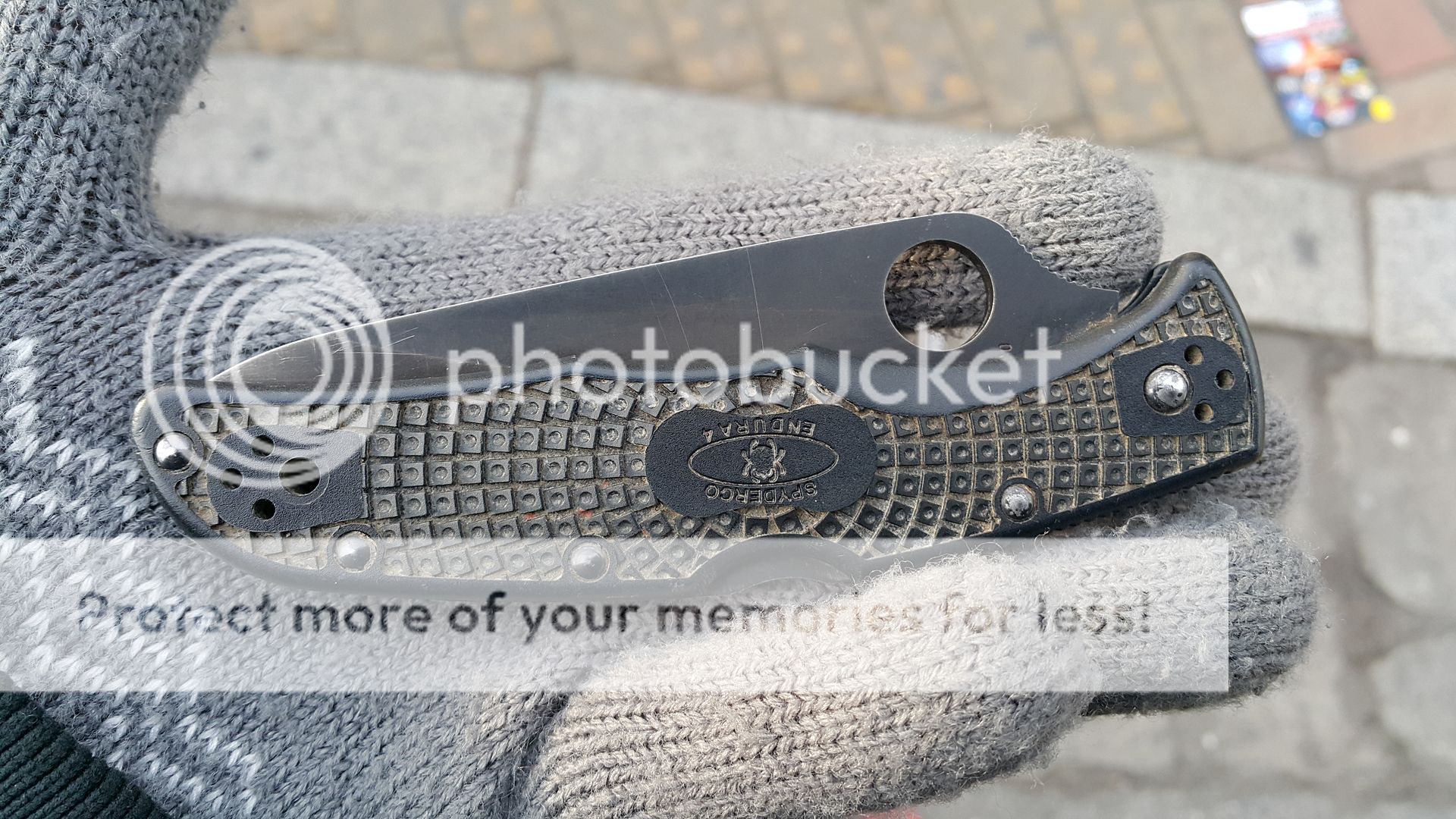

Finally have a Endura 4 + Restorarion photos
Jul 22, 2008
1,597
The used knife seller was asking the equlovant of 3 dollars.
Couldn't say no.

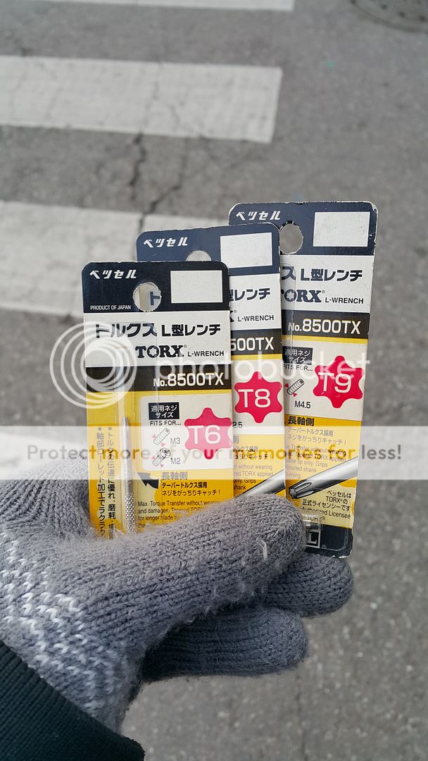

... quality torx set
JDM Vessel brand. $2.50 for the set. Some hard bargaining.

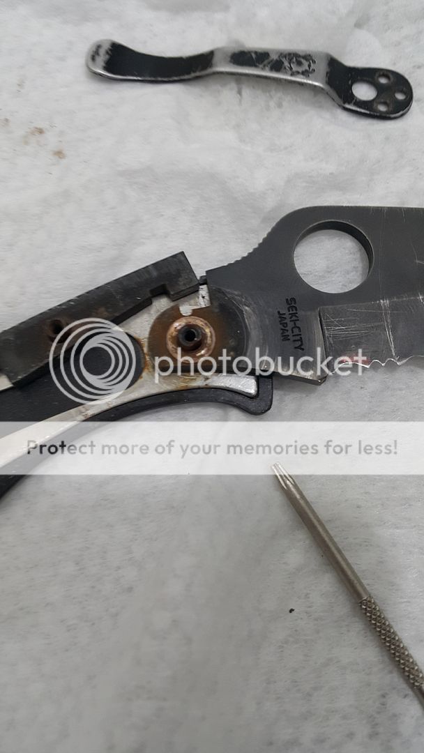

I took it all apart and found it was rusted solid!

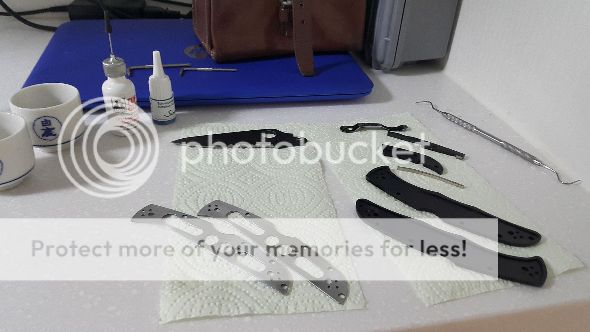

Tools:
Glass platen
Dental picks
Rodico
Diamond pastes
bambo chopsticks
denatured alcohol
1k~3k sandpaper
WD40
fiberglass scratch brushes
Method:
Soak, Scrub Repeat on the big parts.
Pivots and screws get detailed with the dental tools and scratch brushes.
washers get rubbed down then onto the platen for a quick rub down to remove any burs.
Liners then get some special attention with polishing up the contact areas with the washers.
And assemble.
Rubbed the liners and standoffs (correct term?) with some Tuffcloth.

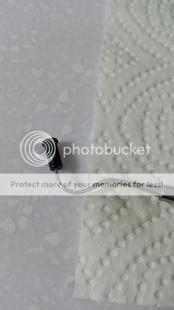

Tuffglide the contact points in the pivot area.
Locktite the screws.
Finished!

This was a milsurp knife: It was used hard as nature intended. Likely parted ways in the trashcan due to it not working before the resto.
Nice work! Always a warm fuzzy feeling seeing a win-win... the original owner got his money's worth out of the knife, but you now also have a like-new Endura to enjoy for a bargain price
Good for you. Years and years ahead on that Endura. Great save :thumbup:
Neat thread!
I like seeing process like this. I also have some Vessel screwdrivers. :thumbup:
Look at all that wear on the clip. Someone carried that thing for a long time before parting ways with it.
I've had black clips wear down nearly that bad in a month or two of carry. Now if I get a knife with a Japanese black clip, I always strip the paint and brush.
Which brings up the question, did you strip and brush or polish the clip, petah?
