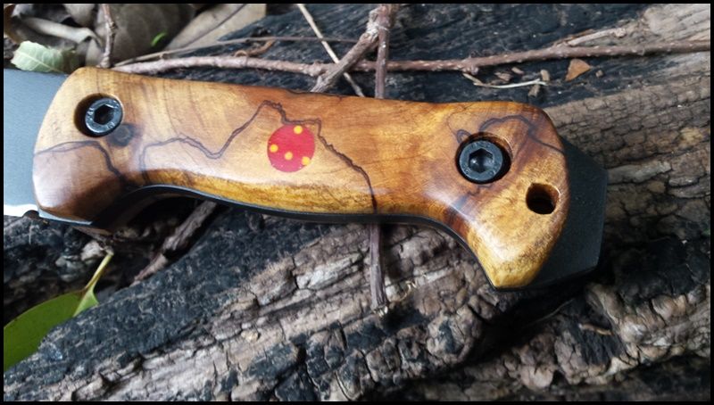

Hello all, Ive been a member here for some time now but Ive been in the learning phase of this hobby and havent had all that much to show. Ive mostly just purchased blade blanks and maybe applied my own finish and a set of scales then made a sheath and stuck it in the drawer.
This knife was mostly learning the beveling process with a file and jig and heat treating. The steel I used certainly isnt the best either but it came to me for free and it took a nice edge. I definitely need to get a forge sorted out before next round as a couple Map gas troches didnt seem to be efficient but it worked. Its my understanding I had a piece of 1018 which is said to be bottom shelf but still heat treatable. I just got it cheery hot and a magnet on a stick didnt stick anymore and I quinched it in canola oil and gave it a ride in the powdercoating oven.
Anyway, its pretty much a flat out copy of a Becker BK-2. I found a drawing online and imported it to autocad and made it suit my needs. Wanted to make sure the blade was legal in Texas as we have some goofy knife laws for being a toughguy state. You can tote a pistol in your car without need of paperwork, no questions asked but you better not have a blade longer than 5.5 inches?
Instead of countersinking nylock nuts into the scales I chose to counter bore and then drill and tape threads into the tang see that it was a full 1/4" thick. The socket heat screws needed to have their length adjusted so they didnt bump in the middle and I added a dab of blue locktite on the final assembly. The scales came from an Elm tree which got in the way of my buddies new garage. Found the spalted sections and saved them for a couple years before remembering I had them. The red dot is just a fix. The originals used 3 sets of hardware to secure the scales and I was going to as well but I screwed up drilling the middle holes and it was going to be start over on the scales or make ugly adjustments or fill the holes so some testors model paint mixed into some 5 min epoxy and there you go. The yellow dots are repairs to the repairs! I walked away and bubbles surfaced in both repairs so I drilled the craters they left and filled with yellow epoxy. I know someone does something similar as a makers mark but my only intent was filling the holes.

Spalted Elm scales with a super glue finish. I started using super glue for a finish while making some fancy slingshots. Its a nice hard finish which drys fast and buffs up well after sanding.
