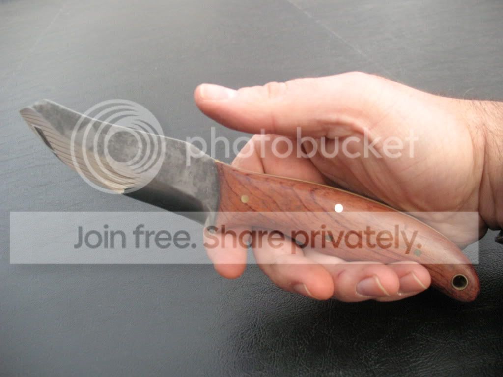

So thanks to all of you who helped me getting started. I also have to thank my new friend P-Y (who goes by ''Defaultuser'' in these forums) who shared his experience with me and gave me the last kick in the butt I needed to get going. P-Y is a very talented knifemaker btw. He also lend me his copy of the $50Knife Shop" by Wayne Goddard, which was a really good way to start. It only took a few pages of reading to make me jump on the grinder and start making something. I wasn't even sure what exactly I was gonna do but I think it turn out pretty well IMO.

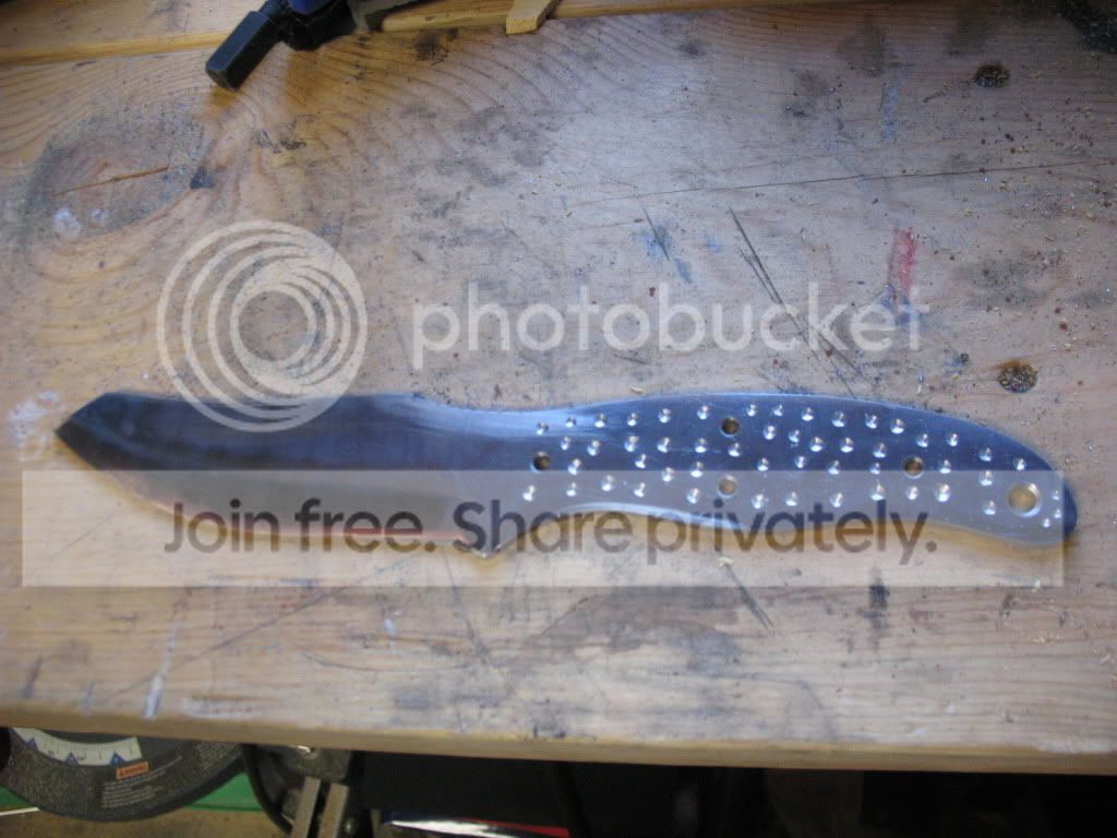

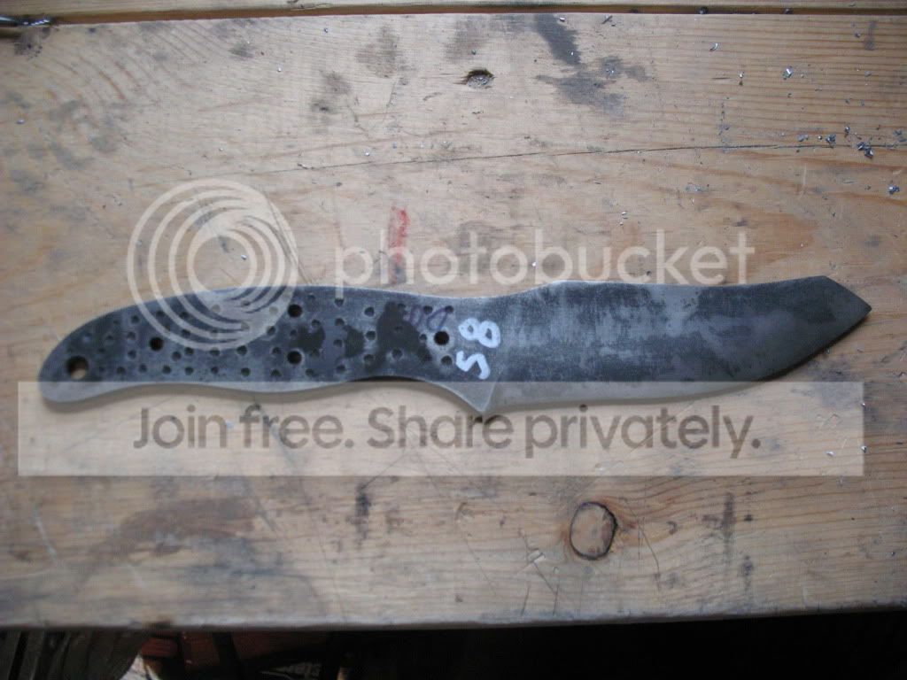

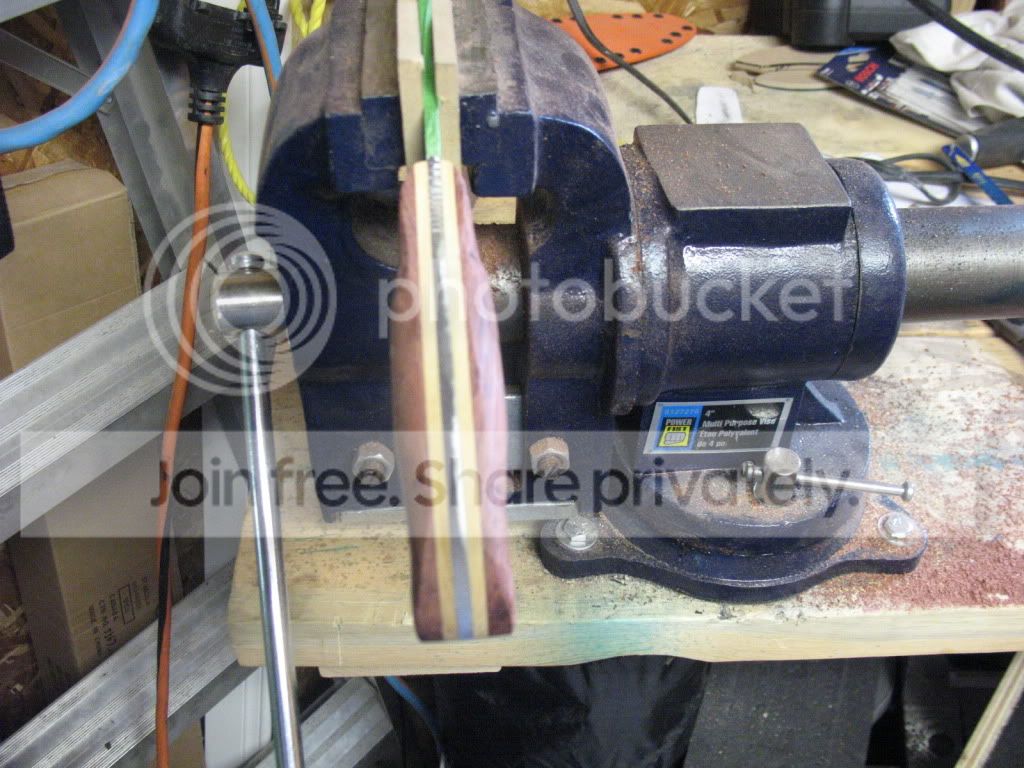

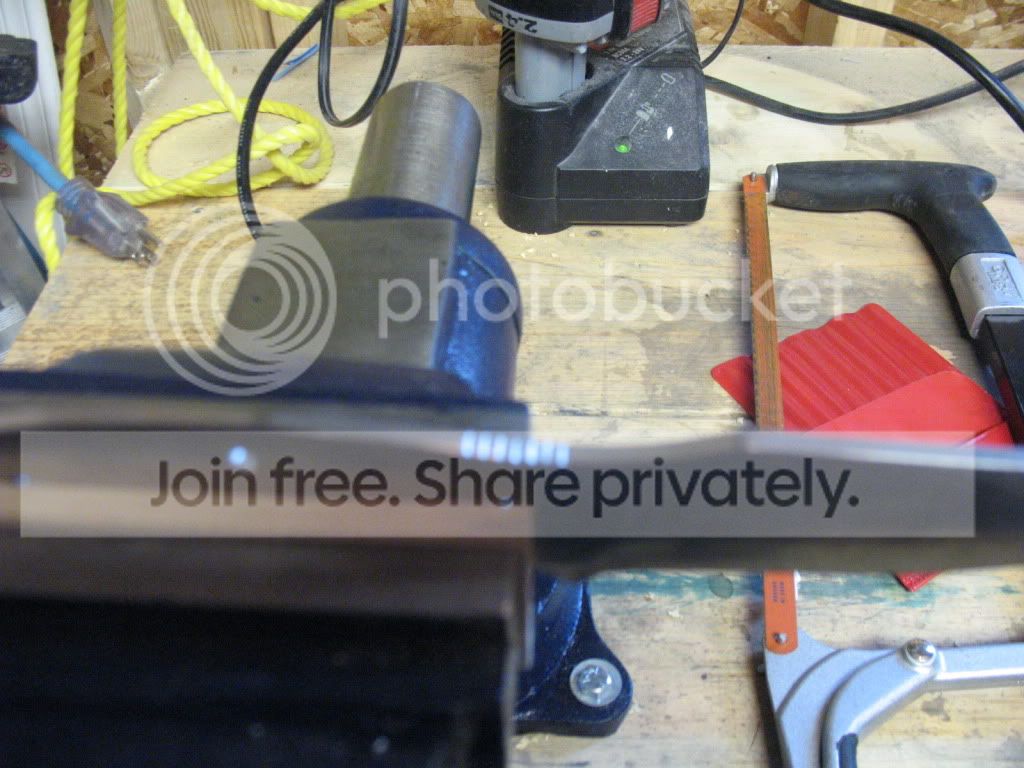

Here's a few pics of the process;
Steel is 1/8'' 8660 heat treated by Rob Ridley from Alberta (Knifemaker.ca)
Oal is 9'' with cutting length of 4.375''
Full convex grind

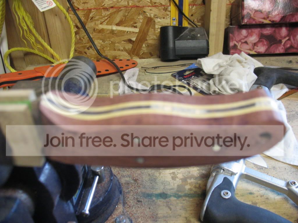

Handle is Bubinga over Yellowheart

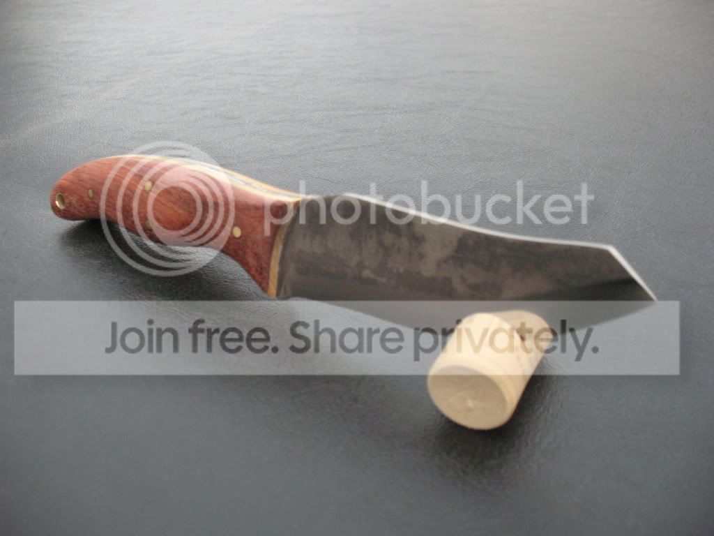

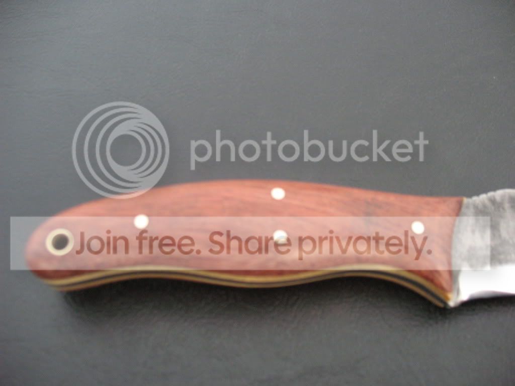

Now, I have one question for you pros; the wood is not stabilized, is there something you would recommend to seal it?
You comments ar welcome (good of bad :thumbup:)
That looks very cool. I like the two-tone wood handle, a lot!
I'm not a pro by any means, but I have made a number of wood-handled knives, so I have a little experience. First, stay away from polyurethane. It makes a pretty, shiny finish, but whenever I've used it, it eventually flakes away and looks like crap.
I'm very fond of tung oil. I used to use "tung oil finish", which does okay, but I recently found pure tung oil at Woodcraft, and it's turning out to be an even nicer finish IMO. It is easy to apply, looks like it penetrates fairly well, and gives the wood a nice satin finish.
Of course, no finish is going to do much good for long if the knife is kept sopping wet, and any wood handle will get wear spots and dull areas after enough use. But a good penetrating oil-based finish ought to be a definite consideration on your list of finishes.

Don't sweat your handle too much...since it's not stabilized, it will move a little bit anyway, no matter which kind of finish you apply.

I love the knife.The shape is useful and good looking.I may even swipe the design.:eek:Slightly modified of course.:DI like teak oil for finishing.You made a beauty for a first knife for sure!Congrats!

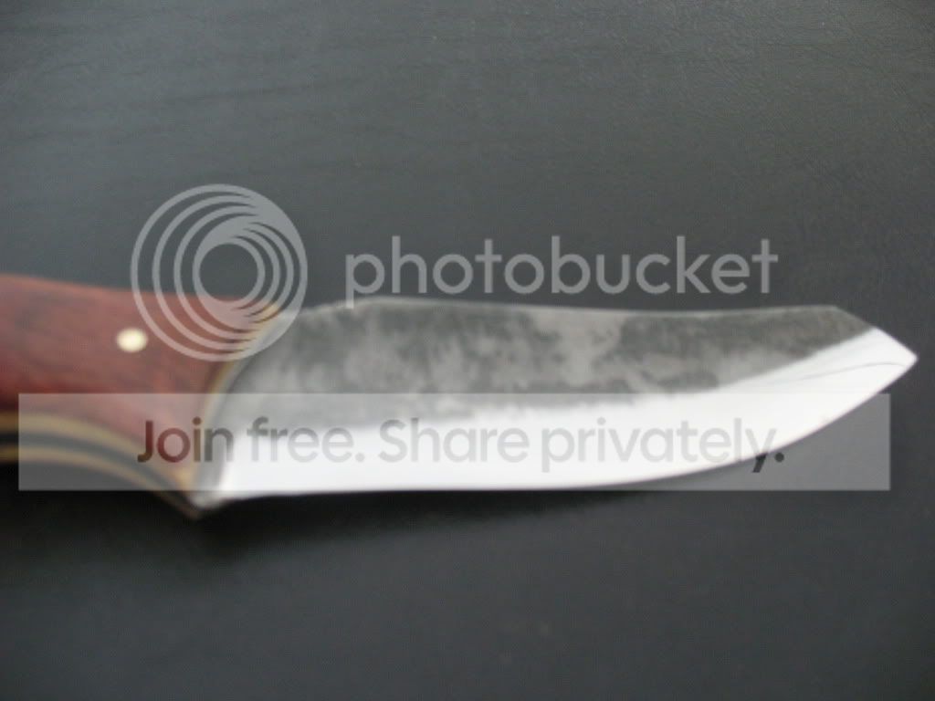

How did you make the bevel? Is that a mustard finish on the blade?

Well done for a first knife indeed. The handle shaping is nicely rounded, not blockish like many new makers start with (including myself here). Tung oil works good but nothing will "stabilize" the wood as it's been said before. Many thin coats with fine sanding and a final light buff will produce a good enough finish for your knives until you feel the need to move to stabilized woods (if you ever do).

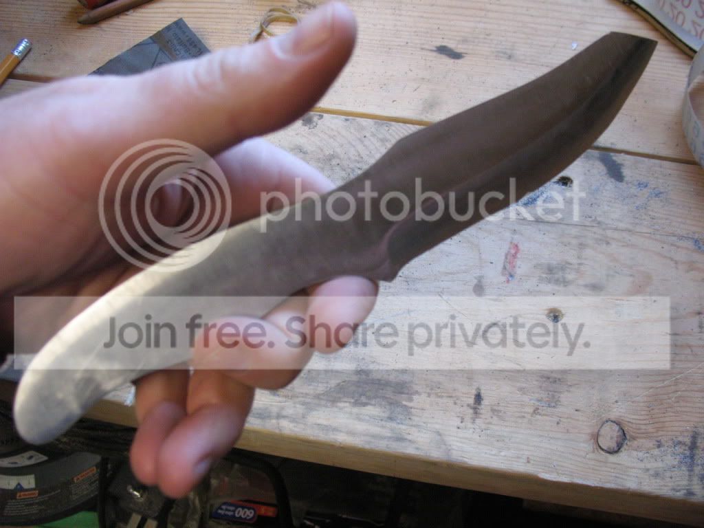

I made the bevels with a file first right down to the center and then I ground it with my belt sander/grinder (Lee Valley 1''x42'') on the slack part of the belt. It's hard to see from the pictures, (yet I'm such a good photogragher) :rolleyes: But it's actually completed convexed from spine to edge but after the heat treat I decided to leave the scale for a more rustic look.

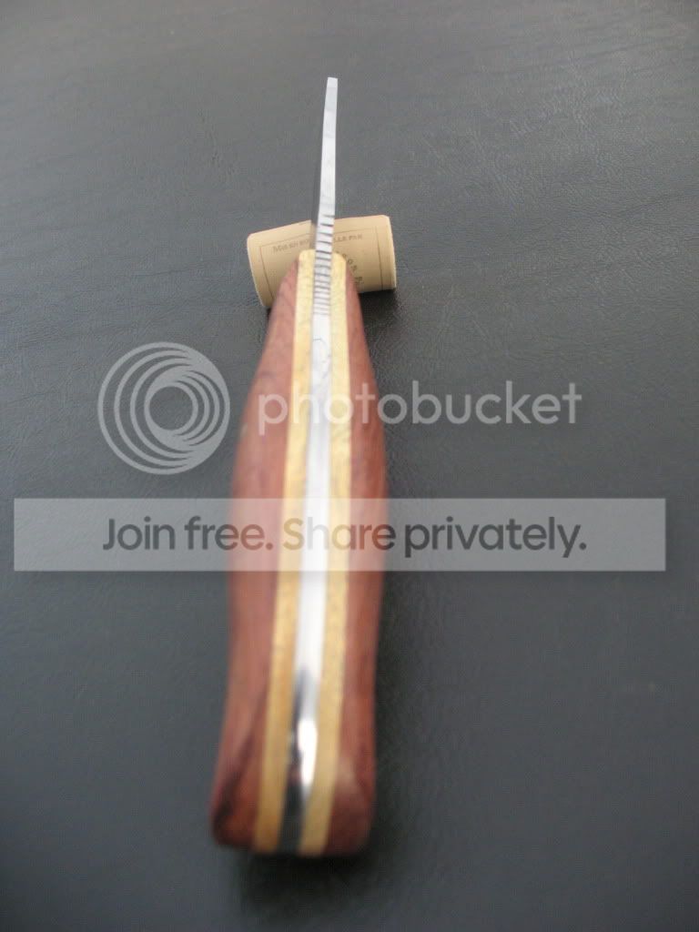

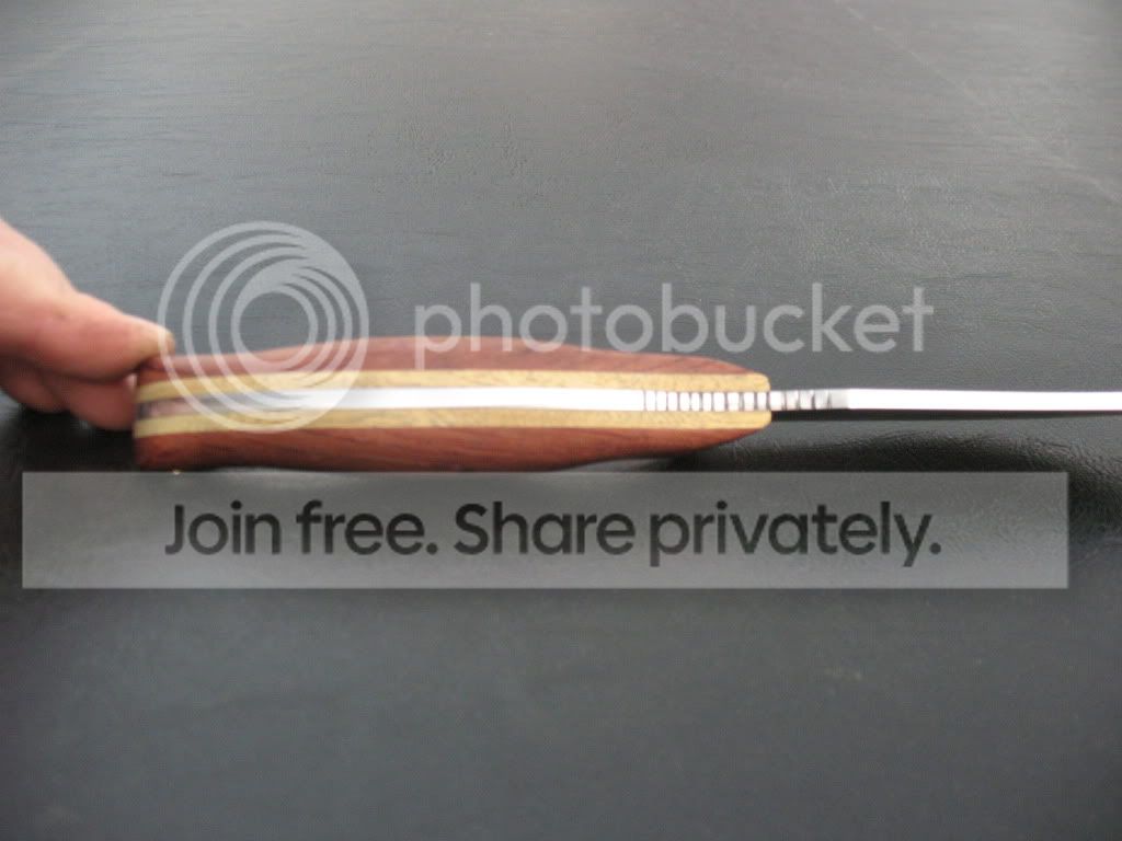

Cool! The only thing I'd really pick on is the jimping. One of those things that stand out if you don't get it right. Take your time to get it even and parallel. Not that I'm am expert I'm any respect. I'm a big knife noob too.
How did you arrive at the shape? Looks like a nice slicer.
Yeah I know, I should've applied myself more on the jimping. It was just done by eye.
I had this shape in my head for a long time and decided to make a mock up on a 1/4'' mdf and I really loved it so I decided to bring the plan to life.

The ''revese tanto'' was inspired from my Benchmade Rift which I once used to gut a deer and surprised me alot. I also think it makes the tip much stronger.
I am a little late to the handle finish party, but I have used Pure Tung Oil on most of my handles so far, even putting a coat or two on stabilized handles to seal up the pours and Micarta to bring out the textures.
The knife I am finishing up right now I went a different route and gave Tru Oil a try. It dries fast, seems to give a hard finish, and buffs out to a nice satin finish by hand. It doesn't seem to give the depth that Tung Oil does, but still a nice finish all the same.
