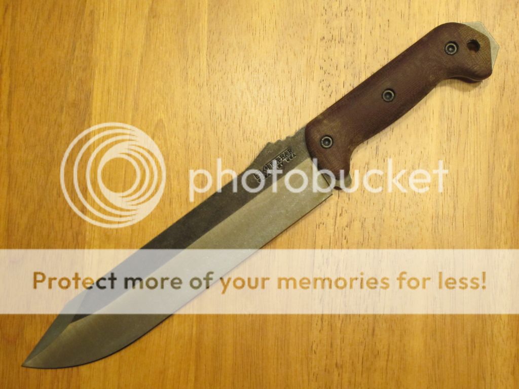

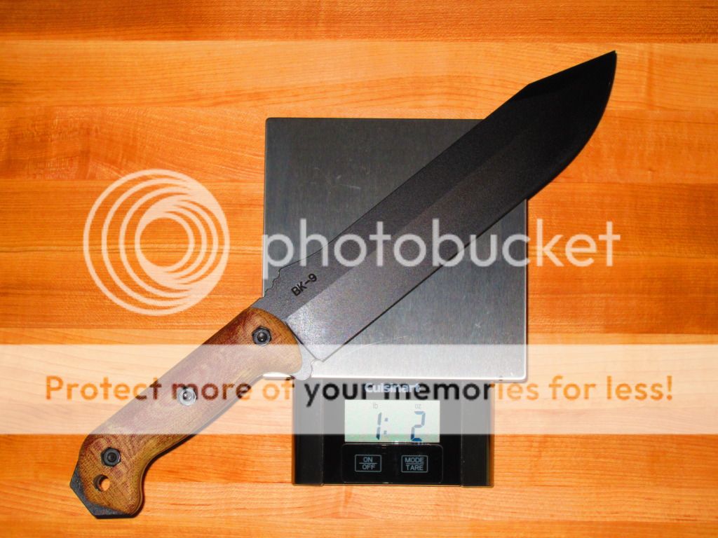

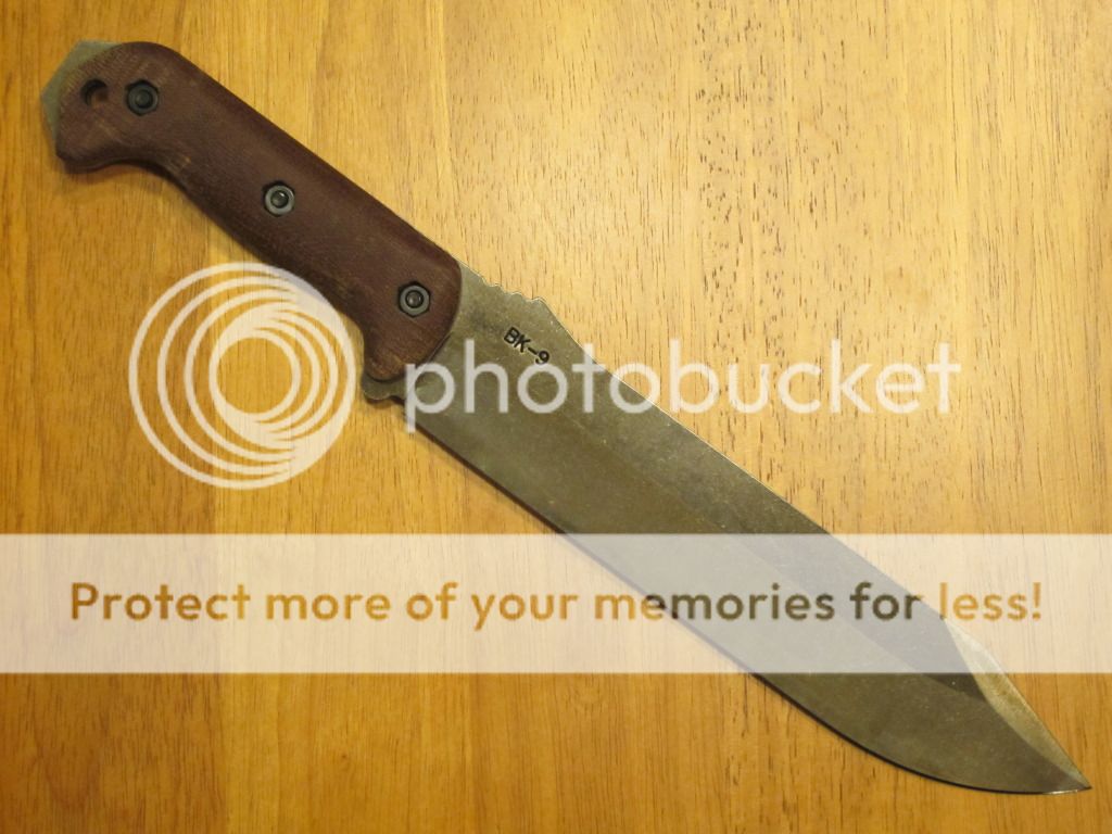

Okay, since I've been seeing the mods being done to these Becker BK-9s I thought I'd follow suit. Just a simple Klean Stripper which is all for now.
Right before the spray on.
The sprayed on Klean Stripper.
Becker BK-9 "in the white" so to speak.
With the micarta scales on.
Say, if I wanted to "polish" the blade up a tad bit, what grit should I start off with? Do you sand/polish first then touch up or sharpen the blade afterwards?
I started with 180. Then 400, 600, and 1500. Rubbed down with Mother's mag polish. Turned out really nice, but if I could do it all over again I would start with a more coarse grit (100?) and then find some 1000 to go between 600 and 1500.
The most important thing is to make sure all the tooling marks are gone before you continue on with finer grits. And to make sure you sand off all of the previous grit marks before going finer.
A buffing wheel would be nice to keep it touched up after polished, but a quick wipe down is probably fine. I'd definately wait to sharpen until your through sanding. You're bound to beat up the edge while sanding.
If you want a real polish it's gonna take a little while. Especially if you're hand sanding like I did. The end result is worth it in my opinion.
That 9 looks very nice by the way.

Thanks for the quick run down! So you'd probably suggest starting out with 100 grit? True I don't have a sanding/buffing wheel just, sanding/polishing by hand and I have to agree with you that the end result can be very satisfying. Yes, buying out time is quite challenging. Thank you again!
Awesome! Now how long did that take you? Was it all by hand?
Yes, all by hand.
How long did it take?......It took a while.
I spent a few hours with the coarse grits and then rubbed it down with the fine whenever I found spare time.
If I had to guess......maybe 4-6 hrs total?
I think I could do it quicker now that I've done it once.
Well, we'll see. I'm actually working on something now.
I'll be sure to do an official write up and post pics upon completion.
Yes, all by hand.
Four to six hours give or take I'm guessing. I'll have to make a project out of mine very soon then. Thanks and looking forward to your next!
