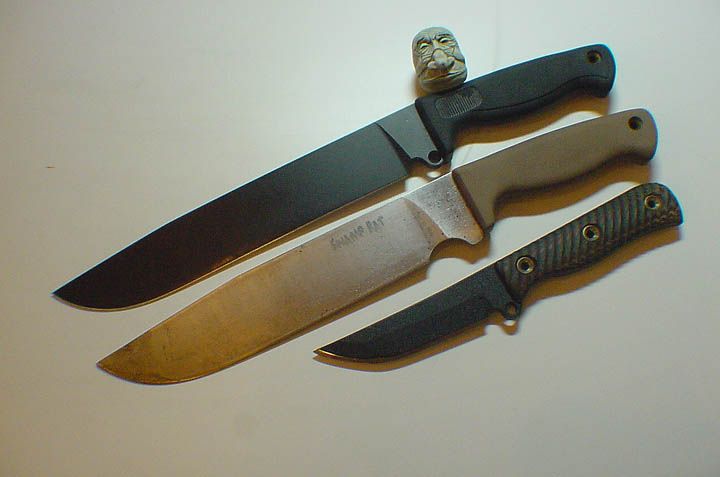

After much of study ;), research and questioning.
Plus various e-mail conversations with Eric . . . my first Rat arrived coupla days ago. (The bad news is I grabbed a coupla more Busse's along the way ;))
It's a user with charactor. . .
:D
Questions:
How many of this Satin Battle Rat actuallly made?
Is it of D2?
Nice set you have there. I can see the family resemblance with that Basic9. I could be wrong, but I think it is the same great SR101 that they use in all the big RAT's, only satin finished.
You have a formidable set of knives that would not be afraid to tackle anything you throw at them.
Cerberus :cool:
Santi,
Congrats on some great looking knives.
The Battle Rat is one of the special run of Satin Battle Rat's, if I remember correctly less than 200 were made. It is made of SR101 and should serve you well. I'd keep it oiled when not in use to help reduce any rust since it is not stainless.

Now, can anyone tell me how to remove the stain from a banana tree out of the blade? :confused:
Those can be a real pain. Is the stain "raised" over the general surface or is it discolored steel. I've found that bananna tree juice when dried on a blade can be unbelivably stubborn to remove. If the steel is just discolored skip to the second part of what I'm about to write.
To remove the film just scrub it with an SOS/brillo pad and some wd40 or mild detergent. Once you get the film off it's usually just a simple matter of some fine steel wool, metal polish, and elbow grease to get natural colored steel back.
I wouldn't bother polishing it too much though, it's uncoated carbon steel on the battle rat, and it'll get stained a little every time you use it. Just keep it lightly oiled while in storage and polish off any surface rust before it has a chance to get worse. Clean any sort of organic material(blood/meat/plant goo) as early as possible, because it can trap water/corrosives under the gunk. Let it patina naturally otherwise. If it's used fairly often maintenence is less necessary because every time you cut something fiberous like wood or rope the blade gets burnished which removes most surface corrosion as you work.

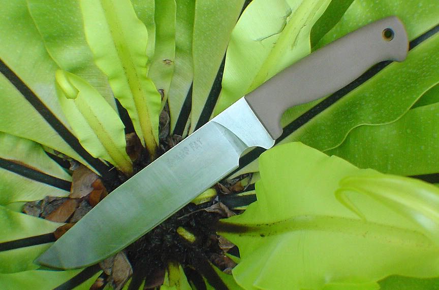

Few rounds of metal polishing and the Satin is now in much better looking . . .
