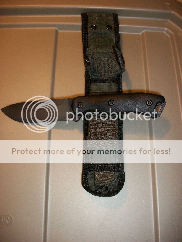

Finally stripped my 16!

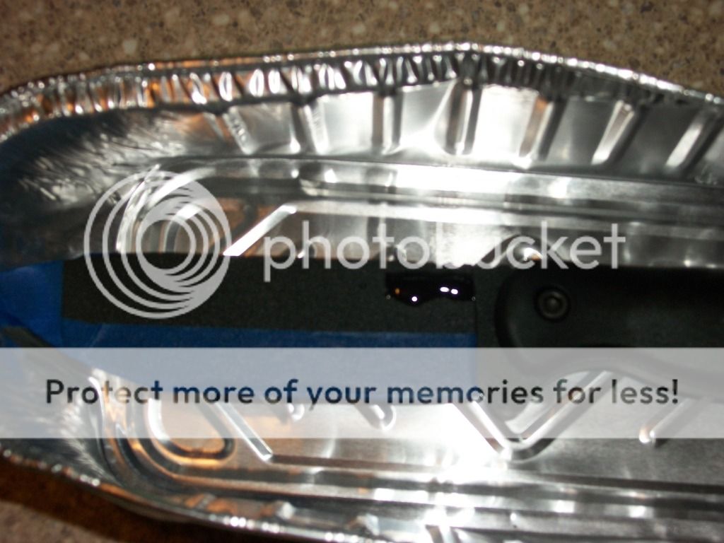

Then I stripped.....

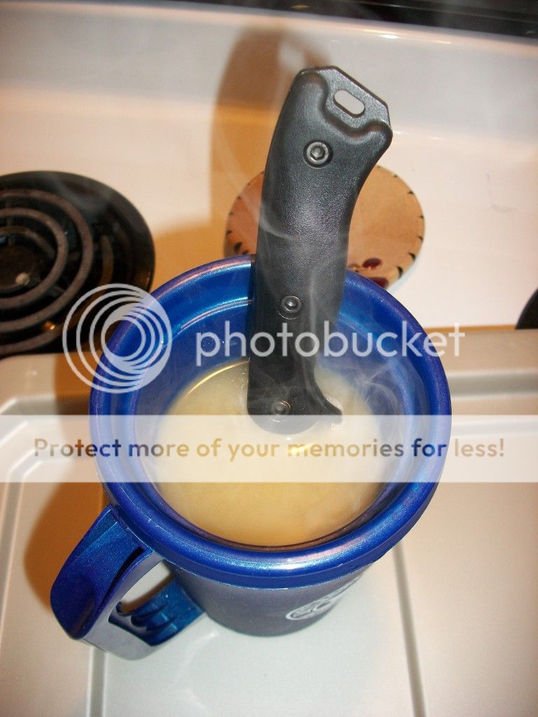

Then I dunked...
Then I was done......in the downtime, I also dyed my sheath green!

I heated the vinegar up in the microwave for about a minute or so and then left the knife in for about 2 minutes. Didn't take very long at all.
Nice job. How long did ya leave the etchant on ?
I think I ended up doing three 1 hour coats on each side. I couldn't find the right allen wrench to take the blades off and didn't want to immerse the handles althought I'm not sure if it would have hurt them or not. I think it ended up being a 10 hour process between etching and stripping.

oh and thanks for the tip lowery on putting the vinegar in the microwave it speeds things up much nicer.
