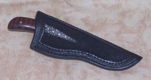

wow, great sheaths and holsters, wish i was making knives when i was stationed there at Patrick AFB bout 8 years ago. I really appreciate the info. Seeing as your obviously the sheath man i thought i'd ask about any advice or tips for doing a concealex or kydex core and stingray outer. Any thoughts?
lol, So true John ol 'buddy.Kevin I don't work with Kydex, but the technique is not dissimilar from leather in that respect.Basically make your Kydex core and apply your adhesive to the rayskin and glue up, trim up at the sander and attach your eyelets.Rayskin is tough to cut, so be prepared and finish your edges with black dye then buff.

well the kydex part is a request, and from what i've read rayskin is some pretty tough stuff also, i as a rule prefer leather as well, but this is for my brother in law, who has done so much for us. he likes more modern stuff, but i figured i would throw in a little touch o meself ya know!? also add some class to the whole thing.
I'm not a big fan of kydex either, though it does have it's uses and is a popular material.It actually looks pretty good covered in rayskin. I have seen it on pieces made by Greg Lightfoot and the results were quite attractive, and probably tough as hell to boot!

Paul, well other than catching your own most hides are dyed.Some snakes and such like rattlers come undyed and you could probably special order some undyed.
When doing inlays, your exotic is glued to your inner liner (with or without padding ). Then a "window" is cutout of the outer piece.I burnish,and dye the edge of the cutout.Then attach the outer piece and and continue with assembly.when wet molding with inlays,I use a sponge to apply water on the inside and outside of the sheath, and try to keep water away from the inlay.Form to the knife and dye as normal.Dave:)

You can start with pre-dyed leather too, but the edges still need to be finished after cutting.Second , get rid of the Eco-flow, it's crap dye.Use Fiebings oil dye.I dye all the surfaces inside and out, as raw leather showing looks bad and half done.It's just like doing a knife,it's all in the details.As far as dyeing near the inlay I use a small sable brush, or Q-tip. And don't forget you need to put a sealer over your dye such as Leather Sheen, tan-kote, or bag-kote.Dave:)
