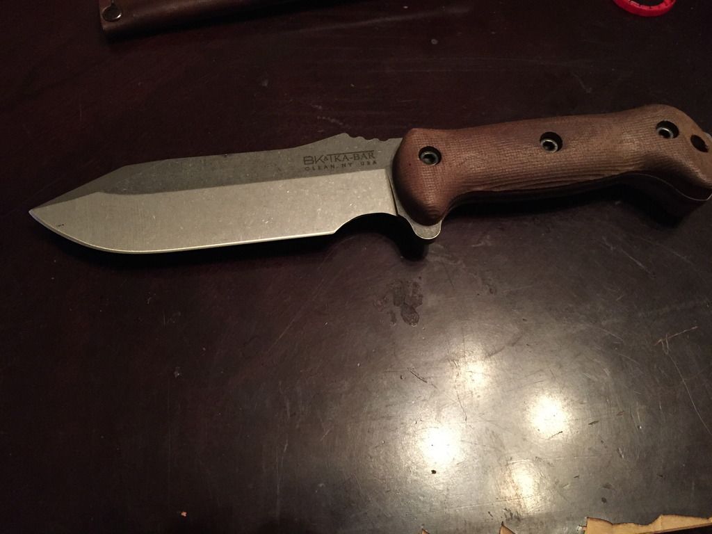

I've seen a few bk2 pictures where there owner has added a finger choil, some done very slightly while others a very pronounced choil. I've been thinking about adding one to my bk2 that I've been tinkering with lately, to allow me to choke up on it more for finer tasks. (Which since reprofiling the blade it really excels at now).
My question is for those of you who have done this have you found it to be worth it? If so Should I go full Finger choil or just a slight indent? Also what did you find to be the easiest method for doing it? I was considering just using a dremel with grinding wheel.
Thanks.
I've used a belt sander and a worksharp to add choils. Worksharp worked best. I did a full choil on a bk10. And I loved the results but in the end I wish I would have just made a slight indent.
Here is a photo. it might be a little harder for you, the BK2 is much thicker then the BK10.
I've thinned the knife out a lil bit working toward a full convex, haven't reached it entirely yet thou. How long did it take you to grind away that much steel using the work sharp? I have the Ken onion and hadn't thought about using it for a choil.
Not long at all! I was very impressed by the worksharp. I was only using the regular, not the ken onion. but I used the heavy grit and it worked wonderful. smoothed it out with the finer grits.
Hmmm..May try that then before going to the dremel. Guess I'll start out with a slight choil first and see how it feels, can always make it a full choil later if I don't like it...Thanks
just keep the blade cool… if it ever gets too hot to touch then cool it off in some water and keep going.

I have 2 bk2's one is pretty much factory other than being stripped. The other one I've been tweaking the blade, and if you compare the 2 in the picture you can see I've removed a good bit of steel from it. Making it noticeably lighter and performs way different the normal bk2. Im going to eventually fully convex it, but as I'm doing it by hand this is its current configuration until I'm motivated for more sanding.
It's still a robust heavy duty blade, but now it also performs like a Bushcraft knife and glides thru wood with ease. I was just thinking that adding the choil would give me more control when doing finer tasks while also adding a bit of comfort as well. It seems like it would feel good when I choke all the way up, but due to the cutting edge I can't truly tell. Which is why I wanted to hear from those who have done it.
