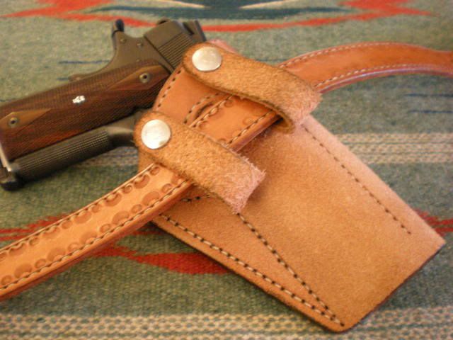

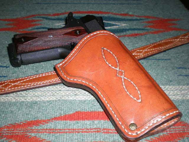

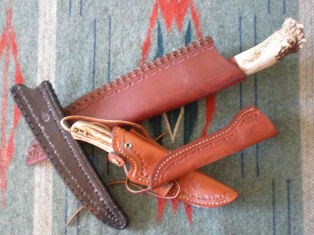

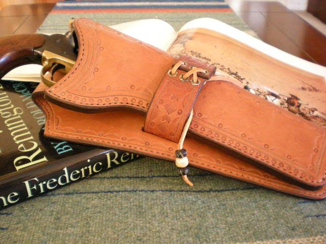

Fiebings is the standard alcohol based stain. It looks good but it should be sealed (kind of like good shoes). You can apply an acrylic resolene (also by Fiebings). For an oil finish I made my own brew which was
Neatsfoot oil
leather balm
some bees wax
and bear grease
You have to play with mixing these to achieve the results that you want, how long to inmerse the finished sheath in the solution or if you just want to brush on the hot solution, for example on laminated sheaths and holsters you can soak a little longer than on single ply leather. I would allow to dry for a day or so and the finish the edge with beeswax ot Edge Kote and the go over the whole thing with Tan Kote, and the a light shining with neutral shoe polish. Here are some pics
Shike
