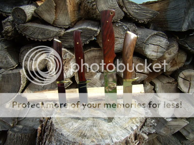

All of these have tungoil finish on them. The one on the right is walnut, two in the middle are cocobolo, and the one on the left is king wood.
Mike
