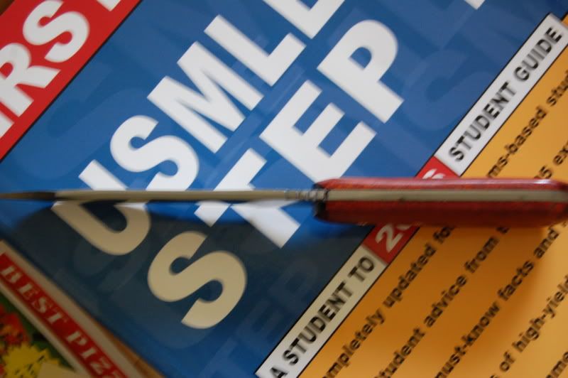

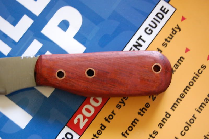

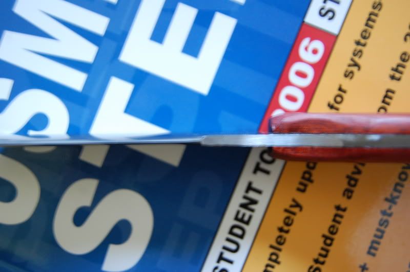

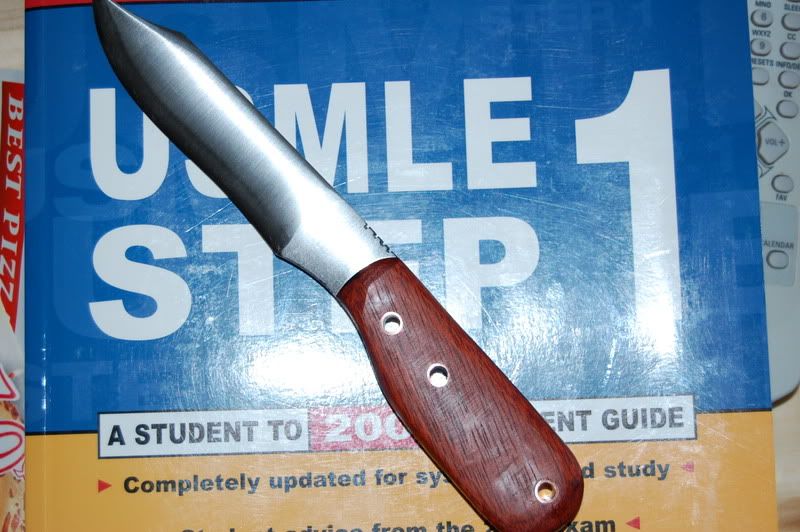

Finished my sheath knife.
Apr 3, 2004
3,536
58-60 RC 1095, triple quenched with dry ice. Scales are bloodwood, hollow pins of copper tubing. 8.25" overall, 4" cutting edge, convexed.
What say the High Priests of Folksy? :)

Thats one heck of a fine lookin' knife you made yourself there. :thumbup:
Now you need a folksy leather sheath.

This one here is very impressive!. And maybe I missed it, so if so pardon my ignorance, did you use a kit for this one or is she made from scratch?

Straight up, no kit. I started with bar stock, a block of bloodwood and a piece of copper tubing. Some time with the belt sander, a drill press and a Dremel led to the above. :)

All it really needs is some buffing. My finest belt was a 120, and I'm planning on going up to 800-1000.
