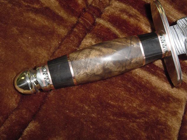

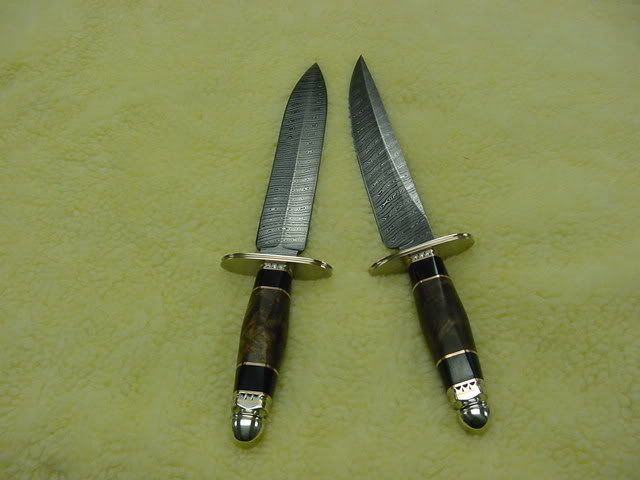

OK guys this is my first post to the customs.
Let's hear your comments
9"X 11/2" 1084 and 15N20 blades
Copper and Nickel Silver hardware
English Walnut and Buffalo Horn

I love the blades. The steel looks amazing, the grinds are classics and crisp. All and all, it looks like a pair of blades coming out of D'Holder's shop. I'd love to see more, detailed pics of
There are several comments I'd make on the handles:
1 - Personally, I am not a fan of flat guards like that, especially when they have this "rounded rectangle" profile. I just find it a tad boring. This is a matter of taste.
2 - Also a matter of taste, but widely shared: I don't like nickel silver. It's not too bothersome as a spacer, but the wide open surfaces on the guards and the pommel will tarnish. I would recommend 416 SS, bronze, or for upscale pieces Argentium silver. Also, your damascus looks very, very good, and that mould make a great fitting material too.
3 - Flush handles with different natural materials are always dangerous because those materials will move, therefore creating sharp "steps". One way to prevent that is to radius each piece, that produces a viuals and tacile transition and prevents the sensation of sharp edges once the materials move.
Good work so far though. The steel looks lovely.

I will agree that there should have been a radius on the natural materials, I'll work on this on the next ones.

I do like the blades and that's coming from a collector that does not comment much on Damascus. Joss, hit it right on with his take on the guards and handle.
A lot of promise here, please keep posting.

i like em both...they look great....the only thing i don't like is the guard....doesn't go with the knife if you ask me....ryan

Mike -- I really like the damascus and the grinds of the blade on the fighter but am probably more critical of the handles than some others would be.

As mentioned, my first impression was "wow, these are really neat". I like the Fighter the best.
After than I then looked at the handles and first impression there is -- too busy, too many pieces and too much bulk to the butts/pommels. then I looked at the guard and find the length of the guard to be too large in relationship to the width of the blade and the handle.
Re the handle, personally, I think it would be improved with a larger piece of the walnut with small pieces of water buffalo if any at all. Small spacers of either N/S or SS (preferable) would help too. the wood is so beautiful, no reason to distract the eye from it. Reduce the size of the pommel as right now, they seem to overwhelm the handle.

Also, a larger photo of the knives presented in BF would be of great help. Do the knives individual in the photograph presentation also. Make more closeups of the components of the knife such as the guard, handle, pommel etc. Avoid using direct flash as seems to be the case in the closeup provided. Do everything you can to give the view as much information as you can. it does not take long but is so much more useful. HTH.

I agree with the other comments regarding the handles. The blades are really nice but I think the handles are a bit too busy and I also don't care for the round pommels.
The patterns in the damascus look great.
