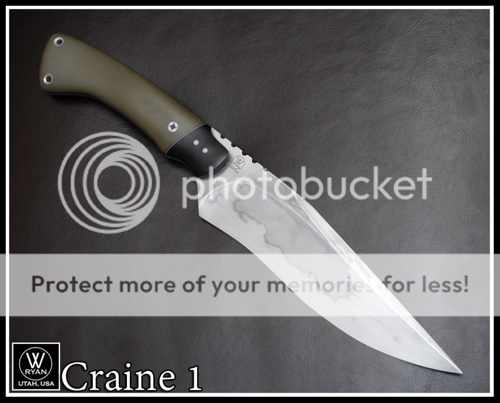

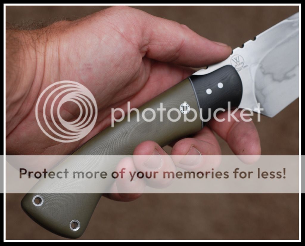

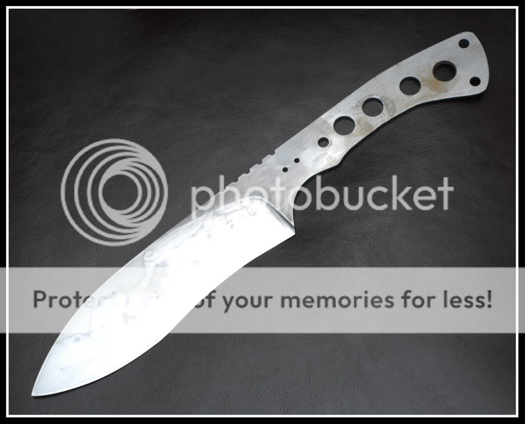

I have been working on this for a while now. I ran into a few snags along the way, luckily I was able to reach out to a few great makers here for some direction. Thanks Mike Q. and Mike T.!
This is #1 of 2 that are on order for this customer. I will attach the start of the other blade which will have matching handle materials.
Craine Camp Whittler (His name for it)

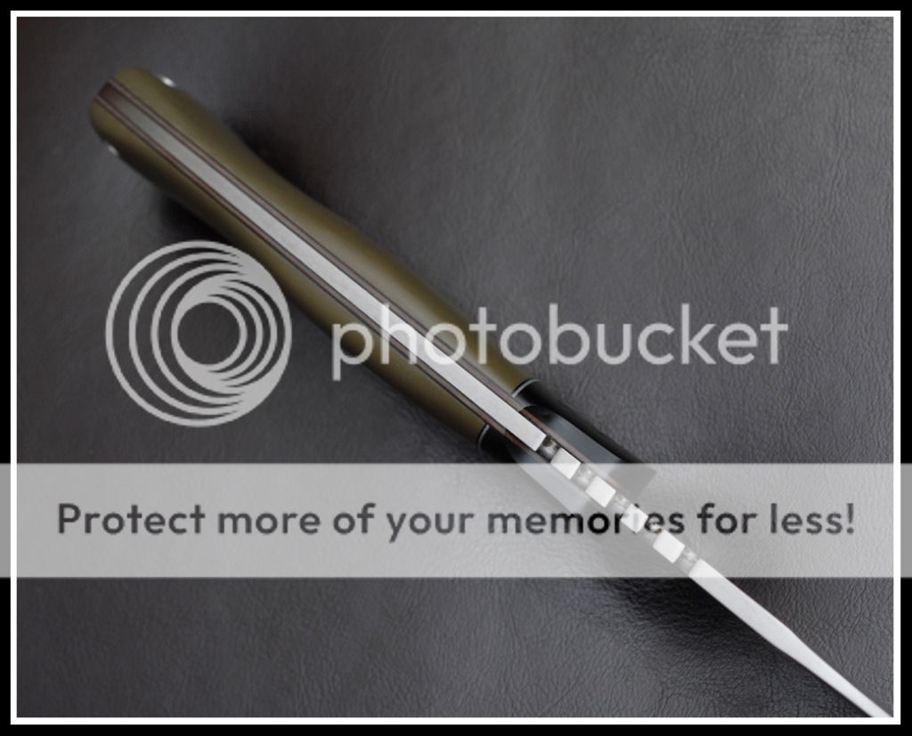

Steel: 3/16" W2
OAL: 14"
Blade: 8"
Handle: OD & Black G10
Misc: Tapered Tang, Hamon, Jimping

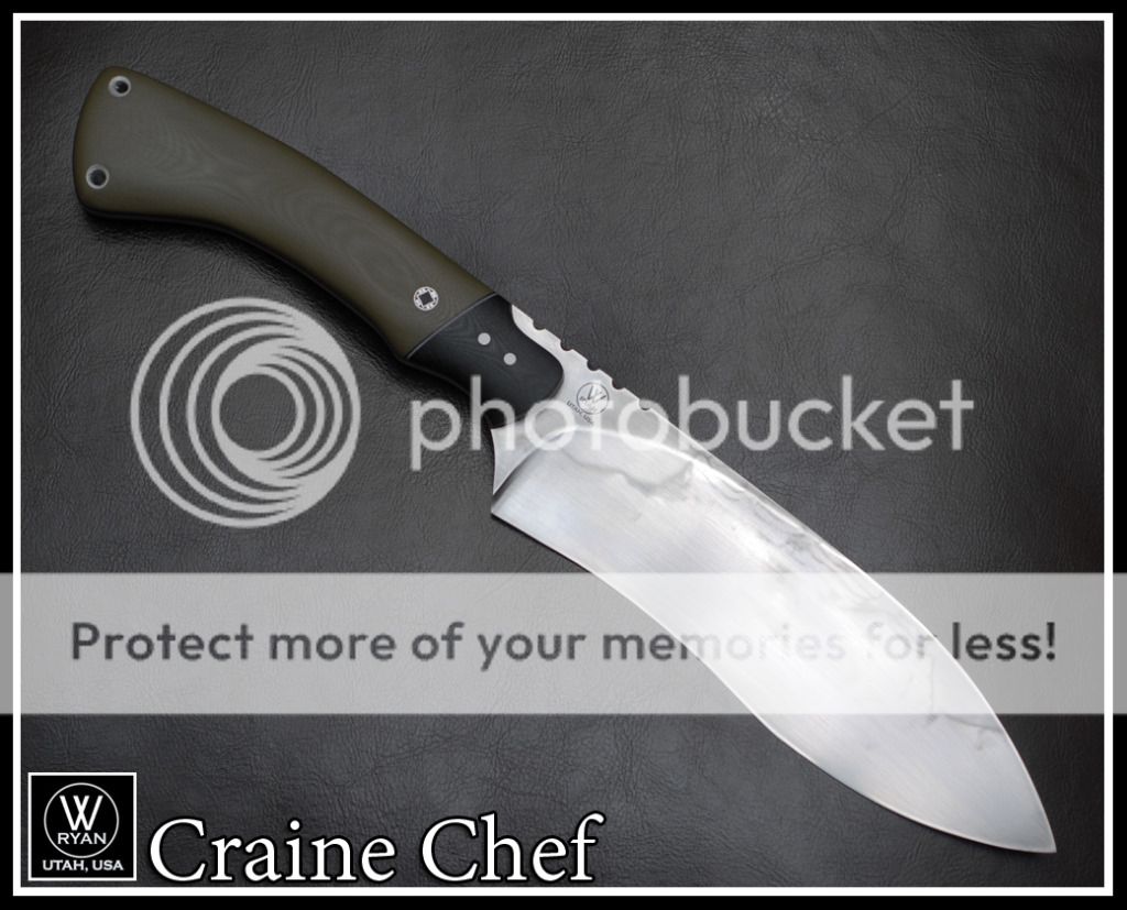

Knife #2 Craine Camp Chef
I will update this thread as I finished up the Camp Chef. Comments and constructive criticism welcomed and encouraged!
... Ryan

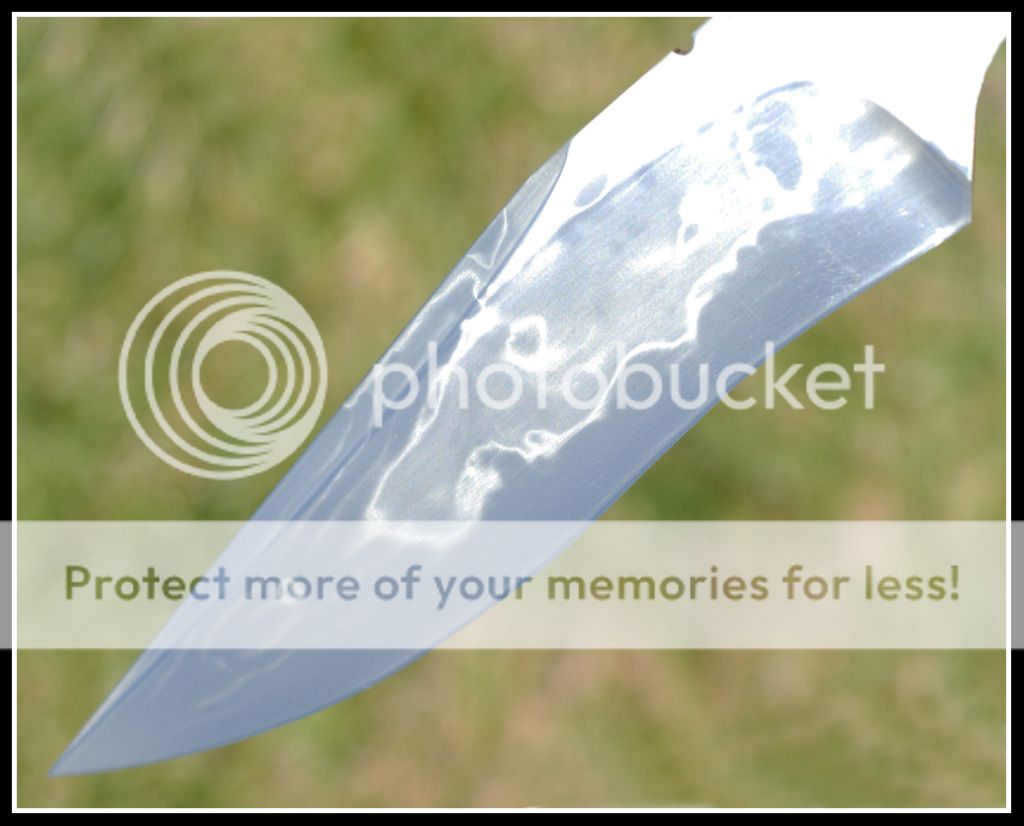

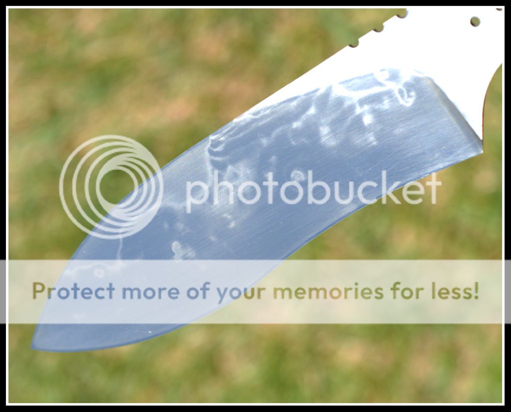

Man, that is way cool, How did you do that wicked finish? It looks like a very well done multi coat hamon, one of the best I have seen!
Nice and clean work!
The hamons have me puzzled trying to figure out your clay layout and the overall process. Interesting ghost lines.

Thanks Everyone for the great comments, just a little history on the challenges I ran into on this blade. In the past I had been using my Propane forge for HT-ing my blades. due to the challenge of a stable soak the forge presented I moved up to a 24" Evenheat Oven. After a bunch of HT's I thought I had Aldo's W2 HT process in my oven Nailed. 3 blades (Re-Profiled and Re-Ground) and 15 Heat Treat attempts on this design later, this was the result. Mike Quesenberry and Mike Turner were a huge help in getting things right.
Unfortunately Stuart I don't have any photos of the Clay treatment that created this Hamon and as you say "Ghost lines". It was similar to the photo below, but much thinner. I was going for only the edge and lightly into the clay reaching critical during the entire soak. I think Grain refinement played a big role in the Ghost lines. Either way I like it and hopefully will be able to replicate it down the road.

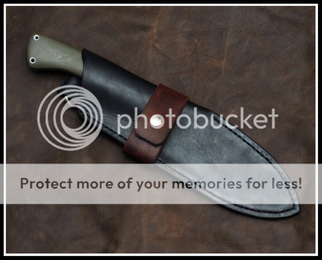

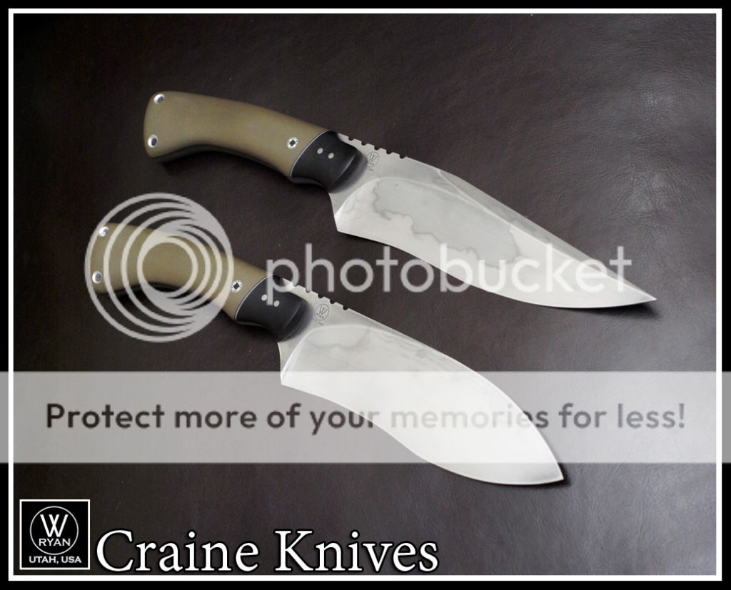

I got Blade #2 Finished up (Craine Camp Chef)

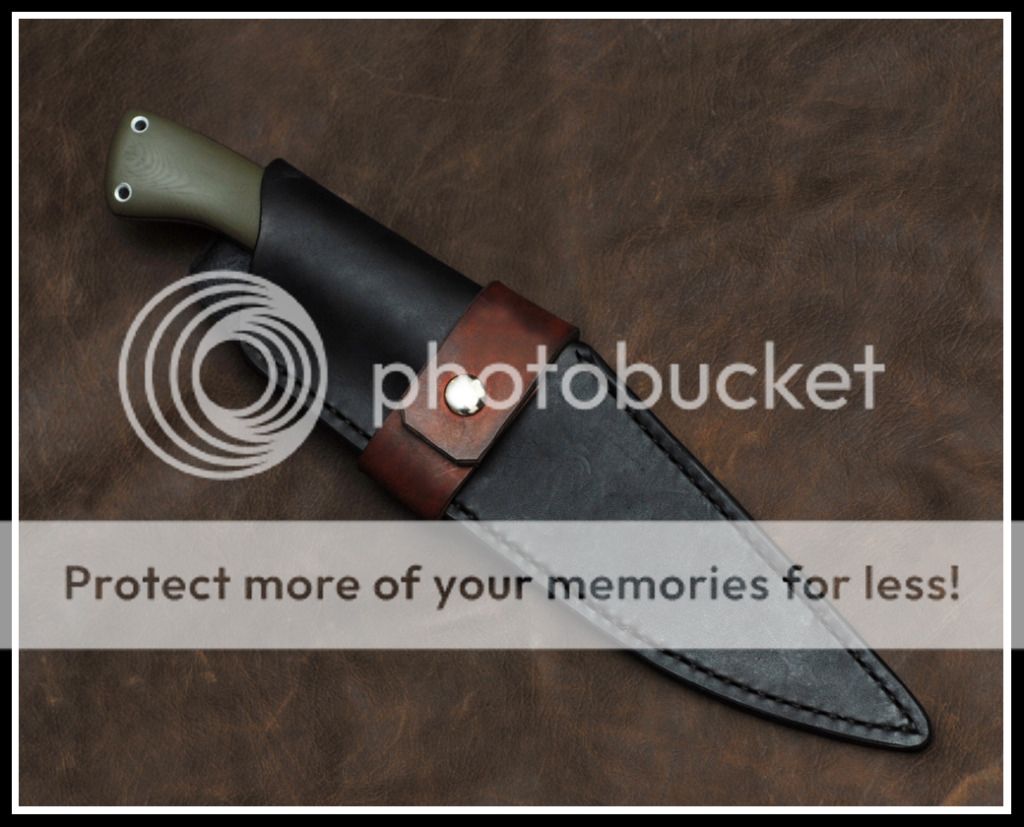

The Sheaths: (Customer also wanted Kydex so that is next)
Both great designs but that first one is all sorts of wicked looking:thumbup:. Great job on the hamons.
Thanks Mike, I really appreciate the help during this build... Small Steps
Agreed both nice but the pointy one really grabs my attention. Nice work Ryan you have been busy.
Really Appreciate that Burton, this one has been in the works for a while. Just trying to keep up!
