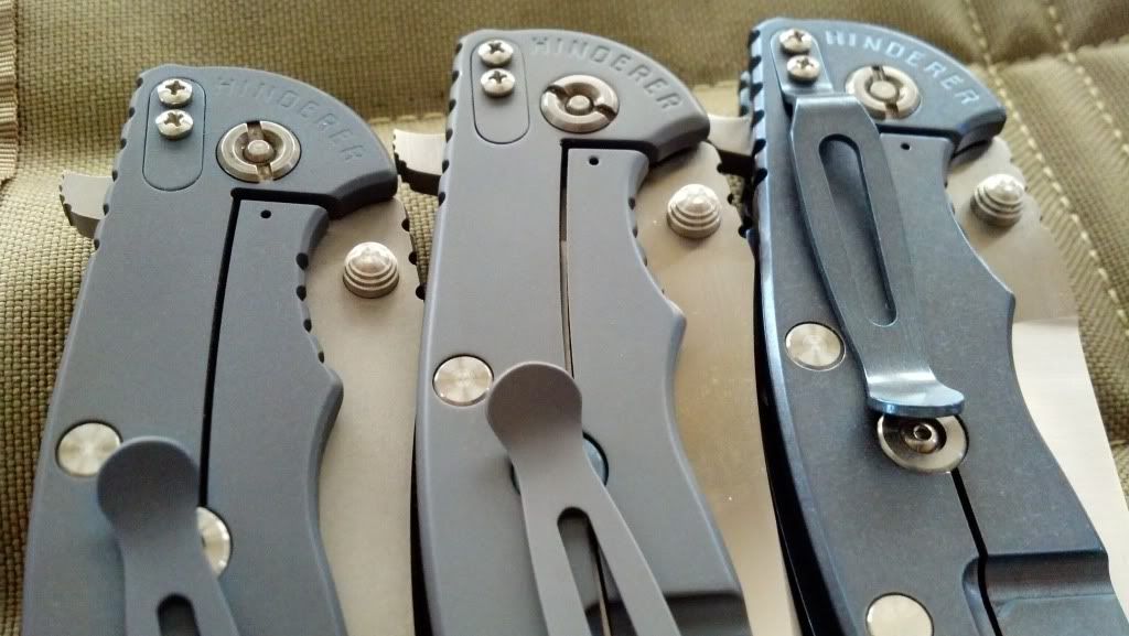

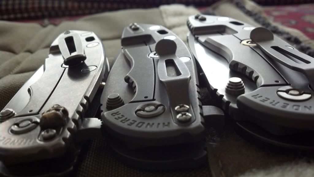

Again...SB on left, BB in middle and SW on right...
Close up of SB top vs. BB bottom...

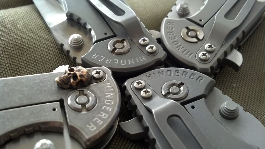

Stonewashed on bottom left...
Working finish on bottom right...
Bead blasted on top right...
Anodized only on top left(no sw,bb,sb, or wf)..

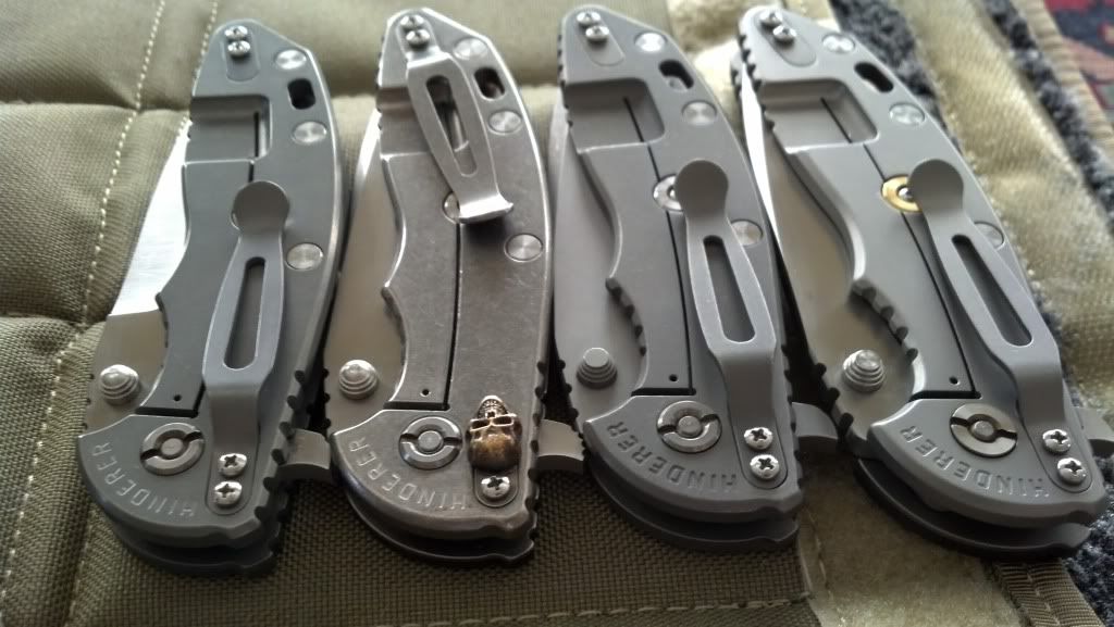

Ano left, SW left middle, WF right middle, BB right...
SW left, WF middle, BB right...

Just trying to help out. I've had quite a few folks pm me in the past asking how one can tell the difference between sand blast and bead blast....between sand blast and working finish....or between stonewash and working finish. A pic is worth a 1,000 words so I thought I would post a few to help out. Tried to capture the glare from an angle also...I do need a better camera! :D
That one that you mentioned is anodized on the top left, it must have started out either stonewashed, bead blasted, sand blasted or working finish. I can't really tell from the pics.
Yeah...my pics are crummy...it is anodized light grey/green. Definitely has not been blasted...might have been lightly stonewashed and the ano hides it quite well...
The easiest way for me to tell if it has the WF is to look inside the jimping & HINDERER engraving, inside the Lowspots like inside jimping it will be a matte sandblasted finish, whereas a plain stonewashed XM will have a shiny machined finish inside the jimping.
