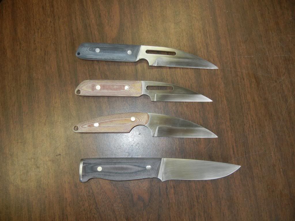

I started a few projects about a year ago, got as far as the heat treating before real life got in the way.
They've all been sitting on my shelf for about six months before I got sick of looking at their poor half done selves.
Went on a flurry this past week to finish them up.
Took a couple pics before sending them off to Richard for his magical edge treatment.
The top pic knives are all 3/16 thick O1; hardened & tempered to around 58RC.
The bottom one is a bushcrafter that I had a bottom flange TIG welded to it which allows it to be used as either a hammer or a nail in a bind.
The rest are just designs I stole, er, I mean created, because I thought looked cool.

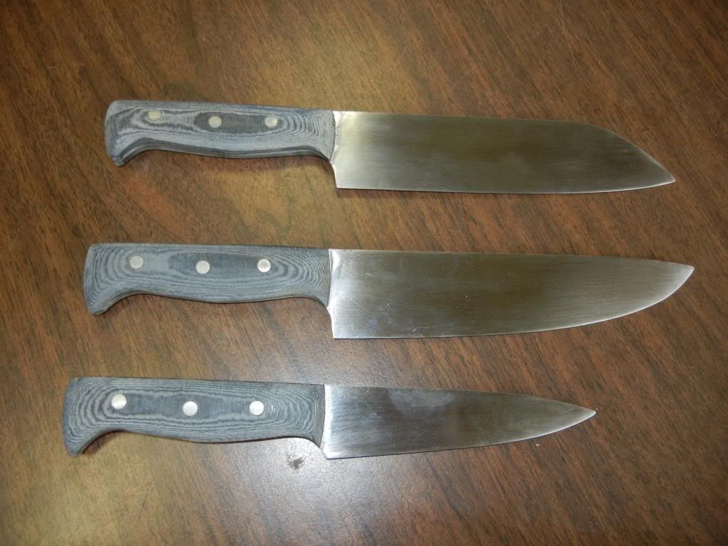

These are a set of kitchen knives I cut from industrial hacksaw blades made out of .100" thick, heat treated M1. I figure if they hold up to cutting 1050 steel, they should do OK on chicken bones.:
[URL=http://s257.photobucket.com/user/Roxtarfab/media/Knife%20Stuff/bunchoknives004_zps275ee517.jpg.html]
[/URL]
