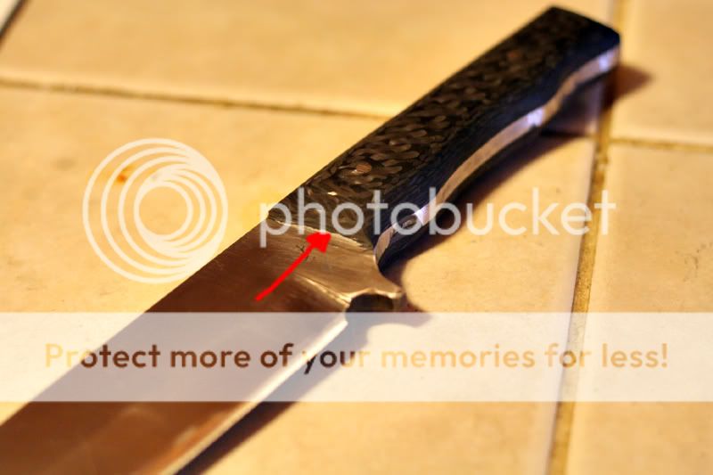

One last slightly related question. I'm using JB weld as my epoxy and I'm finding it very hard to remove the epoxy that squeezes out in front of the scale. How do people get that out?
Someone pointed me to using WD40 on the squeeze out, and it works like a charm. Not only does it remove the excess epoxy, but it also leaves an oily residue that helps prevent anything that happens to get left over from setting up all that well. I was getting residue that would leave ghost like whisps after it evaporated with acetone. I haven't had that issue with WD40 at all. Another problem I had with Qtips was getting little hairs from the cotton stuck in the joint. I now use cut up pieces of t-shirt and haven't had near as much trouble.
Don't know how well it will work with JB Weld. You'll have to let us know.

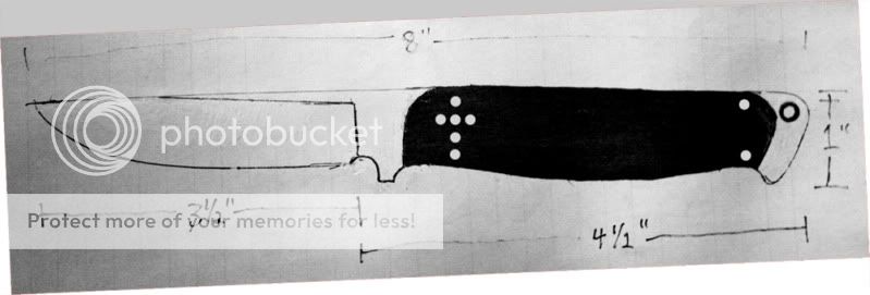

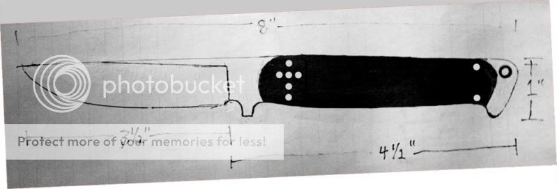

Fantastic ideas guys! I think from here on out I will get a good portion of the scale work done before epoxying. Once I get the bevel scratch problem solved (i asked in another post about it) I think I will be ready for my first real gift knife. From when I started until now I have just been doing test knives to figure stuff out, slowly adding what I've learned to the next knife. I believe my father will be the first one to get an actual working knife from me (hopefully in time for fathers day). He is a very religious person and also a hunter/outdoors man, so this is what I came up with for a design. Let me know what you think!
(1080 steel, 1/8" or maybe 3/16", micarta handle (orange/black), SS pins)
Interesting idea with the cross-pin layout. A suggestion I have would be to go ahead and bring that bottom front corner of the handle scale back a bit instead of leaving it square. Square angles on a knife just really break up the flow. I'd bring it back just a bit, maybe so it more closely matches the rear bottom corner of the handle scale. Also once your knife is actually being shaped, you will be able to get a better feel for the handle shape. For this type of knife, I'd suggest that the handle be no wider from edge to spine than the widest portions of the blade. It appears that way in your drawing, and it's probably just my eyes. Maybe if you increased the depth of your front and rear finger grooves a bit, keeping the gentle flow from groove to belly to groove, it would take away from that effect.
Great design, btw. I'm not trying to criticize it, just pointing out what pops out in my eyes. Remember, there are many eyes in knifemaking, and each has a different preference. Follow what you like.
--nathan

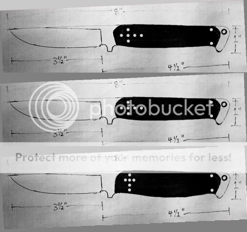

I am very glad you are honest. Since I am just starting out, you more experienced guys honestly have the responsibility of pointing out stuff like that to us noobs. I didn't even notice the square angle that you talked about until you said something, now it sticks out like a sore thumb and definitely needs to match the rear angle. And you are correct that the handle does go below the blade a bit. I have a mocked up blade that i used as a reference for this and thought that it did feel a bit funny in the hand because of that point.
Much better!
Night and day between the two drawings. Good job. The first drawing looked almost pregnant. It looks much more balanced now.
--nathan
I just wanted to add to Nathan's comments that I think the cross would be better displayed if turned counterclockwise 90 degrees (the short part going across the handle, the long part going down the handle) -- assuming your Pop is right handed, looking down at the handle in his hand he would see the cross oriented properly (you could also make it a bit larger that way). Just a thought.
I thought about that too, my only concern is that I don't want dear old dad staring at a upside down cross. Bit of a bad omen. He is right handed though so I guess I'll have to think about it a bit. Thanks for the suggestion!

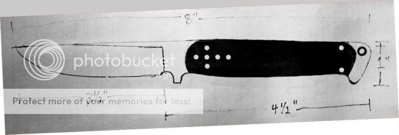

I'm way new here, but I have a couple of thoughts.
Maybe mirror the front and back of the handle to provide a little more symmetry?
I would also only drill 2 of the front pin holes through the tang and only drill the others through the scale. That way you won't leave a possibly weak perforated line across the tang where it could break.
I like the overall profile very much.
Walter
So for the other 4 holes, just epoxy in a small length of the SS rod then without going through the tang? Sounds like wise advice, I just wonder how hard its going to be to epoxy in 8 tiny pieces of SS rod... ;o)
