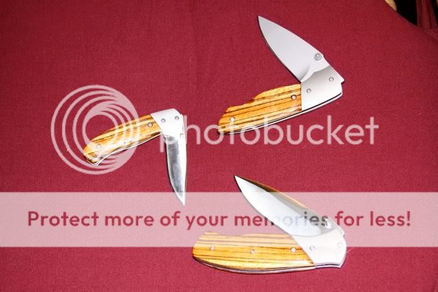

Gentlemen, thank you for your help. Here's a picture of the finished products. I used boiled linseed oil to seal and a clear gloss poly to finish. These knives went to my mom, dad, and brother.
