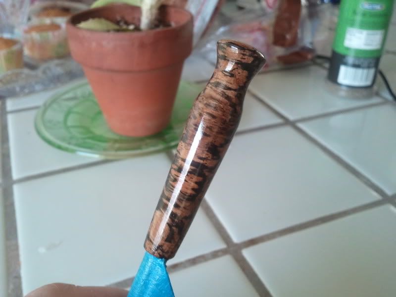

I like tru-oil for the high gloss shine with no buffing. Usually I cut the shine back to a satin finish with #0000 steel wool.
This is tru-oil with no buffing after finishing, and about 15 coats. It can be accelerated with ArmorAll as a catalyst, but you should learn how to best use it normally first. With the catalyst I can apply 8-10 coats a day.

You said earlier that I should wait 8 hours between each coat, how do you get so many coats in so quickly?
What's the best way to apply the try-oil? Should I brush it on or rub it with a rag?
Using Tru-Oil per the standad directions, you should wait 8 hours between coats. I use Armorall (yes, the car shine stuff) as a catalyst to speed up curing. I do recommend becomming familiar with how Tru-Oil behaves normally before attempting to use a catalyst, so you have an idea how it behaves based on temperature, humidity and such.
I apply Tru-Oil with my fingers, it doesn't take much. I pour a small amount into a condiment cup, maybe a tablespoon or so, and use it from there so the bottle doesn't dry out and get a film on the surface. Dip your finger in and rub it in until it soaks up and your finger begins to drag or squeak on the surface. Don't try to cover th whole handle at one shot, it will soak in pretty quick, just work in small areas until the whole thing is covered in one coat. Wipe off any excess. Acetone on a Q-tip will work well to take it off of any pins or the tang.
For an excellent write-up on how to use ArmorAll as a catalyst, do a web search for "Woodstocks amazing stock finish" you should find it.
