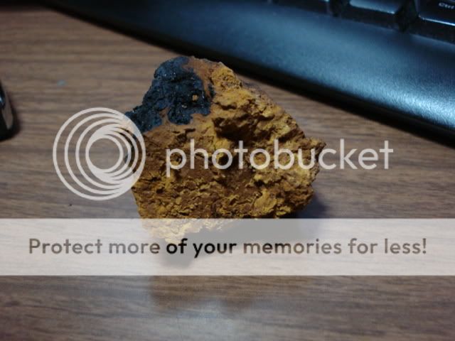

True Tinder fungus:
I took a small slice of the tinder fungus, lit it, and placed it on the top of the Cattail.

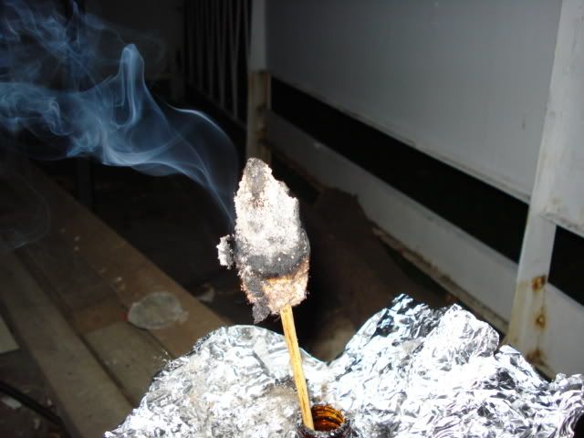

Once I got it going, I took it out to my balcony where it still is. This picture was taken at 8:06 pm (23 minutes ago)
This one at 8:18
8:34 pm.
Note: I am knocking the ash off so the picture will show up better.
Also note that it is moderately breezy out there tonight.
Doc
8:50 pm
I probably should have measured this before I started but it was about 4 - 4-1/2". The breeze will decrease burn time as well as the fact that I am knocking the ash off. The ash would help protect it from the breeze.

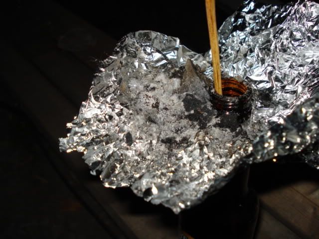

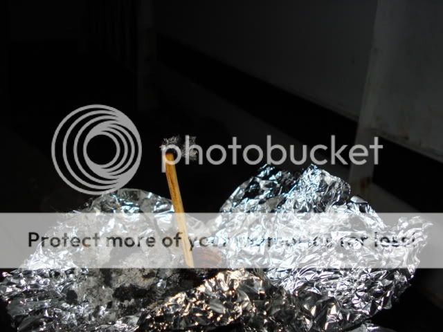

So I went out at 9:08 - all gone!
But wait! What's that I see?

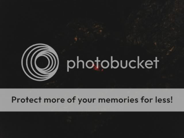

Damn, can't see it because of the flash. Let's try this:
There it is hiding amongst the ashes.
So it burnt for about 1 hour and 6 minutes. It was about 4 - 4-1/2" long. It was moderately windy and I kept knocking the ash off, making it burn faster. I also think there is some variation in burn time between one head and another due to moisture content, genetic makeup?, bug infestation, and who knows what. Anyway, I hope that's what you wanted kgd. I'm sorry it wasn't done in an outdoors setting, but if I put things off..........................
