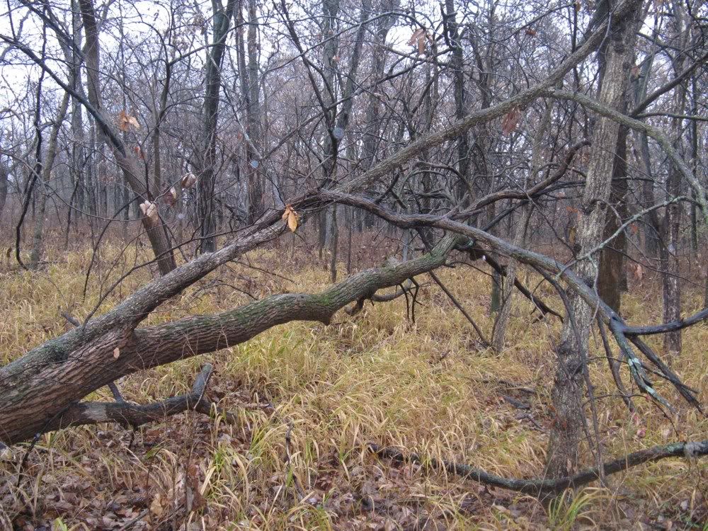

Here is my chosen tree, a hedge, dead and off the ground:

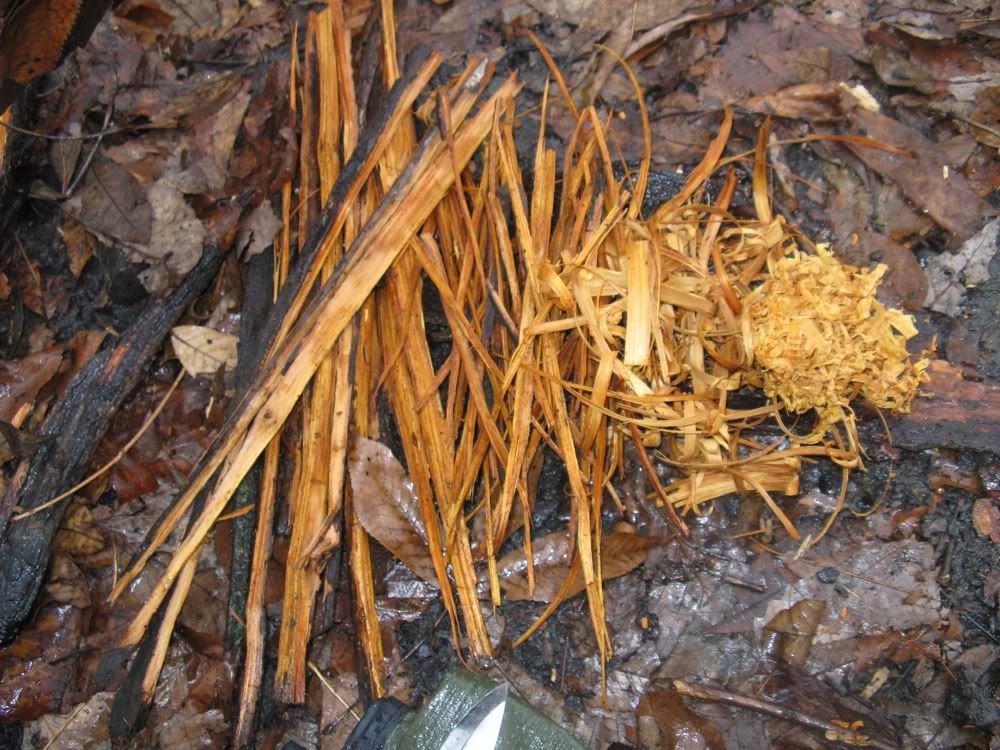

My prep, it was just enough but I should have had much much more:

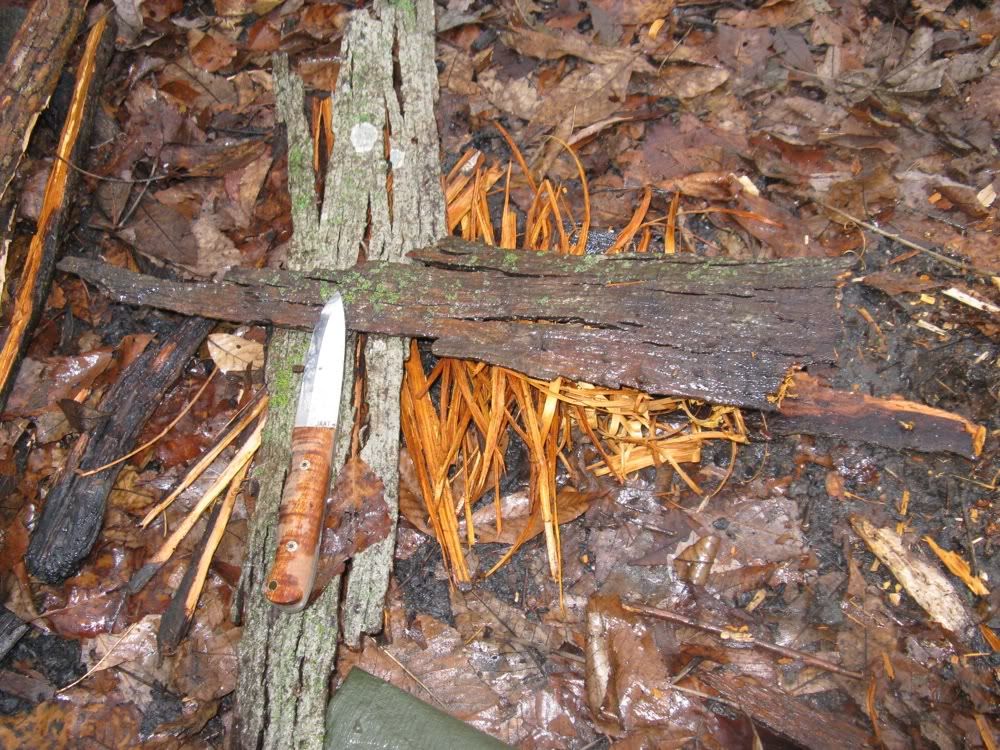

Prep was protected from the falling rain by Hickory bark while I worked (The knife from River Bottom Blades):

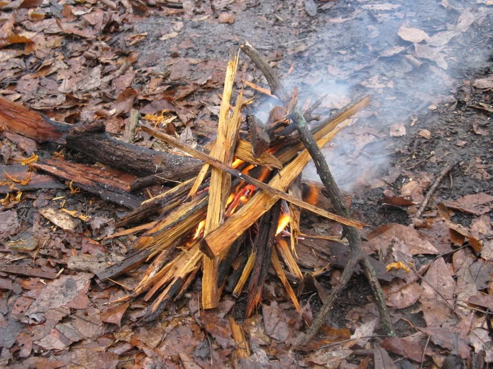

We have fire!

Today I felt good about how I did, I got the fire going first try and it never went out. I still need a lot more practice though. My prep like I said was adequate but would not have left any room for failure so next time I need much more and another piece of Hickory bark for cover would have been helpful. Oh, and making fire in the cold rain while soaking wet makes things much more difficult, this is NOT like making a fire in normal conditions. Go out there and try it, you won't be disappointed with the skills you build. For those that have done it I salute you.
We have fire!
