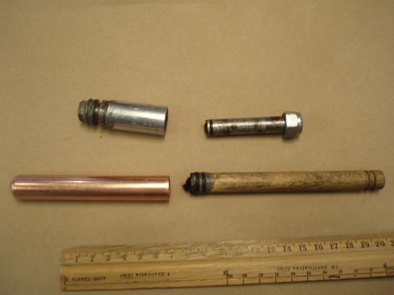

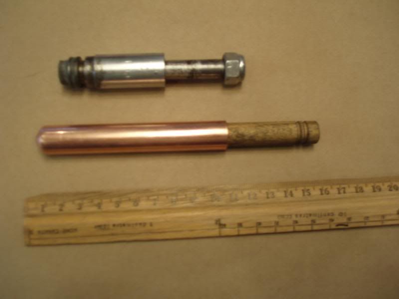

A friend and i have put together a couple firepistons with high hope of success.
Followed instructions on building from a youtube link using a copper stub out
The other one my friend cobbled together from a junked camper jack hydralic cylinder.
Something eluding us on getting a spark
Both have very good compression.In fact when you push in slightly the piston rebounds slightly.
Using char cloth that I made.It takes a spark very well
Some photos
Metric ruler used for scale
Only thing that maybe happening is that we may have made the cup on the end a little too deep.Would that cause ignition failure?

As long as you have a total air seal, I doubt it. But, I could be wrong; I've never built or used one of these.
Also, are you making sure that you are pulling the plunger out immediately?

I have a Wilderness Solutions fire piston and use charcloth. It took me a little bit to get the motion dialed in. I needed to practice giving it a solid hit and pulling it out in one motion. Because of the seal needed I think that if it is not pulled out fast enough the oxygen in the piston runs out really quick and you'll lose the ember. It was definitely frustrating at times but once I got it dialed it's a neat alternative to a firesteel or other methods.
I ended up buying an aluminum one on line. The mod I did was to drill and attach some 3/4 inch wooden balls to both ends. It looks friggin retarded but they allow me to grip it much better when I compress it and pull it apart faster. With good char cloth it will make an ember every use.
