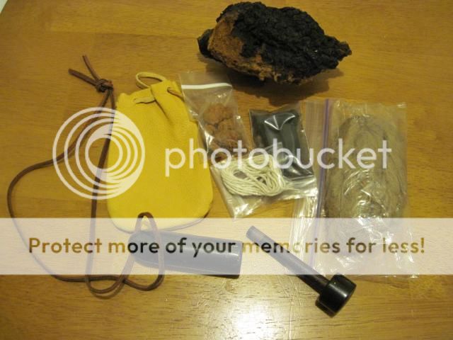

Here is mine.
Fun to play with but for real Firecraft work I pack a Bic, firesteel and matches.

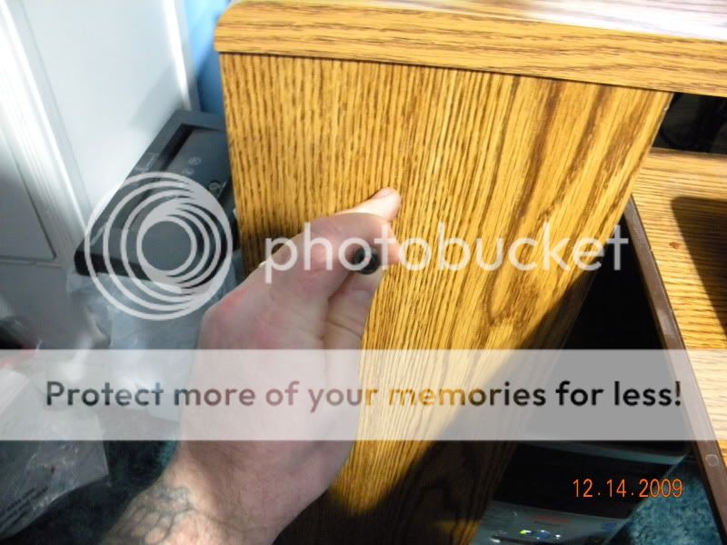

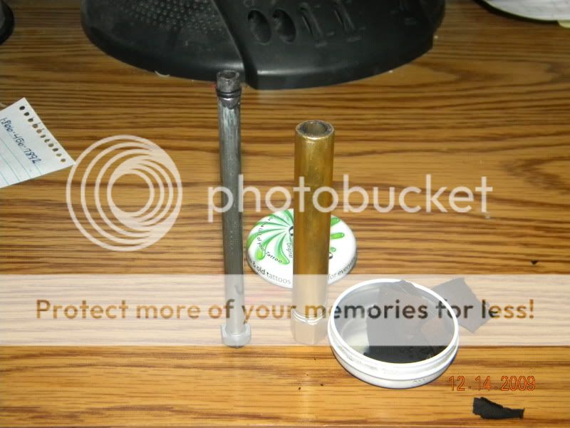

I've built a few. I don't use them as a primary tool, I just wanted to see if I could. Here's one. Another is made of brass tubing.
I've been making them for years on my lathe. They're made from 6061 Aluminum and I use them mostly on backpacking trips to impress people :cool:. It actually kind of works until I start trying to explain the thermodynamic theory behind it, then I'm just uncool...
I've made a couple, and own one from Wilderness Solutions. And i will say that the ones I have made work better for me then the fancy one from Wilderness Solutions.
I made the plunger out of a bolt I had, bought the brass tube and end cap. Cut off the threads of the bolt, drilled out the end for the tender, filed a grove for the o-ring and sealed the brass tube up.
