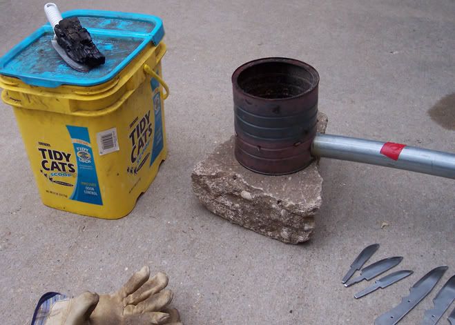

Here are some pictures of a coffee can forge that I use to harden 1080/1084 steel.

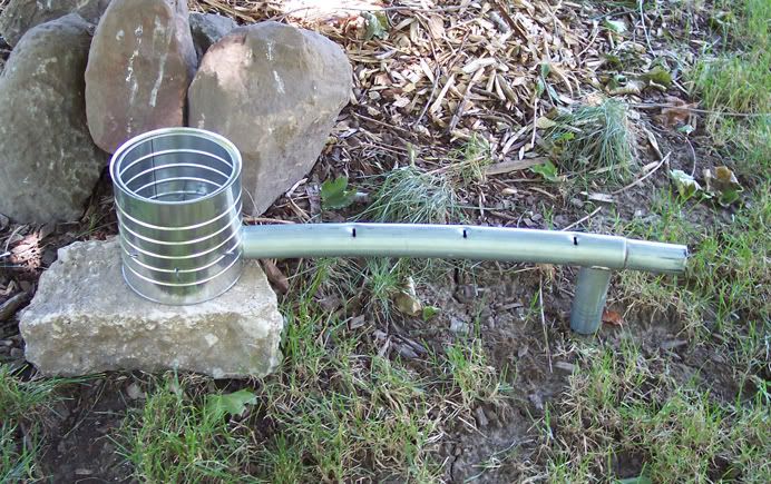

The pipe going into the base of the coffee can is for the forced air. I use a salvaged blower from a hot water heater (not shown) but a hand held hair drier might work.

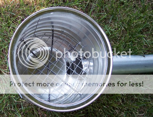

This shows the crude grate that holds the charcoal, as well as the forced air pipe entering the base of the coffee can.
I've been using this setup for three years, about thirty knives, with the last time about a week ago.
It's small and can't handle blades over four inches in length.
It takes a minute or two for a blade to get red hot, but most of my blades are only 1/8" thick. I'm sure 1/4" thick steel will take longer and need more charcoal to get it up to temp.
Blades usually emerge with strange bumps on them. I'm told that this occurs when the charcoal touches the steel and the presence of the hot carbon (charcoal) results in localized lowering of the melting point and the bumps. Whatever the reason, it can be quite frustrating to finish a blade nice and smooth and then have it emerge with the surface all goofed up. On the other hand it can add a certain "character" to the blade.
If the bumps aren't enough, then there's also the black slag (?) that covers the newly hardened blade and has to be sanded off before tempering in the over.
I make my own charcoal out of scrap wood but if I had to buy it I would look for charcoal that is not squished into briquettes. Why? I'm not sure. Just because, I guess. I've never used the briquettes. The forced air causes the charcoal to burn hot and FAST. I have to refill the "forge" after each blade.
I use canola oil for a quench. Warm it up first so it is less viscus and more fluid. I normally harden from three to six blades and the oil can get quite hot. You don't want to get it hot enough to the reach the flash point. The last time I hardened some blades I quenched the blades in the oil and when they had cooled down enough so that they didn't sizzle in the oil I transferred the blade to some soapy cold water. The cold water was to get them cooler without heating up the oil. The soap was to help start the clean up of the blades, and I think it did help.
Good luck,
- Paul Meske, Wisconsin
