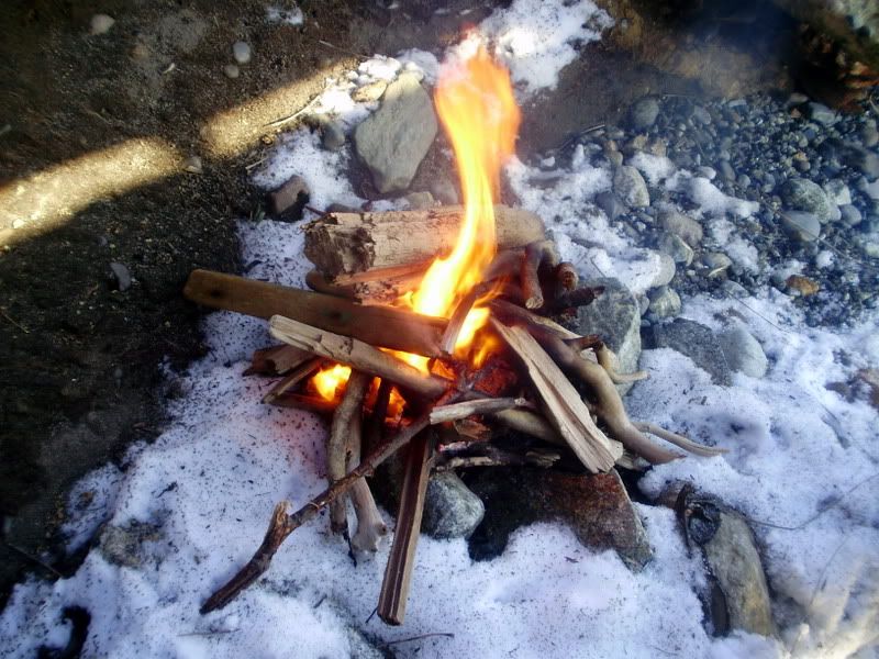

This was the toughest fire that I ever had to make, man everything failed, it was blowing a gale, snowing on and off and I was also getting water coming off the sea. My Bic failed, my matches kept failing until I no longer had the dexterity to pick them up....in the end I had to place my hands under my armpits beneath my clothes for about 5 mins and then have one final attempt with a match ! Yah there are no fuzz sticks etc, I was too cold to use my knife !!!!!
This was me when I'd warmed my hands enough to set up the camera.....
I wish I'd had the Zip brand with me then !!!!!
