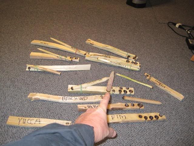

I'm looking for feedback on successful combination's of firebow drill and base/hearth board.
Hard or soft drill with hard or soft base?
My combination has been a medium/hard drill with a softer base. This combo is hard work and not often successful. Some input would be appreciated.
Maybe some input on v'channel friction method materials can help too.
Cheers
Note: I would like to purchase timbers to make kits for a scout demo night so i'm looking for materials to make it easier for the scouts to have more successful attempts.

Dartanyon, You can get most woods to work for the bow drill.
I have tried and gotton coals with many different woods. Some are harder than others though.
Soft to med are recomended but that does not mean that hard woods
will not work. Just get out there and try different woods in you area.
If I may give you a little advice. Cut your woods green and then spilt them and then carve them. Hearth and spindles. If you use any HARD woods when they are seasoned they suck for getting prepared. Well that is what I think anyways. cutting notchs and then the divits are bad enough. Going out and just making a set up from hard woods when they are seasoned is a lot harder than with soft to med. woods. Also with harder woods I tend to anyways have to spin that spindle many more times to get my coal than when working with soft woods. Again my way might not be what yoru way is and stuff like that. Everyones skill level is at just that different levels. Someone doing the same hard wood might get there coal in 50 strokes as I normally take 70 to 80 when using hard wood like hickory.
Bail Doc mentioned sycamore and if it works well, Yep it does even with a Corn Cob :D and horseweed, golden rod, yucca, willow, cotton wood, Sunflower, and many more different woods and dreid plant stalks. Eversince skab0311 posted about using a corn cob I have been out trying it on all of the woods in my area.
I just love using a corn cob for a spindle lol. I just cut some fresh oak to try it on. In few days after it has sat on the heater vent I will give it a try and
see if I get a coal with corn cob and oak.
Only by getting out there in the woods or where ever and practicing will you get the hard earned knowledge you seek.

As far as differing hardnesses in one set of tools, my experience has been that the drill should be harder than the hearth. I could never make it work, the other way around. Of course, same material for both drill and hearth makes the most sense because the wear will be relatively equal for both drill and hearth.
Actually, this thread brings up a good point. We need a data base of successful (ones that you have been successful with) combinations. Rather than bog this thread down, if you (all of you) want, email the combinations to me, and I will record them and arrange them in some kind of order and post them when complete (although it may never be truly complete)
We would need the binomials for woods/weeds used, since we are an international community, whether hand drill or bow drill (heck, I guess we could include all types of friction fire - fire saw, thong, plough, etc.) and your location. It might also be helpful for a short assessment of difficulty.
Storm (R.I.P.), on another forum, did this with hand drill combinations for the west coast, but I would rather do a new list.
Thoughts?
Doc
