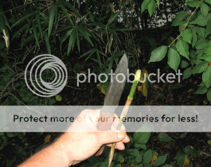

I found a few good patches of river cane. I want to go back one Saturday when I have some time and some cordage and look for some willow for the hoops and make a fish trap.

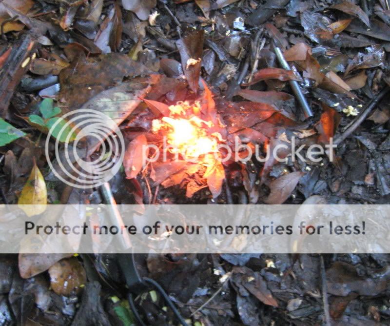

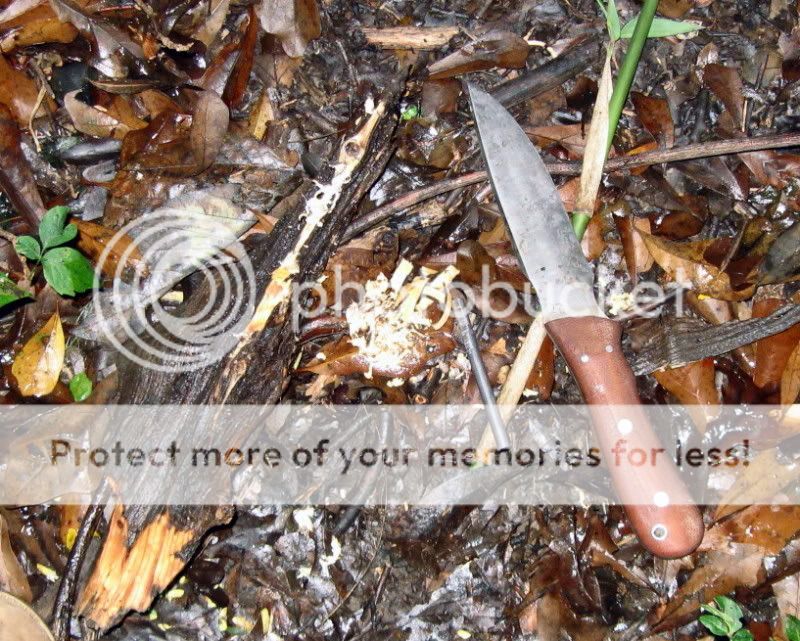

I carried the same piece of fatwood I used to conduct the earlier experiments with this firesteel. I wanted to test the firesteel more in real adverse conditions so I didn't use a base of any kind. For this experiment I simply scraped off a pile of fuzz and some slivers onto some wet leaves on the ground.
I tried several times to get the tinder to ignite using the firesteel.com steel. I did manage to get a few of the spastic sparks to land on the tinder but most bounced off. To me, at that time, that was no big deal...nothing I hadn't already experienced...and just part of the learning. BUT, then I just stopped getting any sparks...none at all. I cleaned the edge on the surface of the spine I was using to spark with, and then I even tried the edge of the knife...but all to no avail. I could still not get any good sparks...just hunks of the steel to come off and a few tiny sparks. At this point I pulled out the LMF firesteel in the loop on my knife sheath and tried it to see what was going on. With two sparkings of the LMF Army model I have been carrying and using for months, which sparked the same as ever, I had flame.
Now I am really puzzled as to what happened. I didn't change techniques or do anything different...the sparks just quit happening. I am going to experiment with it some more in a bit outside on the porch, maybe try the other end or something. I do know I am not going to stop me from experimenting with the misch metal steels as I have heard too many good things about them from other people. However the ones I have heard the most feedback on have been the ones sold by going gear so I think I need to order one from Storl now. I hear the badgers are awesome.

I just went outside and played with this firesteel some more. I tried the other end of the steel and once I got through the outer coating I got some good sparks. Then I turned it around again. At first all I managed to do was just scrape off some long slivers of metal that stuck on the edge of the spine. This happened four times and then sparks again and I am now once again able to get huge white hot sparks. I almost landed one on my daughters blow up pool, but shhhhhh don't tell anybody. I'm not sure what's up with it. Is there a chance it could have just been an uneven mix of the metals when making it?
