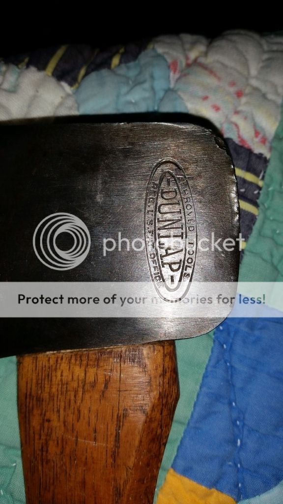

Now on with the show. I was given 2 hatchets from an old relative. One is a great looking Dunlap with the sticker still on the handle and a nice stamp on the head. It will be put up for my son to pass on to his children some day.

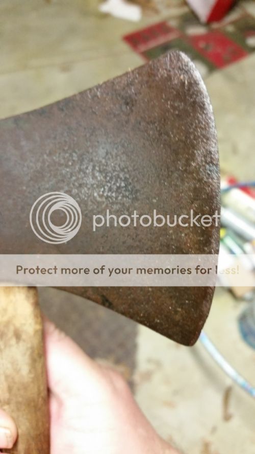

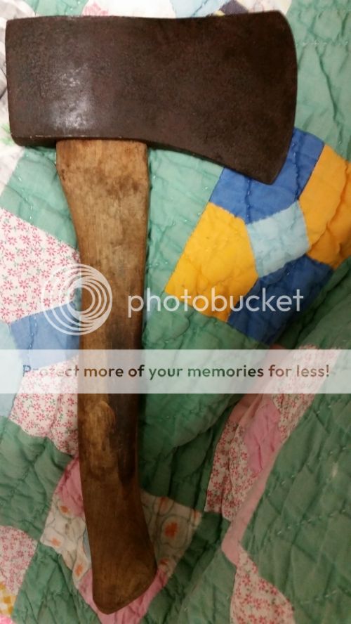

The other is a nice looking hatchet, but has a good bit of rust and the head has some light blue paint. I believe the handle is original and still tight.
The only marking I can find so far is:
MADE IN
SWEDEN.

3. Can I remove the rust without removing the remaining paint? And is the paint that big a deal for a collectable?

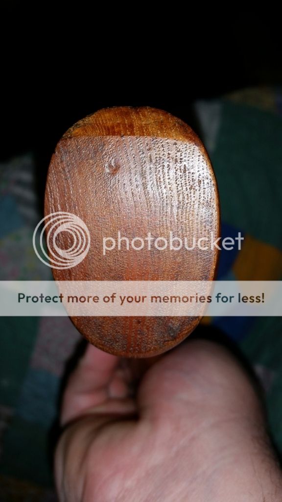

4. The handle is extremely dry and I have bought BLO. I figured I would sand it a little and then soak it down real good to see what it looks like.

Dunlap was Sears 2nd line of tools after their premium Craftsman line. Mostly sold in the 1940s and 1950s - maybe 1960s. The clipped fawns foot makes me think it's a later model.
Can't be certain about the Sweden axe. Many of those were imported with a Stro-Bro label and made by Gransfors Bruk. But other swedish makers used a similar blue color. In any case they are both quality axes.

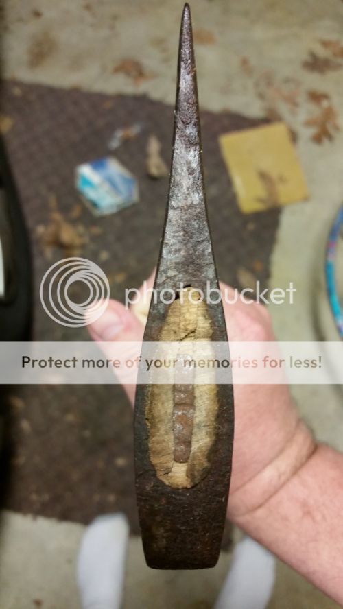

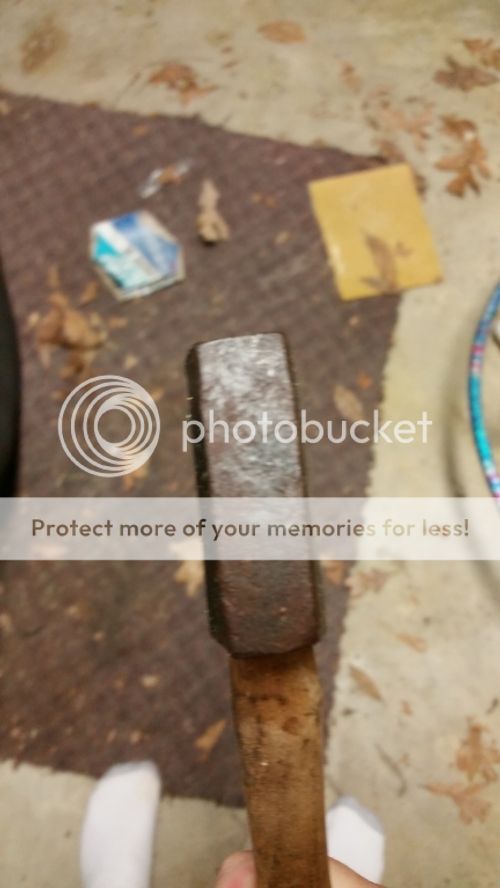

I don't think that it is an original handle on the swedish one. It looks too short for the head, and the mushrooming on the top of the axe around the eye is a dead give away of someone rehandling it improperly by just beating it down on the handle.
It will make a nice boys axe. I would just knock the rust off with a brass cup brush in a drill and sharpen it up with a file.

Do not soak the Dunlap hatchet in anything to remove rust, it pretty much only has a patina on it which should never be taken off.
Just spray it with wd40 and use a brass wire wheel In a drill to take of any light rust there may be.
As far as the handle goes, if you intend to use the hatchet you may want to scrape or chemically strip the varnish off.

Is a varnished handle really a slip issue if you're wearing gloves which many people do these days...especially those anti-slip mechanics gloves so common these days? Seems a varnish might actually be stickier in that case....just a thought.
It's usually a preference thing. I don't like the feel of lacquer or varnish. I have a big mattock handle I did with a varnish, but I don't care for the feel very much. However, you can always add thin coats of BLO on top of the lacquer. It won't soak into the wood, but it will still provide a better feel.
