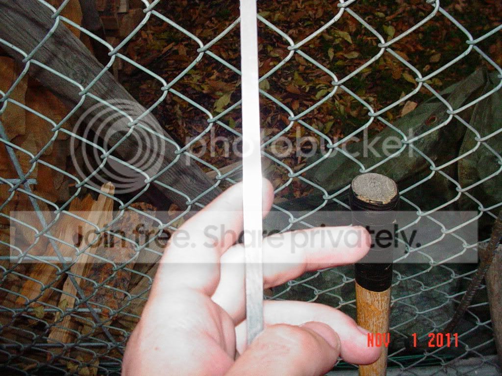

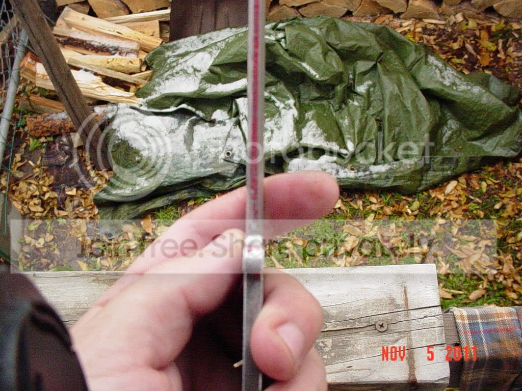

I don’t have access to any sort of grinding tool other than the 4” angle grinder and some files and not having used an angle grinder for any sort of “fine” work I opted for the files. I thought I knew how to use a file, and well, I was WRONG!!! Cutting in the main bevel on 5160 with a big file is a work out I have never seen before. I had no idea what I was in for when I started this.
It was discouraging when I rolled it over and started on the other side. After two days work I was back to square one but it didn’t take long to get about a ¼ of the way there in much less time. The first side had taught me how to use a file, along with some time on the “Good Info” sticky.
Sorry about the bad pic.
I’m kind of amazed at how close to square and center I’m keeping it thus far. The list of things left to do to it before I get it heat treated is growing ever shorter. I need to remember were I put my sanding block, drill the holes for the hardware, and finish off the bevel.
It only took me a little wile to figure out I jumped into this with both feet before I had any idea what it took, I am enjoying it though.

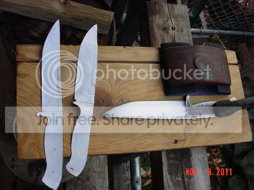

I finished off the bevel on the second side, or at least have it close. I'm going to start sanding it in the next few days as soon as I figure out were I put my sanding block.
I have decided to use Corby bolts to mount my handle slabs, with a mod that I saw suggested in another thread I posted. Ill cut the screw head's deeper so that I can remove them and the slabs if I need to replace either. The plan is to use 3 of the large size brass corby's on either black G10 or Micarta.
Dose any one have suggestions on were to get good quality corbys and G10/Micarta? I had originally planned on making my own micarta, but after some reading I'm not sure I can get it done well enough for my intended purposes.
Again thanks for any advice or tips.

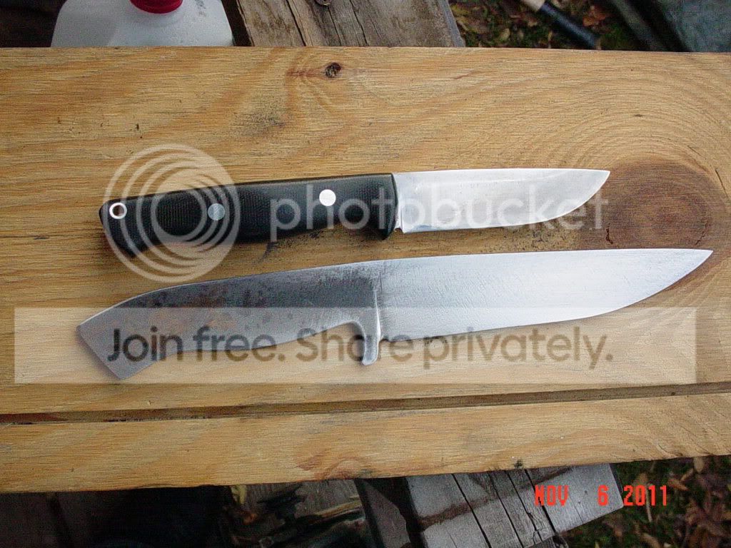

Wile I was looking for my sanding block and emery cloth I found two of the cut outs I used to get it on the steel. Got it all set up and ready to start sanding and snapped a few pics.
With my Bark River Gunny.

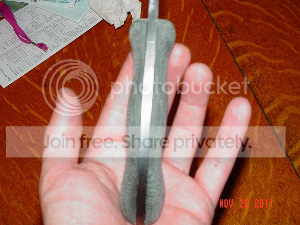

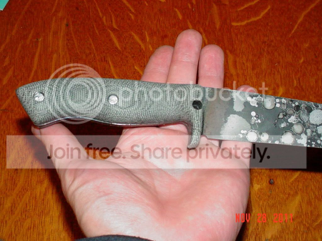

Ok, so I didnt manage to get back as fast as i was thinking i would. But now i have pics and more progress.
My lessons in micarta started with the pair I got from USAknifemaker. Well, they are in no shape to be called handle slabs at this point, but it was a good $5 learning session. They also helped me find a local guy that sells handle slabs in all sorts of woods and other things. I didn't take much time to look, as he was in the middle of an elk.

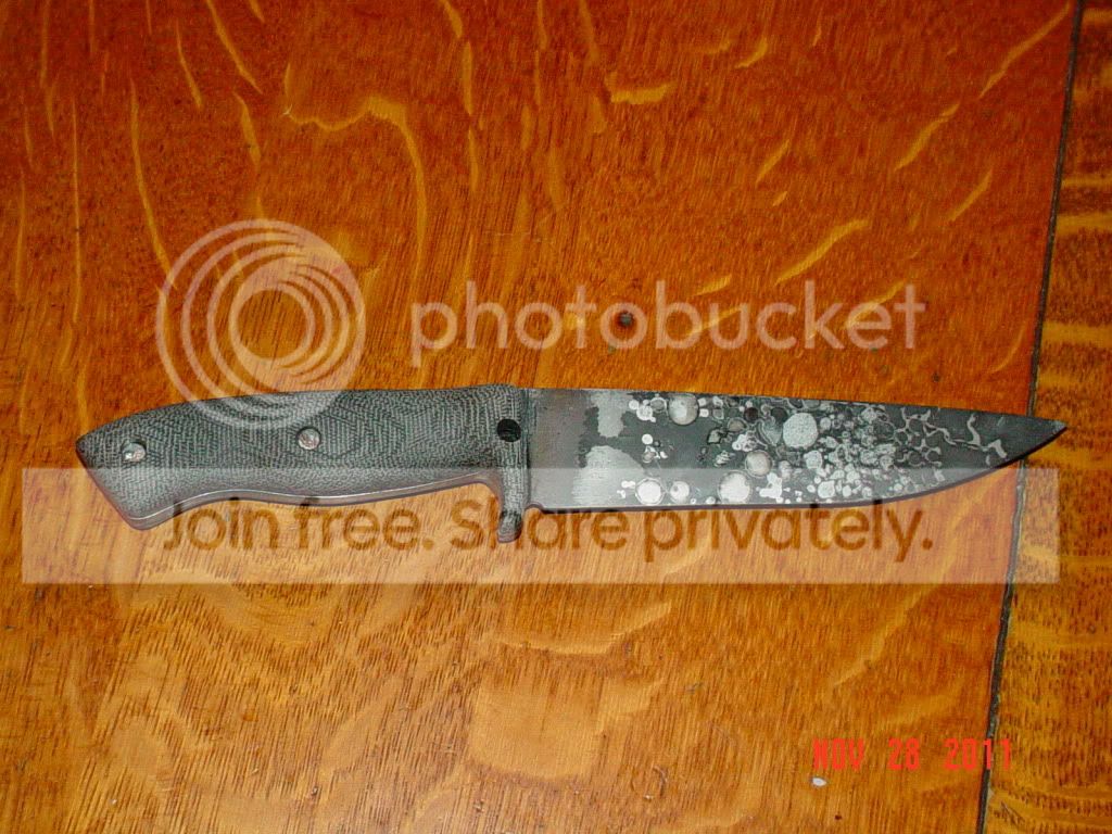

I also hardened it today. In other words I went over to to the shop that gave the the steel to start with, and they walked me through it.
Sorry bout the fuzzy pic
I'm really happy with the way the slabs came out, they just feel... right.
As you can see it hasn't seen anything but a rag since coming out of the oil. I'm tempering it tomorrow in an oven at a buddy's house wile we play cards. Every thing I have read and what the guys at the shop told me is 450-475 for 2-3 hours to get it to 54-58 rc. This is going to be a field knife and will get beat on.
I'm not sure if I want to try my luck at using the 4x36 belt sander that I found I could use or if I should just finish it off with files and paper the way I have done the rest of it.
Any suggestions or advice any one can give me is appreciated.

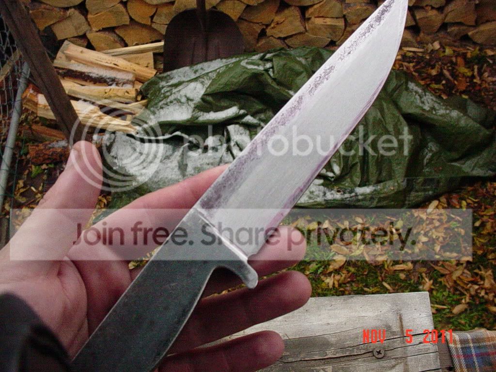

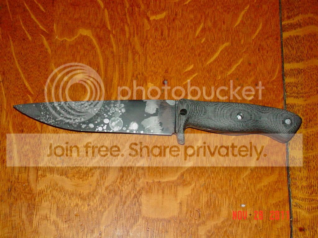

I have it all cleaned up after the HT and got it down to the point I'm ready to put the final edge on it all with files. I can't count the number of times I almost set up the sander. The epoxy is setting right now, so tomorrow I'll start the final sanding, only going to 600.
If every thing works out right Ill get some pics of it up this weekend finished and getting put through some "intended purpose tests". That being I'm going to take it out make some fires (AKA baton wood and make feather sticks) and make some weeny sticks with it. I hope it survives long enough to get a sheath made for it next week. :D

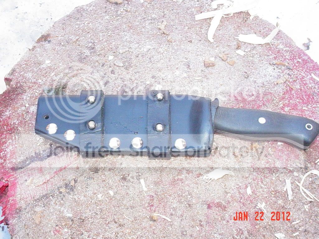

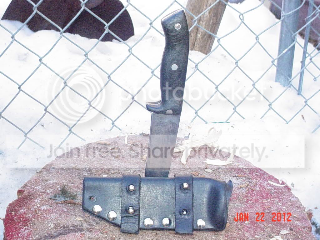

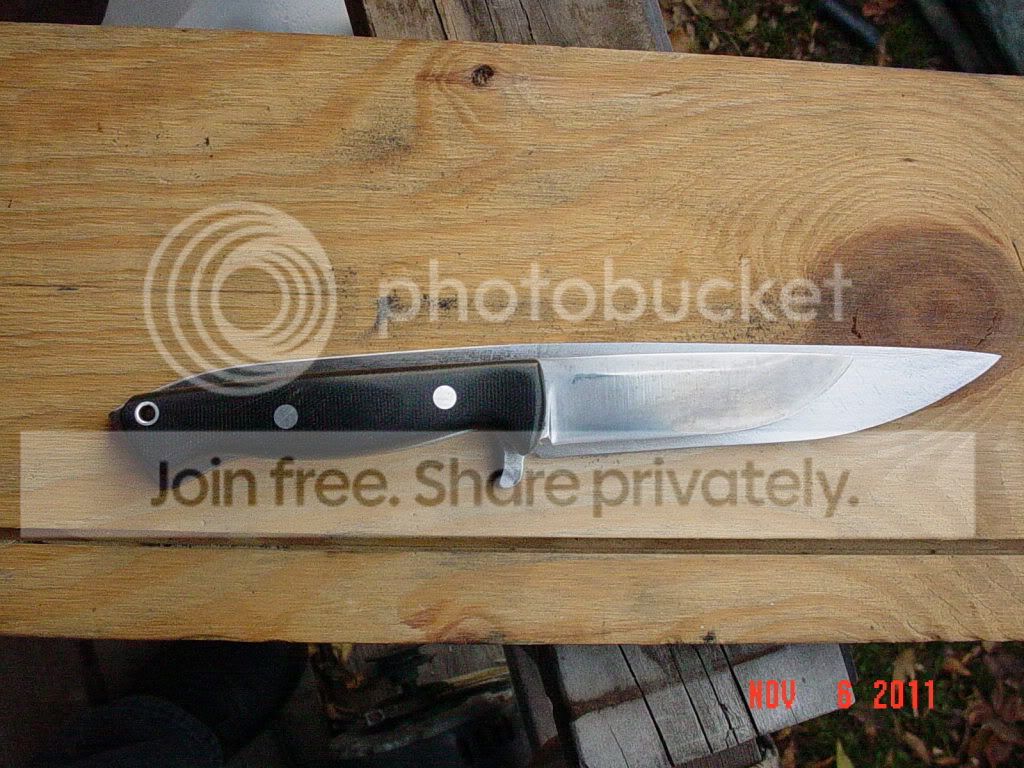

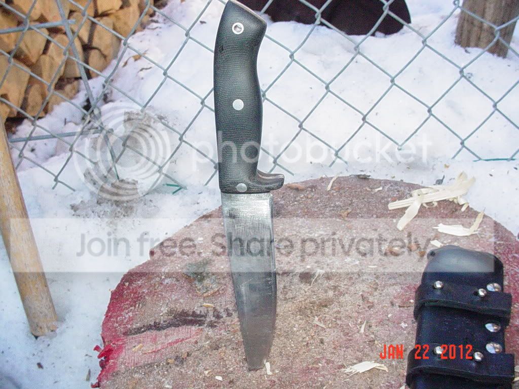

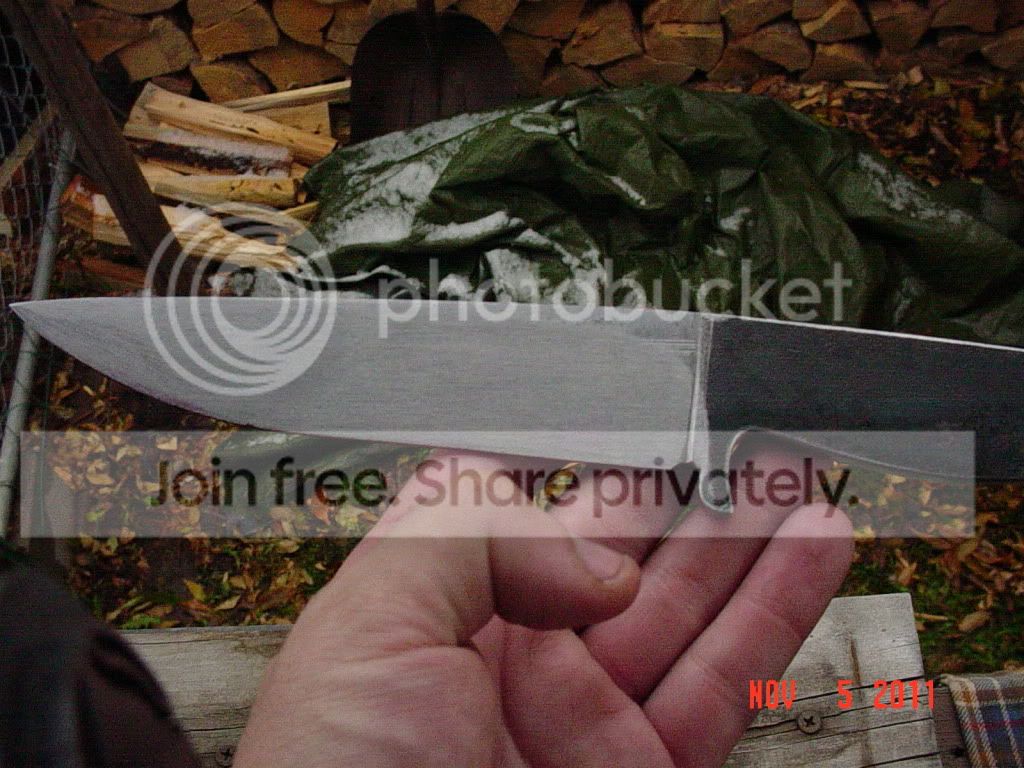

So it has taken more time to get to this post than I thought it would, but I'm here. This knife is finaly finished with sheath and "testing" (read: I took it out and did things to it that boarder on abuse) and has survived.
I wish i could attribute the blade shape to historical "survival knives" that were basically kitchen knives but.... no it was several things and none of them were planned.

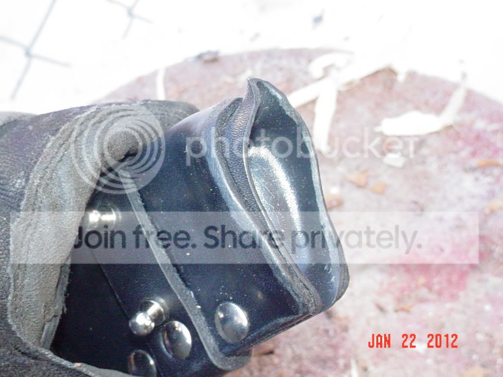

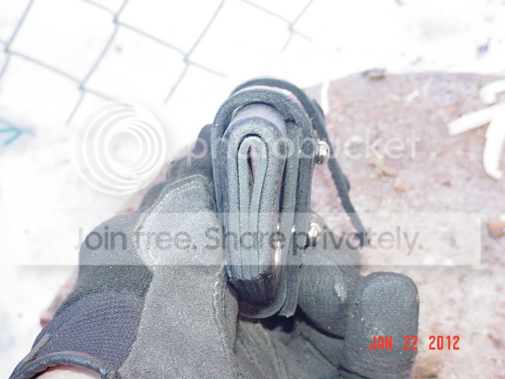

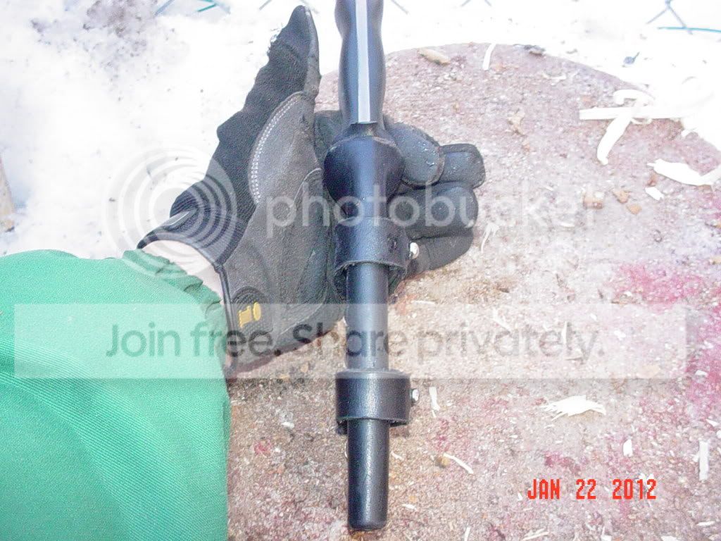

After modifying a few sheaths for a few of my cheep knives I have found I like the scout carry option and kydex, but don't like the looks of kydex.
After three sets of snaps I decided that simple and interchangeable were good and used button studs for the strap closure.
With every thing done it comes out to just a hair over 5 3/4" long in the blade and 1 1/2" over all. I don't have a scale to put it on nor a RC tester but according to my dads butcher steel test its a little softer than my Bark River Gunny in A2 that is quoted at 58Rc. Not very scientific but is about as close as I have the funds to get.
It has been a huge learning experience, and a lot of fun to boot. Everything I learned in this one I have already put to work making two more knives, that are better than this one.
Thanks for looking and all the advice and help you all gave me to to get this at least close to knife shaped.
Awesome job and WIP.
Only "must give" advice is don't wait days to temper after hardening, you may get a nasty suprise with it being in such a strained state.
