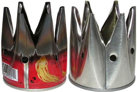

This is what most of mine look like - can set a pot directly on it and the flame comes out the side holes, or use a stand and the flames come out the top. With a tight fitting wind screen it can rolling boil 1.5 quarts of ice cold water with about 1.5ozs denatured alcohol.

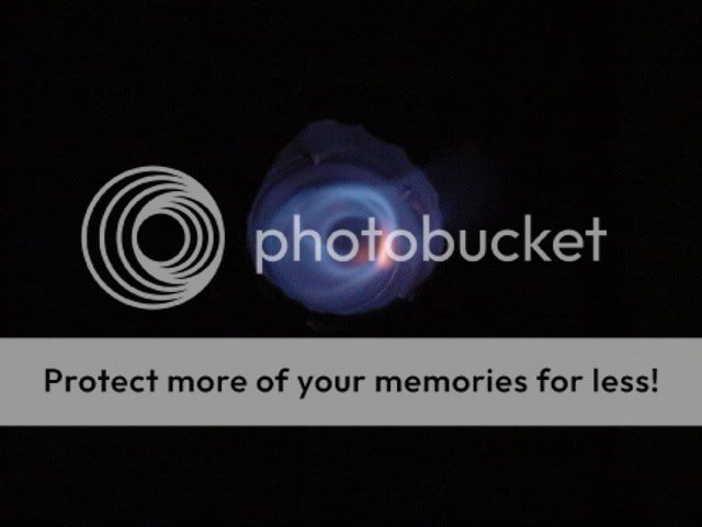

and I did a lot of experimenting with the cyclone ones - they are real neat but very temperamental.
This is what they look like when running good
