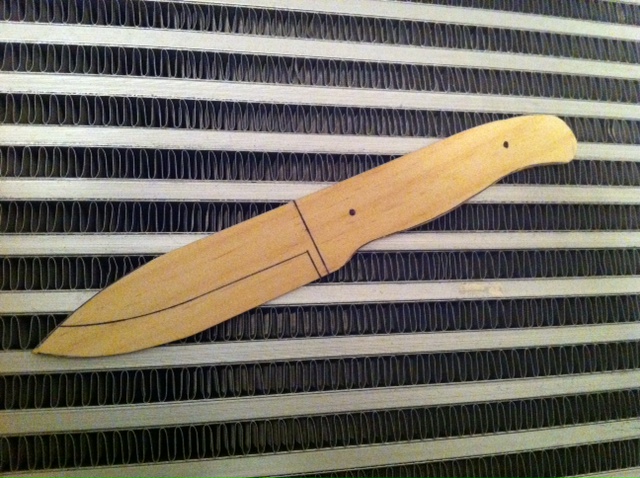

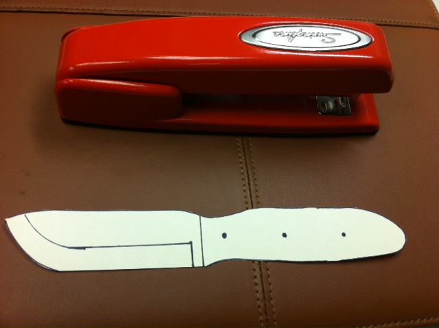

This is my first attempt at creating a knife it all started when I was listening to a podcast from Jack over at The Survival Podcast a couple of weeks ago where he was talking to a bladesmith that made a knife for him this peaked my interest in custom blades and with the help of Google I was lead here! With the great advice in the forums (particularly the post “How to instructions for making a knife” from bladsmth -awesome write up!! :cool:) I feel like I have a great headstart in avoiding some simple mistakes that a newbie would overlook of course I’m sure I’ll find out there is a lot of trial and error to go through while learning so I’ll be reading, researching and asking questions as I go!
There are a ton of talented folks here and comments and critiques are sure welcome if you want to chime in. I’m going to pick up some metal today and get started shaping away so wish me luck!

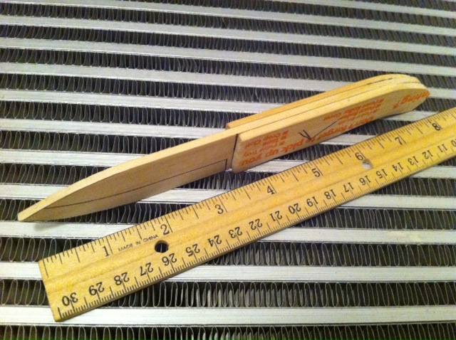

Cut it out of cardboard, or paint sticks (they are free)
I would lower your point, whether with a drop or a clip
Have a look at the design section in the links below and use them to start drawing from.
I think the curve at the tip is too steep, lengthen out the curve a bit.
If you have a set of drafting french curves it can help.

You might want to drawn a line down the center of your pattern from end to end and visualize how you are going to use it and see if you really want your tip so high above the center line.
The good thing about a custom knife is you get to make it the way you want. But as others have recommended it is good to make it out of cardboard or paint stick first. ;)

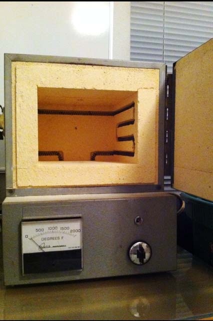

Here is the picture of the kiln btw, nothing as fancy as the ones I see guys on here using and I hear all the talk about the temp controllers and such so I'm not 100% sold that I'll get the desired results. May just have to try and see what happens but if anybody has a definite yes it will work or no way that would be great!
If the kiln will hold a steady temp and is deep enough for the blade it will work fine.you will need some H/T foil to do air hardening steels.
Stan
Yes it will work. That model has what is referred to as an infinite switch, meaning that it cannot simply be set at your desired temp and it will do it for you. You will have to baby set it a bit to keep it where you want it. If you go with 1084 for your steel this will be ok due to the fact that 1084 does not require any special ramping of temps or a prolonged soak at the desired temp. As long as you Read the sticky's regarding heat treating 1084 you will produce a great knife.
Sweet! I'll just have to make blades that deal with the depth then this is good news!
Just stopped by home depot and grabbed a handful of paint sticks to play with tonight I'll report back with a mock up.
Ok making a mockup was a game changer! Thanks for the paint stick idea! :thumbup:
OG pattern does not work, does not fit..etc!!
I took more time and AVigil's advice about making a center line to get everything in-line, as you can tell I totally revamped all the curves and with it everything feels much more natural in my hand. I see what was mentioned about the tip angles and think I am more ontrack with this version! Also top thumb notch is gone and handle is lengthened a bit to keep my thumb on the scales and not the blade.
Although it looks way different I am still happy with it I would like to tweak the butt for aesthetics and with the mock up scales I can see where I'll need to contour for fingers. I don't have the french curves but I want a set! All these curves were done with various items on hand..
New Layout..
With Scales..
Looks like a solid bush crafter.
I like your design.
You might want to consider a thong hole. Or leave it if you have no use for it :)
Welcome to the BF.
I like the current design. Good start.
As for steel, A-2 will make a fine knife, but the detailed HT is not worth the effort, IMHO. If you are going to all that trouble, using a stainless steel like CPM-154 would be just as easy. My recommendation for a first knife would be 1084. A four foot bar from Aldo is less than $25 including shipping.
That burnout kiln will work, but is only good for carbon steels, as it won't do stainless temps ( I know the dial goes that high, but my car speedometer has 120MPH on it ,too.). A-2 has a HT somewhere between the two, but that oven isn't really a good choice for the ramp and soak of A-2........best stick with 5160 or 1084, or send it out for HT. As for the quenchant, a couple gallons of canola oil will work fine for those steels.

Wood mock looks very good so far.
