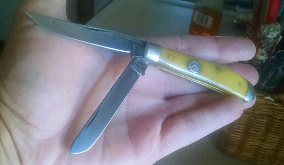

So I started to bond with my 15 today but it just didn't seem right. Thought I would try a forced patina for the first time. I read mustard, apples, and strawberries all worked. I went with strawberries.
Before
After
It turned out ok for a first try, I think. Not perfect but I do feel more bonded with it. Will it continue to change or does a force patina just stay the same?
Generally, the more a knife is carried the better it looks! The patina will enhance, in a month or two you'll see real differences. I cut my morning oranges and this soon does the business. But, sometimes the patina is blotchy so I polish it off and start again. Patina is W.I.P.

Good to know, thanks. Guess I have more homework to do. I basically just cut up a few to eat and then just spent an hour or so rubbing a stump on each side of it. I eat apples everyday so I may just follow willgoy's lead each morning.
Forcing a patina would be wrapping the blade in a vinegar soaked rag or just sticking it in a potato over night something like that. You're earning a real patina by using it so it will definitely continue to change & evolve with more use.

Hot vinegar does a good job of forcing a patina if you are in a hurry. Getting into the habit of eating sliced apples every day is a more natural way, plus apples are good for you. I've done it both ways. I like the more varied patterns you get from apples. Strawberries give more blues and purples than apples. Bananas themselves don't really create much of a patina, but the liquid in the peel sure will (like when you cut the stem off one end).
