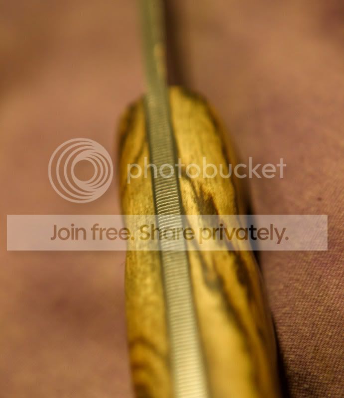

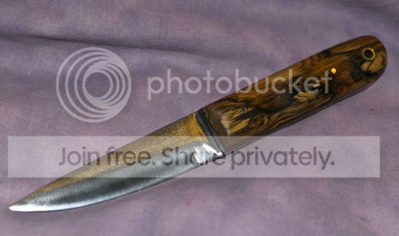

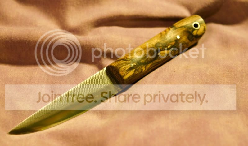

Ok here is my first serious attempt at knife making.
The steel is from a 12" bastard file. (about 3/16" thick)
The handle scales are Bocote.
I used stainless tig welding rod for pins and stainless 1/4" thong hole tubing. I also used vulcanized black spacer material.
I don't have much to work with so it was made with a 4" angle grinder, 4x36" belt sander, files, and lots of sandpaper.
All the heat treating was done "Rambo style" in an Oak fire and quenched in motor oil. I did two temper cycles in the wife's oven.
I still have a little sanding and smoothing to do on the handle and
I have yet to sharpen it.
I used a file for two reasons...
A. It was all i could afford.
B. I think it's a cool idea.
It is 7 3/4" over all, 3 3/4" blade.
Not sure about the weight but it's pretty heavy.
Any critiques, advice, or pointers would be greatly appreciated.
I did the best i could with what i have, and it was sooo much fun!
I'm left with a real feeling of accomplishment.
I'm hooked.
is the inner mouth of the tubing you used for the lanyard hole chamfered/radiused?
the knife looks good, and your scale material is gorgeous.
Very nice first knife:thumbup: I've always liked the looks of a knife made from a file where you can still see the old file pattern on the flats. It just looks cool. Keep 'em coming!
I've made a few out of files, you did a very good job, you actually put a handle on it... I have yet to do so. Trust me though, that is very difficult steel to work with. The teeth make it much more difficult.
"radiused"? :confused:
godspeed that knife is just beautiful, anyone should be proud to call that their first knife. So are you going to sell it, frame it, or use it?
Not yet. I was thinking of using a dremel tool to clean it up a bit. There is also a little gap around the outside of the tubing that i need to do something with.... i don't know what though. I might try making some filler from the bocote sawdust.?
I'm going to use it! I have to test it out. After all i didn't use the most high-tech heat treating methods... I couldn't sell something that looks decent but doesn't perform. And Bladsmith said in his tutorial that you should never sell your first knife. I will try to sell the next knives i make, if only to get some decent steel to try out. I couldn't justify charging too much money for a file knife when i only have maybe $15 in it.
