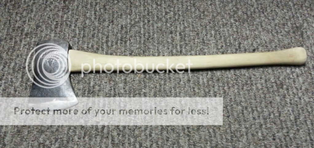

I came across a "Kelly Axe and Tool Co." (non-Works) 3lb (I think) head, single bit with no handle for $15. My basic research suggests it from between 1904 and 1930 (but could possibly be younger). It's exactly the kind I was looking for. (FYI - the gentelman had a hewing axe head supposedly from the 1800s, as well as a large 4.5 lb. Plumb felling axe head...might need to go back). So I decided to restore it. No pics of before (typical rusty axe head), but here's what it looks like now.
It took quite a bit of cleaning, and whole lot of filing. Once I started (using an Indian steel double cut file) I knew it was good, hard steel...it took a lot of effort to remove material from the edge. Even the poll, which had some mushrooming unfortunately, was hard to file. I was very excited at the find. The cheeks were very thick, so I took a lot of time to get it sharp. It's now as sharp as some of my machetes (from double cut to single cut file, then to fine stone, then ceramic rod, then stopped), and while I haven't used it much yet, it's brutally, brutally sharp and seems like it will hold its edge. I hung it with a new handle, but it's not my best work. The eye is a bit narrow, so a ton of wood had to come off the Link 36" curved handle, and the eye was longer than the handle, so there is a bit of a gap. Admittedly not my best effort, but it's really on there good. If it comes loose, I'll start over. I tried to tighten the gap with a second wedge but it made things worse. But like I said, it's on there very tightly.
I sanded the handle and added a tung oil finish for now. I need to rasp the lower handle for increased grip, but it swings beautifully as it is. I decided against polishing the entire head...there's still some surface rust (and you can see some minor pitting), but I really like the look and feel (reminds me of my Gransfors). I feel it's an awesome piece, and for being 85-110 years old (I think), that makes it all the better. :thumbup:

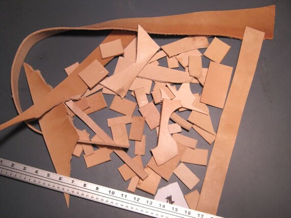

4) Any recommendations for a good supplier of leather so I can make a sheath? I asked Saddleback (I have a wallet and belt) if I could buy some remnants, but they were only able to suggest Tandy Leather.

It's a Michigan pattern, probably a 3.5 lb originally. It's probably the most prolific pattern/size combo when it comes to vintage heads, so it would make sense. Personally not my favorite pattern, but it's a good one - great work axe when it comes to felling, bucking and limbing and the profile splits wood quite well too. I just am more drawn to patterns with shorter, wider bits like Jerseys or Connecticuts. All preference really. I used to own two Michigans, but I gave one of them to a friend. I still have one, hung on a 28" straight handle that I use the odd time:
That said, you'd probably find a 30-32" most comfortable. That's what most people go with for 3-4 lb axe heads.
As for the hang, from what I can tell you probably could have seated the head closer to the shoulder - that would have gotten it down to the wider portion of the wood. Also, the wooden wedge provided clearly wasn't long enough -it should have gone from the front all the way to the back of the eye. If you ever get one like that, don't be afraid to just make your own. A metal wedge really shouldn't be needed in my opinion.. if you hang it right with the wooden wedge, it'll be more than secure enough and you can hold onto the metal wedge in case the handle begins to loosen after a lot of usage.
And yes - if you have a Tandy Leather store nearby, that's your best bet. Saddleback probably isn't willing to sell you any because if he's like me and uses his leather efficiently, the scraps usually aren't going to be big enough for any sort of meaningful project. And he'd probably feel like he were screwing you over if he just sold you a couple sheets because shipping would be around the same cost as the leather (doubling the cost for you). Honestly just drop by your local Tandys if you have one and grab a shoulder of 8-9oz veg tanned leather. It'll set you back a good chunk, but you'll have enough for dozens of projects.
You have a nice older Kelly. It is pre- True Temper days. For some reason I can't remember when TT took ownership of Kelly this morning. It is a very nice axe.
You did a nice job bringing her back to a useful life. She'll last you for another generation or so...
Tom
I like mine lower on the shoulder and I would split/carve some hickory tapered and slightly larger than your gap at the front and drive in there. We used to force warm beeswax into the really small gaps to keep water out. Having no bees now, I use wax from toilet seals- one seal lasts a long long time ;)

Thanks everyone for the kind words and suggestions. I think I'll look around for a handle that might work better, and I definitely agree about it being high in the shoulder. However, that is sort of a "false" shoulder, as I had to remove a very significant amount of wood from the handle to get the head on. I thought it was odd that the handle I grabbed was way, way too wide (especially since it got wider as it moved towards the shoulder), but not long enough front to back. I actually ended up taking off quite a bit of wood using my angle grinder with a flap disc, as the rasp was taking forever to take of the amount of material needed.
I think I should have used a saw and cut directly into the shoulder and worked the handle from there. Thanks again for the tips, I'll be on the lookout for a different handle...perhaps a 28-32" handle as suggested, which may have a smaller eye wedge. Or, I may just pull it off and rework it to sit lower on the widest portion of the shoulder. Thanks for the suggestions again!

Okay, after hearing everyone's advice and agreeing on all the points (including some safety and durability concerns), I came to the conclusion that the handle I chose simply wasn't very well suited to my Kelly axe head...FYI it was a Link brand handle...great handle for a shorter, fatter eye, but not for my particular axe. I ran to Lowes and picked up a True Temper (go figure, right?) handle...36" curved, with a longer, thinner eye...perfect! So I pulled the head off (destroyed the top of the link handle in the process...any suggestions for a reuse?) and rehung the axe head. The fit is 10X better, and took about 10X less effort. I skipped the metal pin on the advice from here, and here are the results.
I would have preferred to keep a bit more handle above the eye, but it was essentially flush once it was seated all the way, so I cut off the portion that protruded and sanded it even with the handle to make it look nice and finished. The handle came with a thick lacquer that I sanded off, and finished the upper portion with 320 grit, while the bottom portion was left sanded with 60 grit fro better grip. Oh, and any small holes (like the staple in the bottom, and a very small gap in the head) were filled with a small dab of clear silicone to keep out any moisture or dirt. All I need now is some BLO and some beeswax like my Gransfors.

Looks like a fine handle and good hang. Well done.
Some of us will rasp down the shoulder below the eye to seat the axe lower on the haft. That usually leaves plenty of haft protruding through the eye.

Thanks! Yes, I did think of that, but the head was sitting so nicely I decided not to worry about it or risk getting it mis-aligned. I used axes with flush heads for many years when I was younger without any issues, and this head is on there much better than the beaters I used back then. If it loosens I will be surprised, but a metal pin or two could always remedy it as well. Edit: I forgot to mention, I actually did have to remove some of the shoulder to get it flush, especially near the poll. Once it was flush it was aligned so nicely I called it good.
