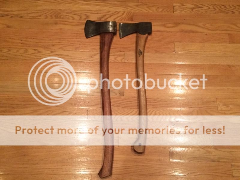

I have a 2.5lb German forest axe pattern style head on a full size handle that I cut two inches off the top and 1in off the bottom.
I had to shape with a rasp and sanding and re-cut for the wedge but it's perfect in my eyes and is really well rounded
Here it is with a GB Forest axe
