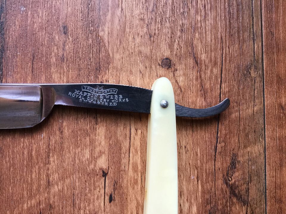

That is a great first effort! I enjoy restoring vintage straight razors and making new handles- it can be tricky but rewarding. What are your other handles going to be?
As for sharpening- I personally set the bevil on a Naniwa 1k stone and then go 3-5-10-12 on the same stones before finishing on a crox pasted strop
Thanks! I've got some red micarta, and an assortment of colors in richlite. I won't rush, I might try wood or horn. The tough part of getting the blades where I want them is done. I like the washers and pins on the one I did, but it might not be the right look for some of the other colors or materials. I do have some nickel silver and stainless pins, but no other washers yet.
For the the biggest challenge is the wedges! Are you using washers between the blade tang and scale? If you don’t want the full washer for the pinning (I agree it doesn’t go with every scale) try using collars. They give you some space to peen the pin without hitting the scales, and add a little width. Here is one I did:
