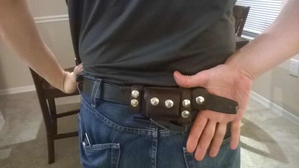

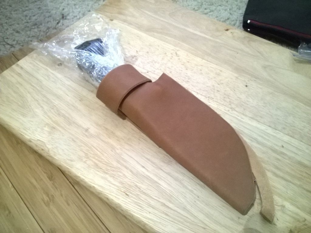

Here are sheath making pics. Sorry I didn't take more pics as I went along, I was just really into what I was doing.
Wet forming:
Finished:
And yeah, it has some "fit and finish" issues, but it's very functional. And it's the 3rd sheath I've made ever, so I'm satisfied for now, and constantly trying to improve and learn my craft.
And yes, I left this one natural. It wasn't perfect so I didn't feel like it was worth the dye, I just rubbed it up with a bucket of Snow-Proof and called it good.

That sheath looks really well executed. I like the natural, FWIW. It'll patina most excellently, I'd guess. Do you find the carry pretty comfortable? Looks like it would be. Thanks for the pics and the parts list....I've been dabbling a little (like, micro) with leather. So far, only a little mask for my 'hawk.
Yes, I'd say pretty darned comfy. With the pouch and everything it does have some bulk, so NOT incognito at all.

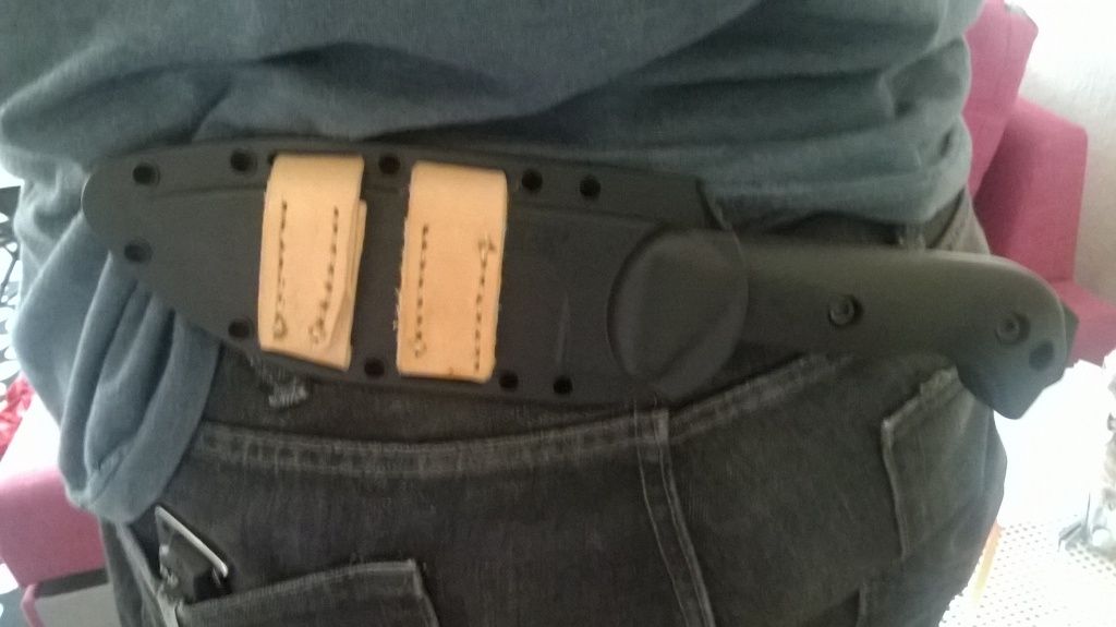

It printed way to much to wear around town so I did a "down n' dirty" on the kydex sheath that came with it and this is a lot slimmer.
And yeah, the stitching was a major PITA on this, but what can I do, I'm out of snaps?
But it is very low-profile and since we're having Florida "winter weather" I can wear a hoodie a little bit and it covers fine.
I will see if I can load up a pack and get out to a wilderness area sometime this weekend and use the new scout sheath. I think I'm gonna like it a lot, but you never know till you try it.

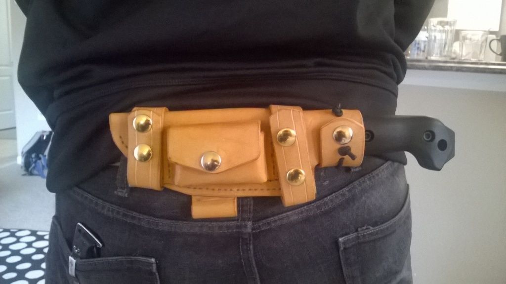

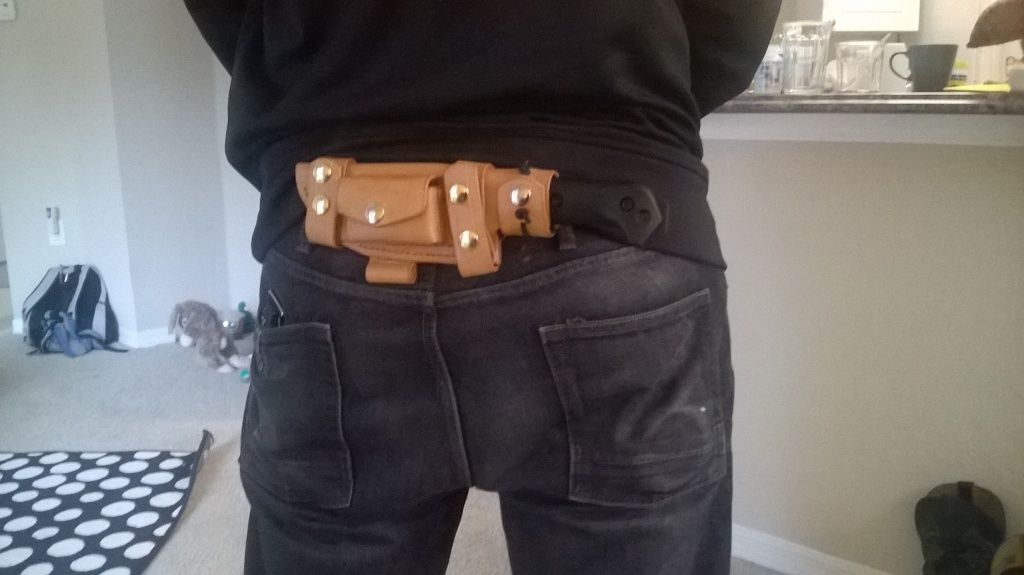

Here's the 2nd sheath I made, also a scout for a RAT-3 I got Dad for Christmas. It was made from Michael's "farmer's scraps" or whatever due to supply problems with my leather, so it was tough to work with and it didn't burnish right either, I'm pretty sure it was not veg-tan.
It came out ok, but the tinder pouch and straps and everything was SUPER CRAMPED because the RAT-3 is just a small knife.
I did want him to have that setup since he lives in Colorado and treks a lot.
And what the H is with snaps? It just seems like they randomly deform when you're banging them in. Another reason to get a press...Harbor Freight, here I come.

So, I'm noticing that you're having the same issue I had for a while with my BK2 in scout/crossdraw carry. The handle is so heavy it tilts it down.
I figured out a way to make it carry flat with some paracord though. I might be able to post some photos of it sometime later today.
I have found that the key when making scout carry setups for large or bulky knives like the BK-2 is to get first strap closest to the handle in a place that balances the knife best as possible.
Most of my BK-2 sheaths can be balanced almost perfectly on the belt with just the one strap. The second strap just keeps it in place but the center of gravity I guess you could say is on the first strap.

As for the knife tilting due to the weight, i would recommend spacing out the 2 straps that holds the sheath to the belt rather then having so close together or even having a 3rd strap.
