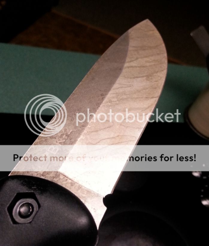

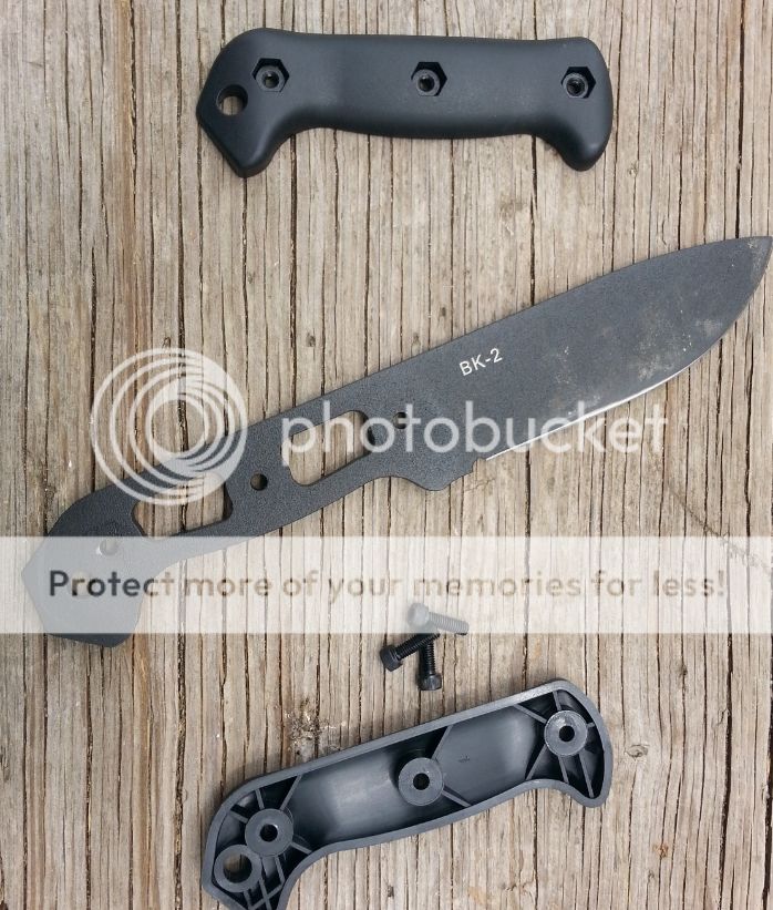

Well everyone, I decided to go for it with no planning whatsoever. I stripped, scotch brighted and put a patina on my BK2.
It's different on each side because I wasn't sure what I wanted to do... I kinda like that fact that they are different though!
The first time I had ever seen the becker without scales:
This was not supposed to be anything in particular, just an attempt:
This side is actually three different techniques I didn't like any of them but together they all added up to looking like snakeskin or something.
Thanks everyone.

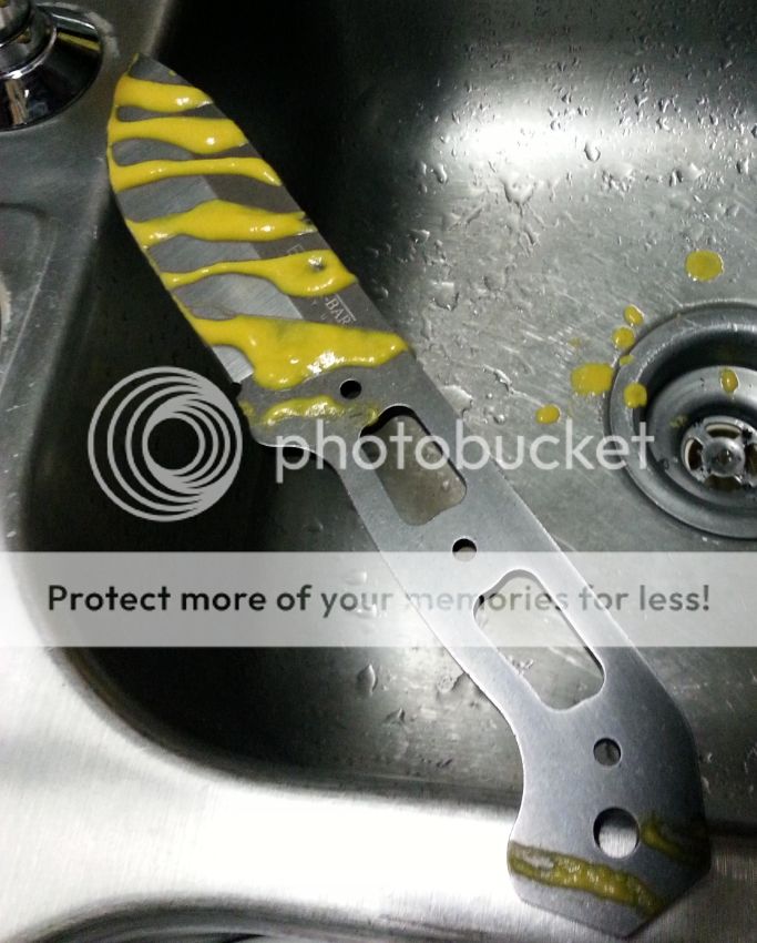

For the first side, 100% of the process was this:
I just poured mustard all over it and let it sit for 30 minutes.

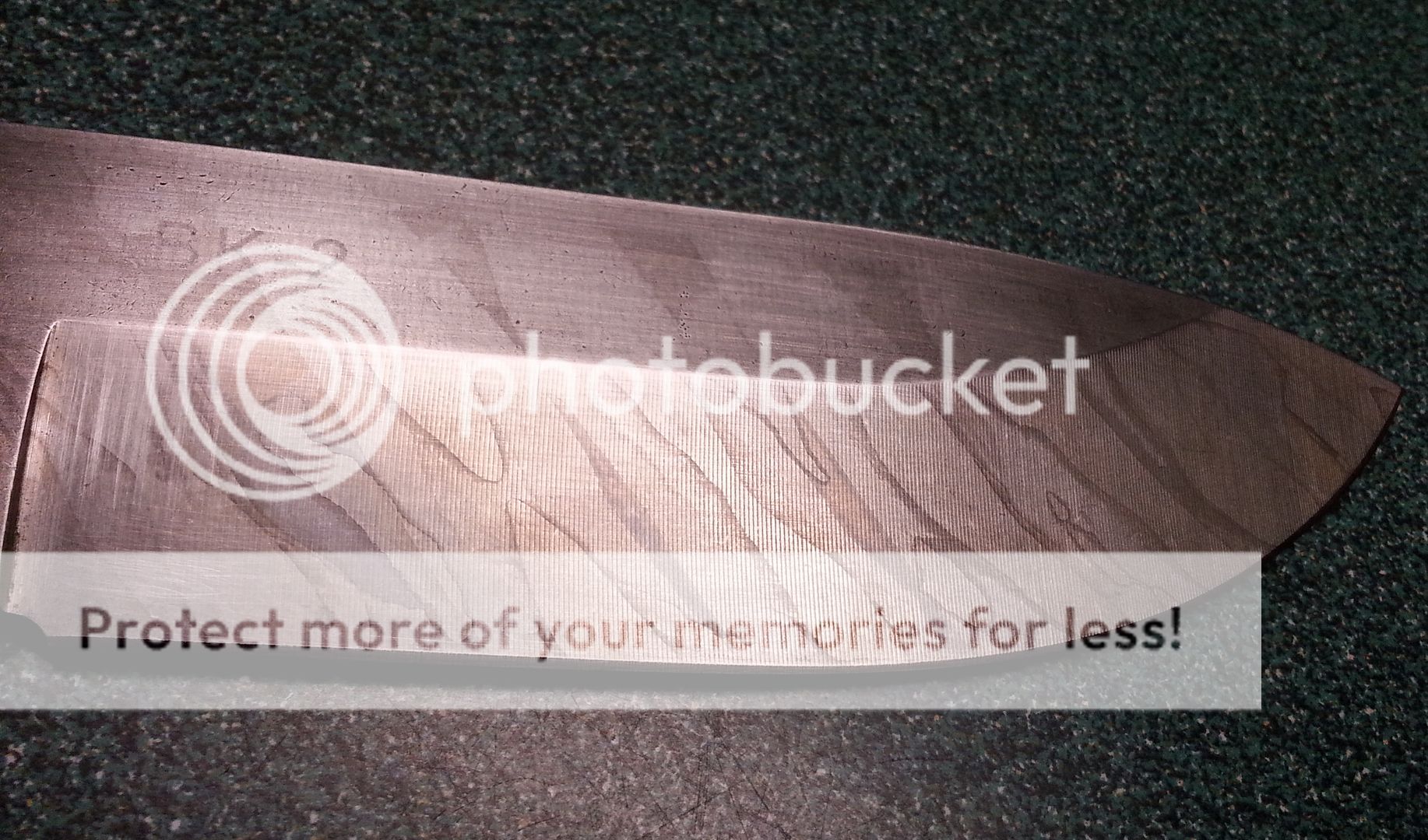

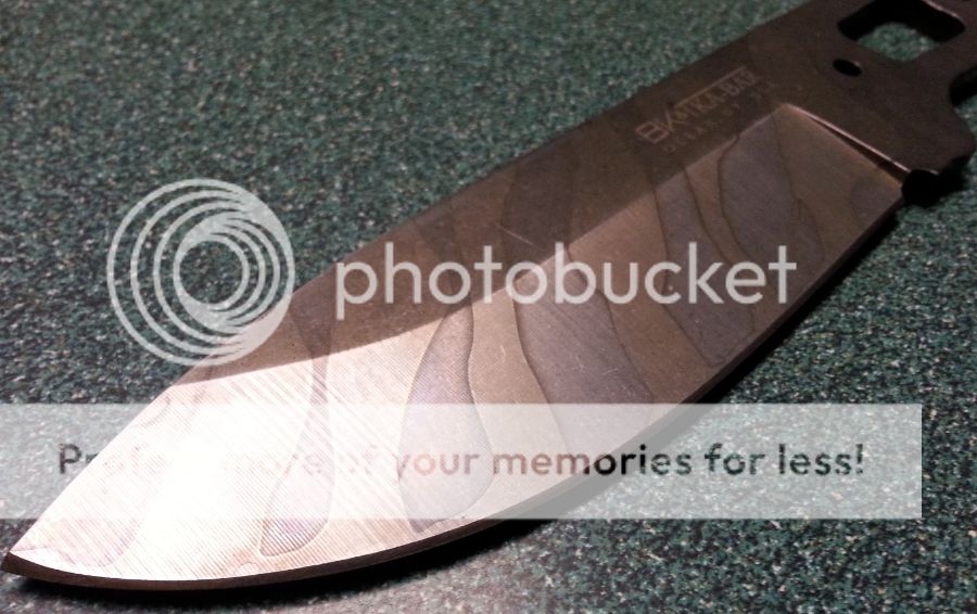

For the second side, I wanted some blueing (The color, not the process) so I did a light smear of horse radish. It worked great but was so subtle compared to the other side I started scoth brighting it again. As it lightened up I thought it may look cool if I put some mustard on top of it. and I ended up with this:
finally I drentched a paper towel with vinegar on a cookie sheet and layed the two on top with a gallon of water on top to weigh it down for about ten minutes.

If you have any moisture on the knife it will not work as well, and you have to just really let it sit... don't stir it up or move it around, just walk away and keep yourself busy for thirty minutes.
