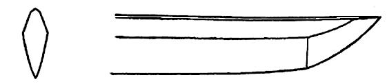

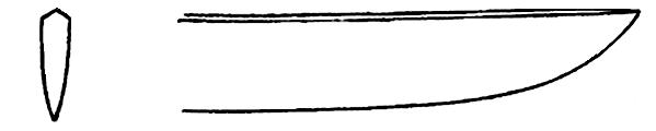

Here's a quick view of some blade profiles. I went with the hira-zukuri as is common in tantos.
SHINOGI-ZUKURI
The most general style for TACHI/KATANA and WAKIZASHI (long swords). (=> kissaki types in shinogi-zukuri style)
1) The ridge line (shinogi) is in normal height.
2) The ridge line is higher.
HIRA-ZUKURI - The most general style for TANTO.
SHOBU-ZUKURI - It is like SHINOGI-ZUKURI, but without YOKOTE line.

The site that SBranson posted is a really good primer on japanese blade geometry, and should get you through the basic parts of your design phase. I don't think 1/4" thick is too much for a tanto at all. In my own research on tantos I have discovered that the design is far more variable than I had previously thought. Traditionally, they came in all shapes and sizes. Masamune, for example, was known for making very wide, thin tantos, whereas there were others that were made from the base of a broken katana and therefore very thick. Some had a partial back edge (kissaki moroha zukuri) and others were fully double edged (moroha zukuri).
You really have a lot to play with if you're looking for a traditional shape, and obviously a little more to play with if you're going for a non-traditional shape.
