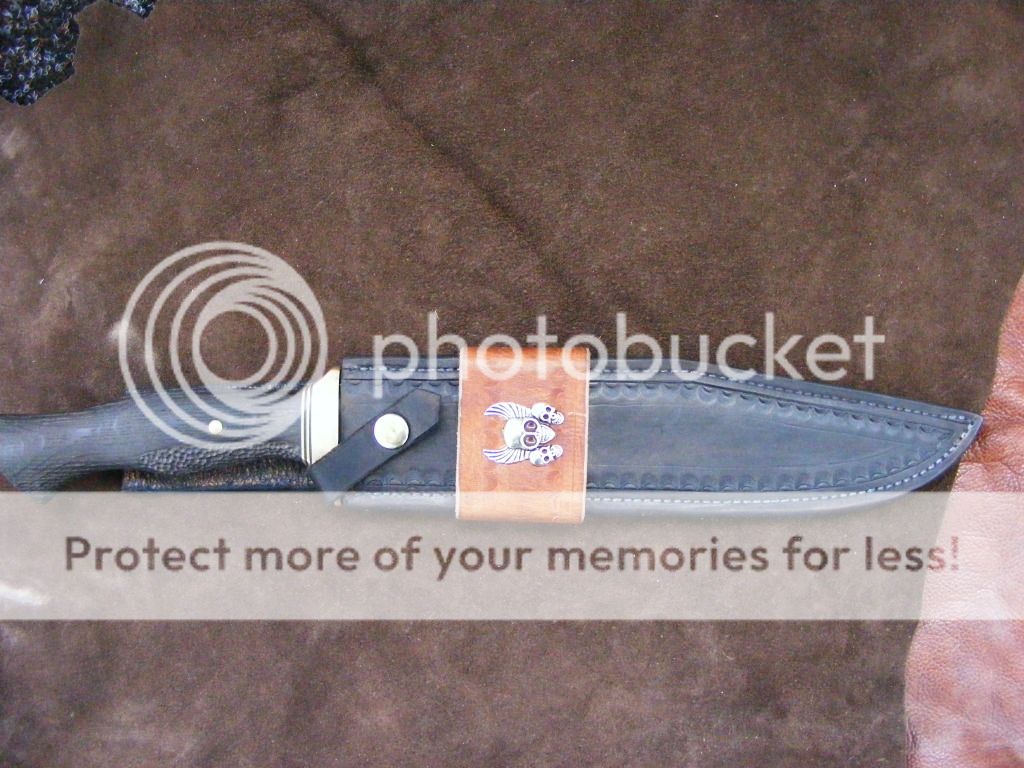

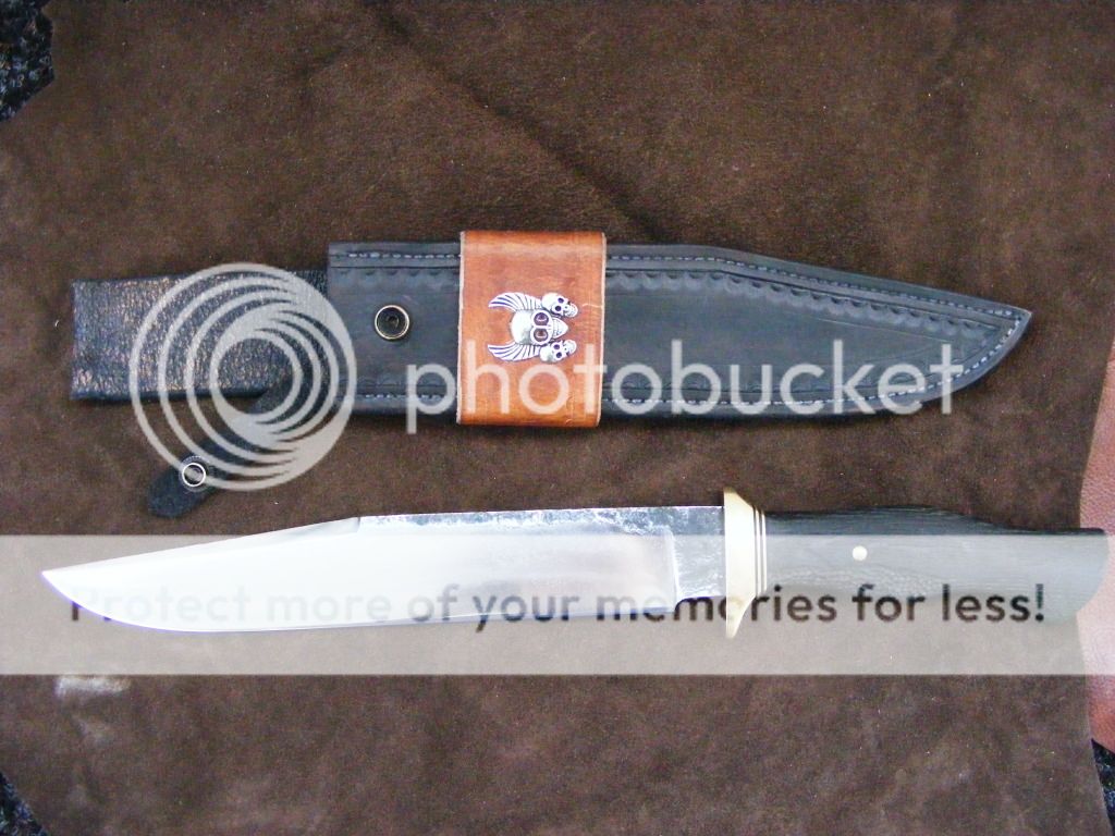

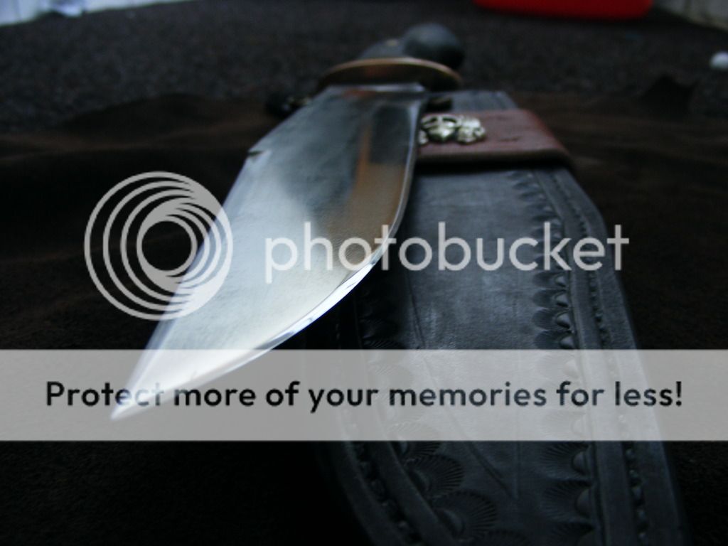

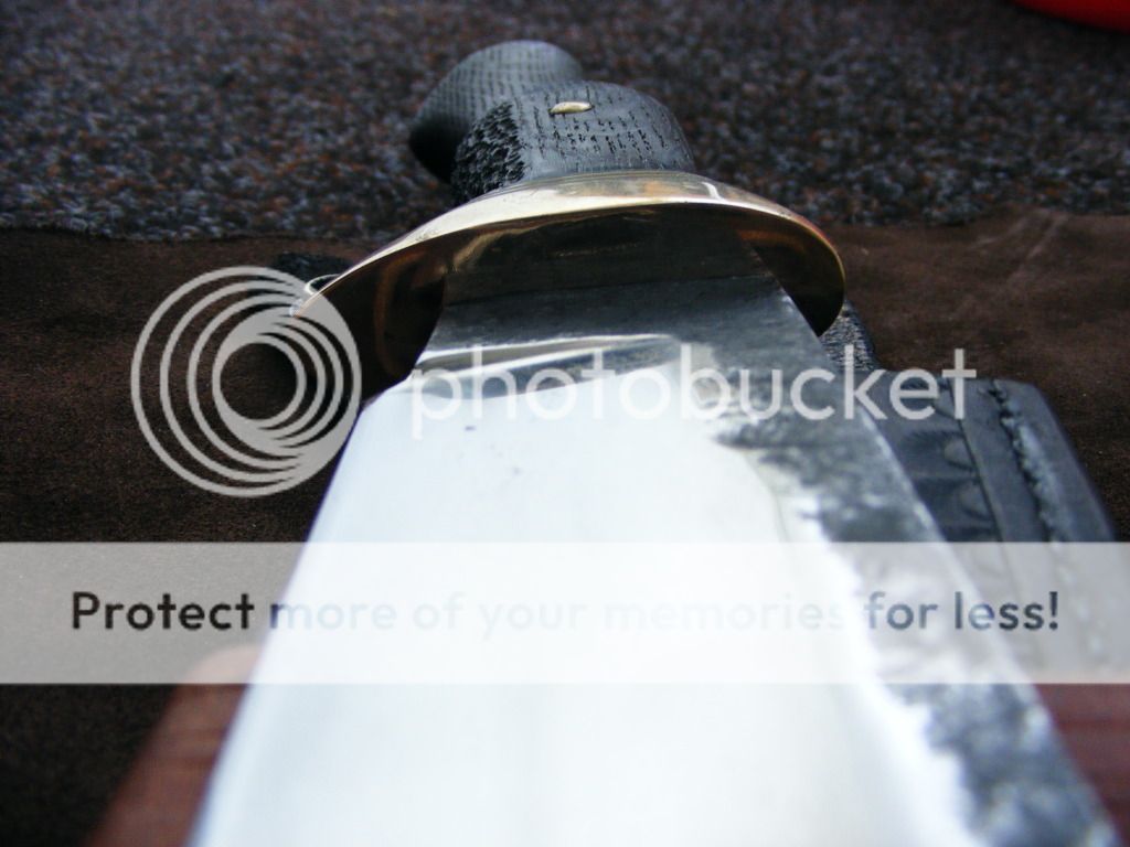

first bowie knife
May 4, 2008
7

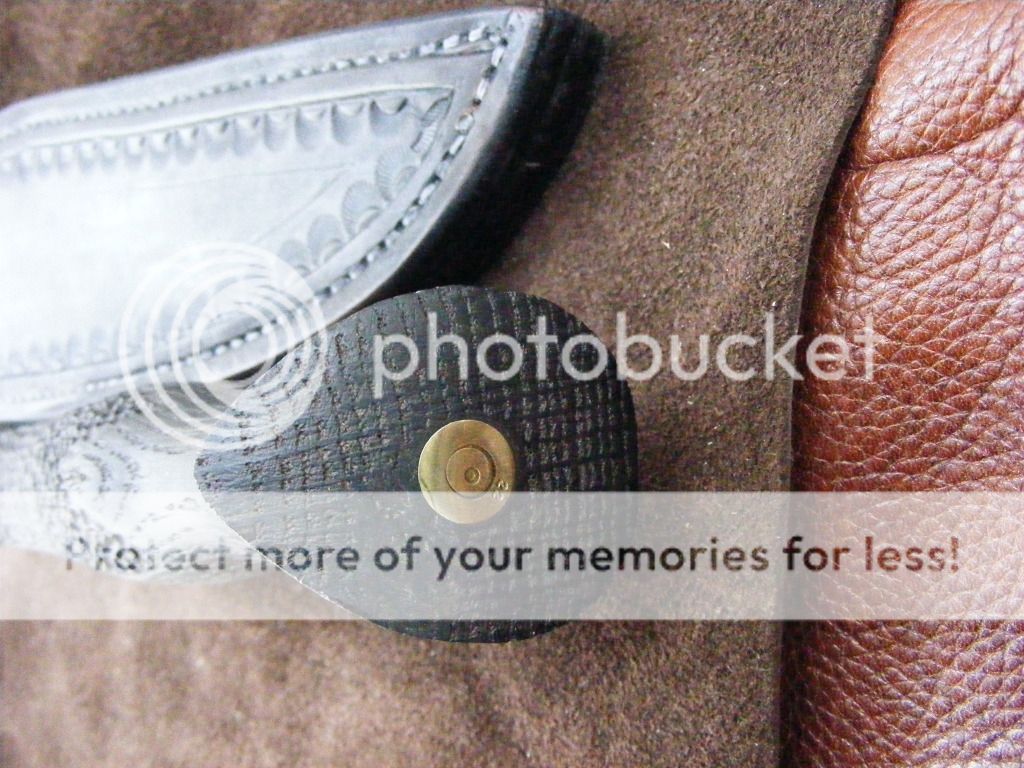

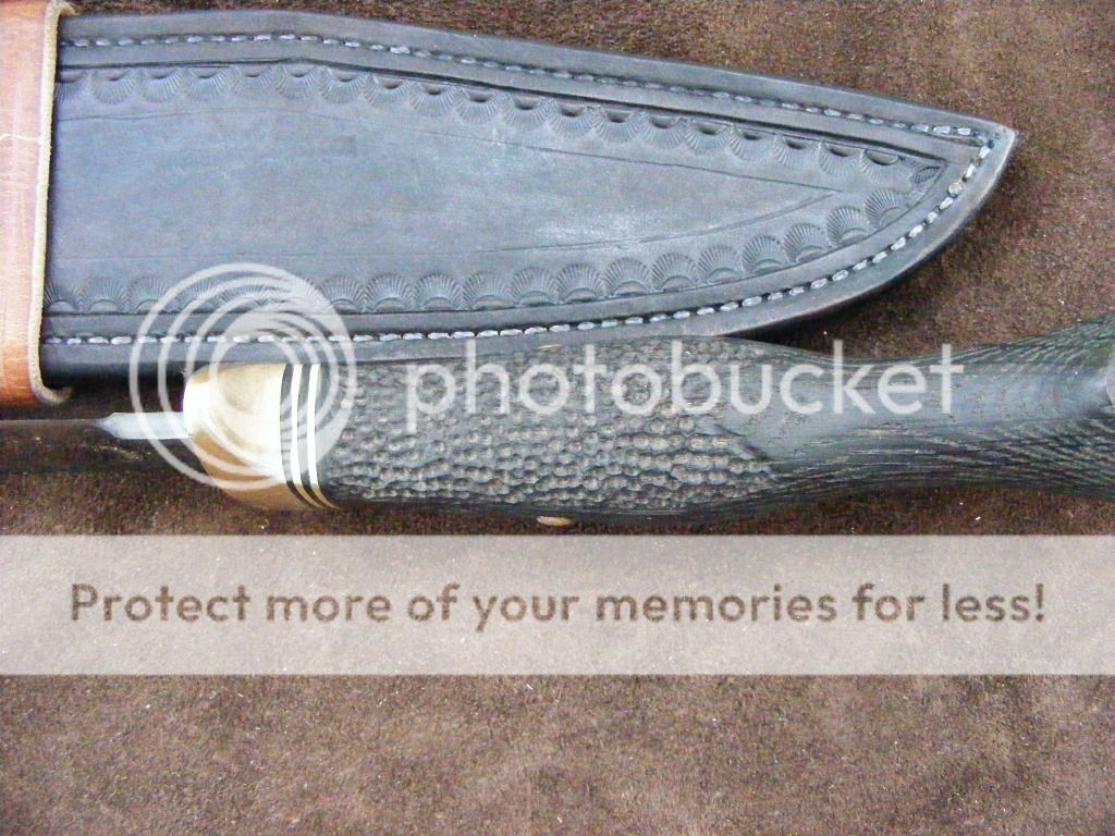

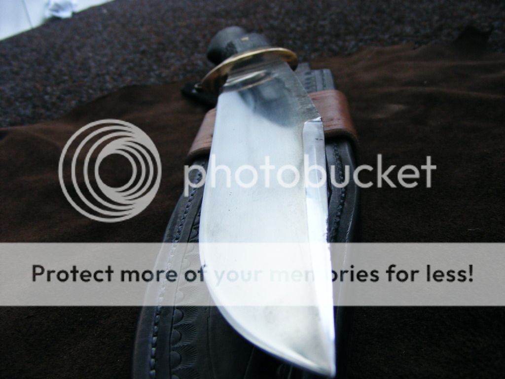

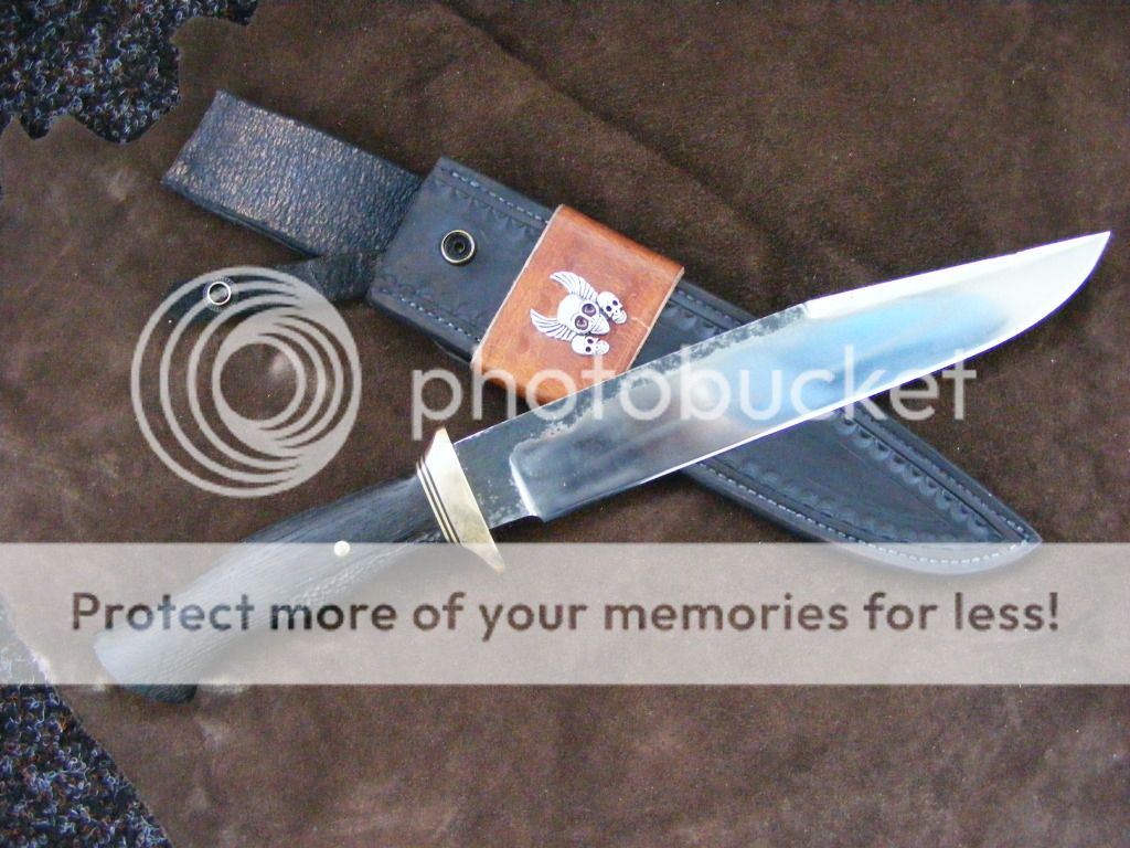

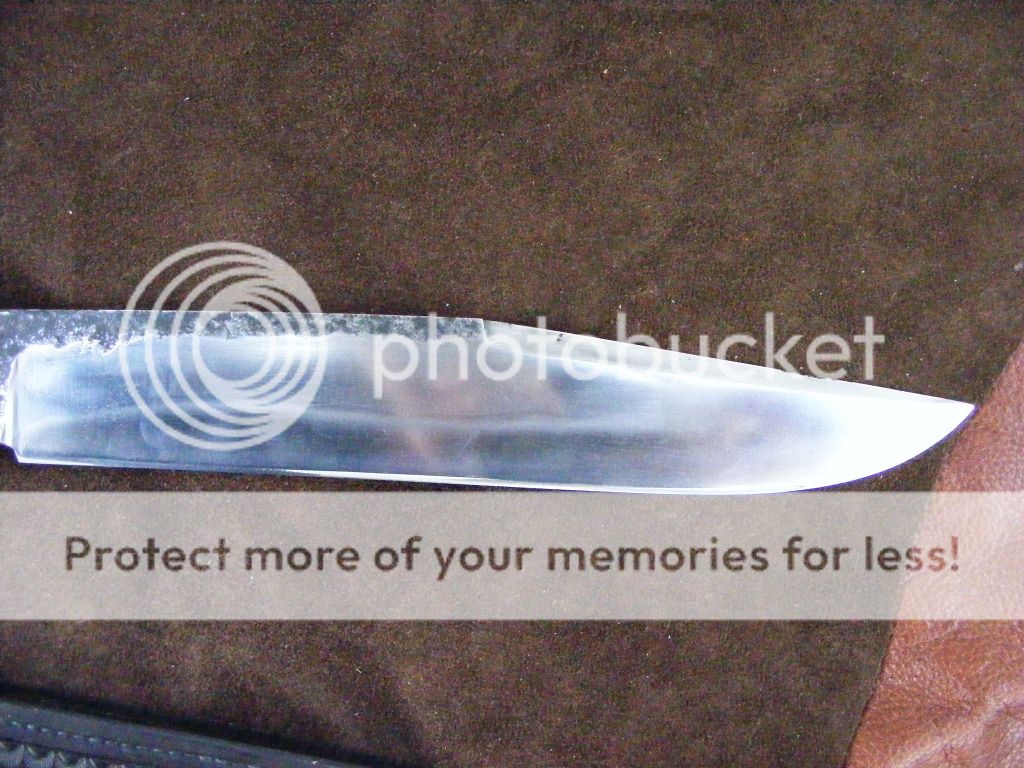

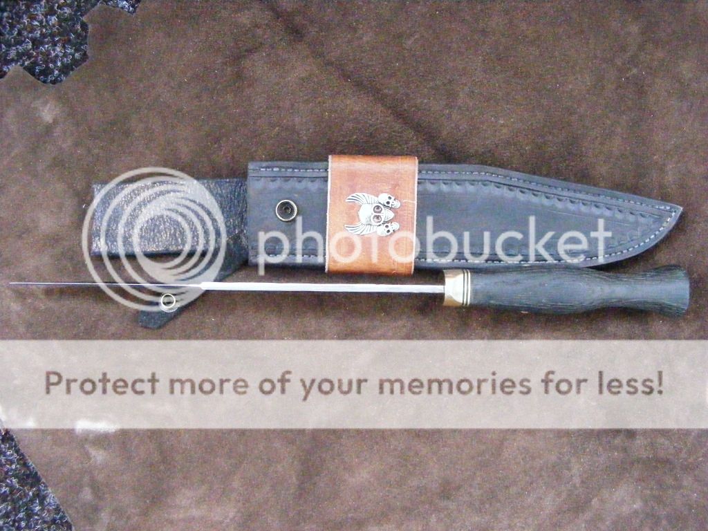

like the title saise this is my first bowie knife, the knife is forged out of a ballbarring case 18 mm thick, the overall lenght is 43 cm, blade is 28 cm long and 4.8 mm thick , the guard is bronze and the handle is bog oak, the tang is riveted and compresed with a screw witch is hiden with the bullet case, diferential heat treatment with hamon
riticism always welcome
10x Bogdan
For a first knife I would be proud to claim it.
Overall rates a :thumbup:
Larry
Tinkerer

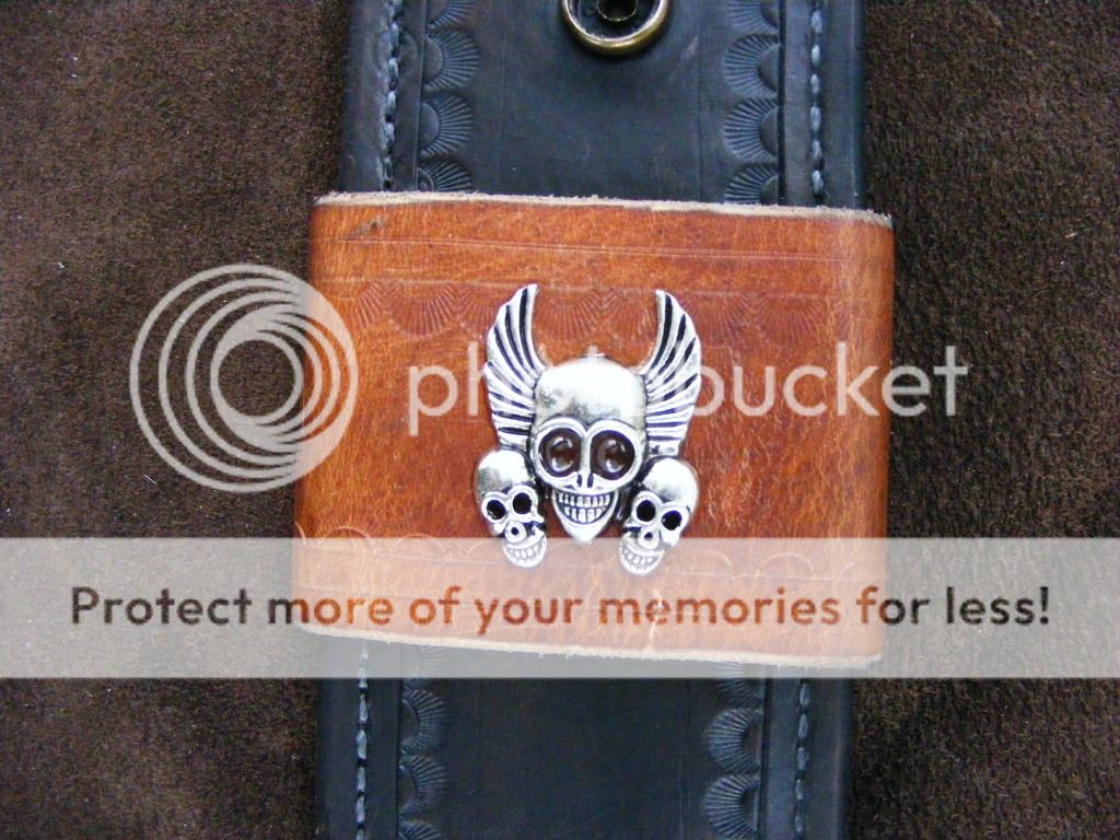

Works for me....I like the texture you did on the handle, nice touch. :)

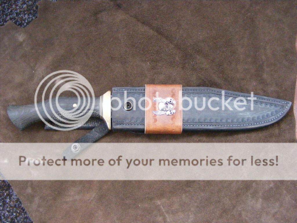

In my Humble O you did a great job on that! I like the forge finish, temper line, finger guard and the sheath too. However I prefer a more random stipple.
Nice very nice.
Steve
Potomac Forge
W.F. Moran Jr. Museum & Foundation
10x all for your input about the knife, butt it took me some time to finish it, i started in february this year and i finish it in september
