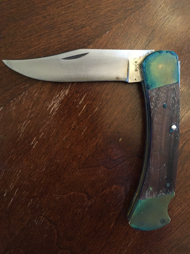

Good evening-
Just received my first Buck 110, 2 dot and think that I got a good deal for $45.00. Being a newbe, I am wondering if it is possible to ascertain the precise date of manufacture and not just a range? Also, I am wondering what the experts here think about the condition of the 110 and whether it would be worth while to send it to Buck for the so-called "spa treatment?"
Thanks.
John
Esq, welcome. You got a good 2 dot 110. The blade looks full and not much damage to the frame. You could work wonders with some Flitz and elbow grease on your 110. The handles are matching. Did you get the sheath and box with it? It looks to be late in the era because of the brass pin pattern. I would surmise that your 110 was mfg. in 1979 or 80 because of the pin pattern and pin size. DM

Thanks for the info, David. I got an original leather sheath but not the box and paperwork.
That knife is certainly in the 1974-1980 range. David would know better than I on the late date for the range. That is a nice knife that should last a couple of lifetimes. Those ebony scales are nice and there are only a couple of dings on the brass frame. Buck could do a nice spa treatment on it. However, I think some Brasso on the brass and flitz on the blade (or brasso or other metal polish for stainless steel) would make it look nearly as good and be more fun to do. Just turn on a baseball game and go to polishing.
You're welcome. When you can, post a picture of the sheath, front and back with the flap raised. DM

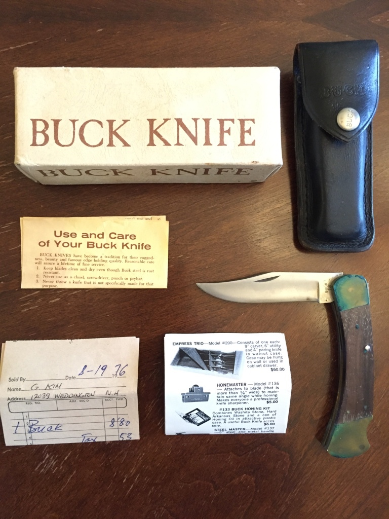

David, I don't doubt your information, but then I find these on eBay. Thoughts?
Example #1 - NIB, 2 dot 110, 3 small brass rivets, original sales receipt dated 8-19-76
Example #2 - Perhaps not as strong of evidence, but still...
"Buck 110 Hunter Knife, In original Box with paperwork as shown, One dot on either side of the model number on knife (3 small brass pins) Signed on bottom of box Frank Maciel age 21 5/21/1976"

That certainly looks like a early 2 dot and would lend solid footing toward Bill Keys, George Stenzil & Richard Matheny's writing & time frame for introduction. Which none of these will appear on here and offer us a write up on this subject. Perhaps Larry O. would give a chime-in toward the time of 2 dot introduction. I have not conducted the research these guys have. I am merely repeating what they have stated. And the sky will likely not fall on us should we find it is most certainly 1975. DM
What do you think about the 110 with 3 small brass pins and a 1976 sales receipt? Does that change your thinking on the 1978 pin progression?
It is a vari. 6 / 22. Joe's data sheets gives a range of dates for all 2 dot versions. (atleast on my copies) Thus, escaping definite parameters. The bay is known for a low level of accuracy, both in description and knowledge of items offered. As they are not in the business of accuracy. We know they are in it for Sales. The receipt could have been bundled in with a pile of items from an estate sale. Or who knows. I trust the evidence of the 3 gents named whom I know and have heard their presentation of legitimate research and findings. Something foreign to the bay. DM
