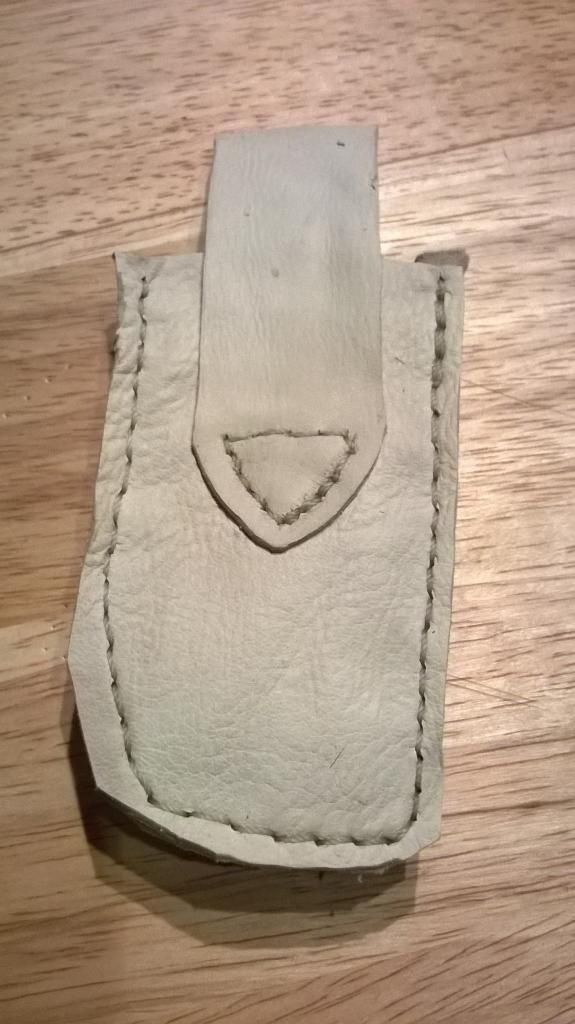

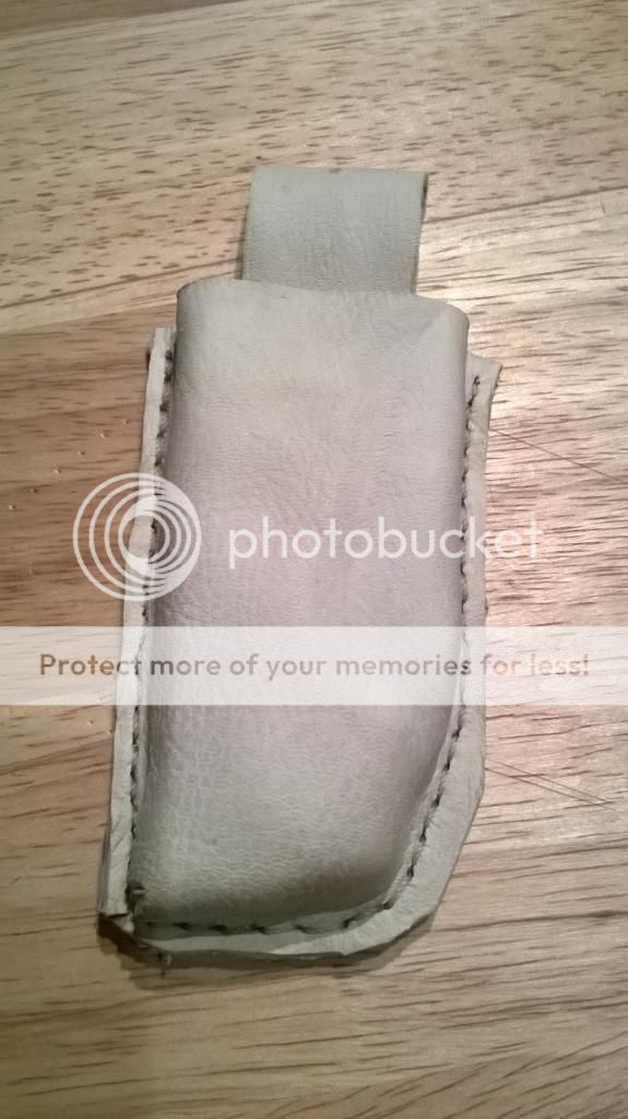

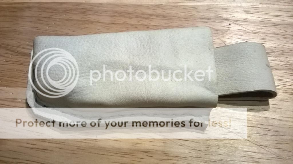

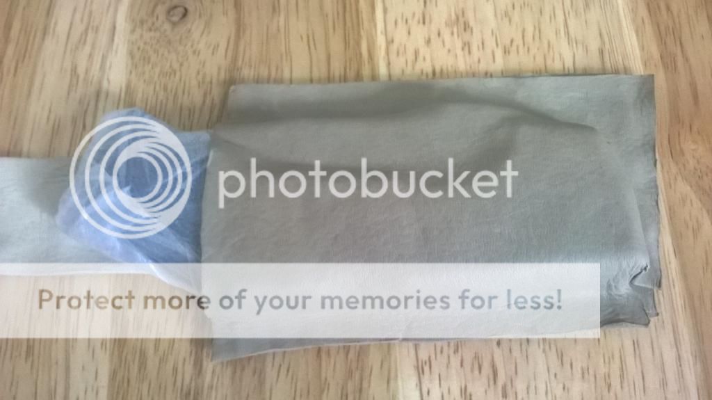

Tools from Tandy got here and I still don't have any decent leather. Out of impatience I remembered I had a scrap of some deer hide in a closet, so decided to do a little pocket protector for my backup folder (Cold Steel AK-47). It gets used just for fine work, so mostly it sits in my back pocket and the G10 slowly eats a hole through my clothes, so I thought why not make a little fitted pocket protector, molded similar to what Gary does, and have the pocket clip go over my pocket and the leather.
Now I'm waiting on it to dry.
I'm putting a belt loop on just in case I decide to forgo the pocket altogether.
Question: I think I'm on the right track here. I expect I should not use the stitch groover on deer hide as it's rather soft.
I don't believe I would use the groover on the deer skin. It is so soft that getting a decent line would be near impossible, as would consistent depth of the line.
The impatience you mention is something you need to work on getting rid of right now…..sooner than later.
The belt loop would have been much easier if you had put it on (stitched) before you glued it up (if it is glued up). If it is truly a pocket sheath, then it needs no belt loop.
Any chrome tanned leather such as deer skin really is not the best choice for the body of a sheath. Veg. Tan leather in about 6 oz. and up is a far better choice.
Paul
The stitch groover was useless on the deer, I tried a test patch. Just seemed like it pulled the top layer. Same thing with the beveler. This stuff is like suede. As for the belt loop I partly just wanted to do one to get the practice and partly think I may hang it on my belt on a part-time basis. We'll see. I agree I need real leather.
Anyway, not bad I think for a first effort.
