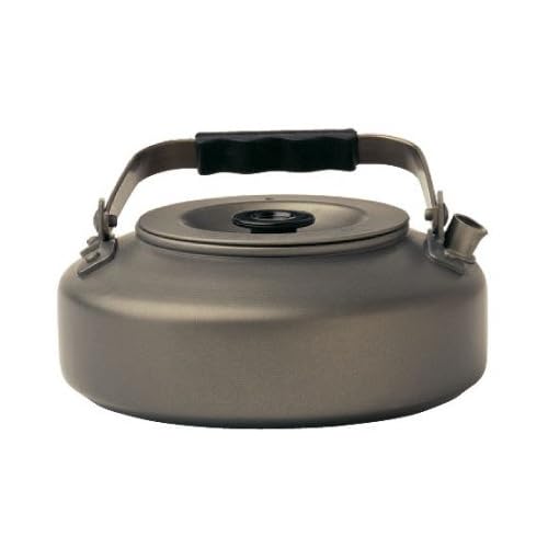

Just a word of advice if anyone is interested in this particular kettle.
As I was looking around, I noticed that several vendors have the pics swapped between the .9L and the 1.5L.
Be sure you know what you're getting.
The .9L is the shorter, squatter one.
The 1.5L is the taller one.
