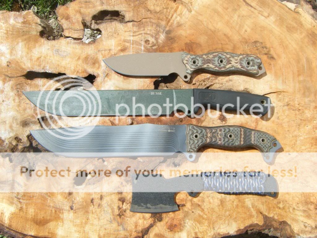

Okay I have an abundance of high quality blades under 6" (BRKTs and Fallknivens). I'm looking for my first quality biggun. Something in the 8-9" mark, good for chopping and batoning.
I'm having trouble however deciding and keep around in circles (you know how it is when you start reading forums posts you can go in all sorts of tangents).
I'm interested in the:
Chopweiler
With a blade length of 7.5" it's a little short compared to the rest but the handle shape should allow at least another inch in leverage. Overall design looks fantastic and since it is still only 7.5 it should be lighter... in theory (having trouble finding weights for these knives). Cons - hard to find! Seems everyone wants to hang onto these ones which says a lot too I guess.
M9
At 9.5" it looks like a real chopper. Looks great although I'd love to see it with the same handle as the chopweiler. Seems slightly easier to get a hold of on the forums.
Dogfather
Looks great but more basic. I'm sure it will get the job done but it doesn't have the same sort of 'special' the swamp rats have. Cheaper though which is always welcome.
and the dark horse...
Fehrman Final Judgement
Very different looks, a touch more expensive but still excellent quality. Real advantage here is that I can buy from the maker and get the options I want without having to wait for someone to sell his. And I know it is brand new. Cons - not sure I'm enamored with the handle shape.
I'd consider the First Strike too if someone has direct experience.
