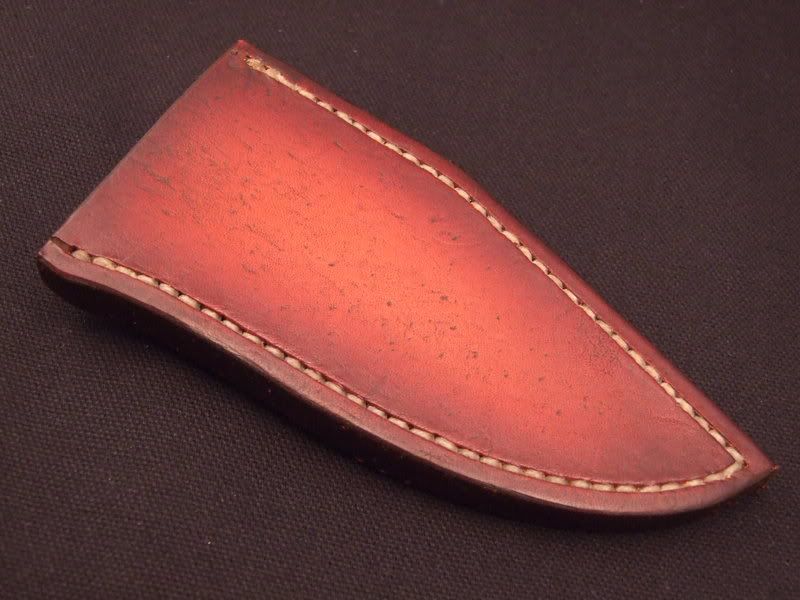

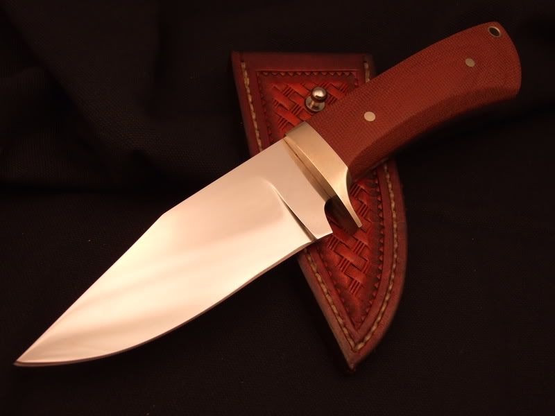

I just finished this one. Its a first for me. I've been diddlin' around w/ making knives and such for a little while now so I figured its about time to make something to put them in. Its 8-9 oz , didnt do the frog for it yet(does anyone have a good picture of the front and back of one?) Tandy eco-flow gel antique w/ fieblings dark brown airbrushed around edges. I found out the fieblings doesnt really like to penetrate through the gel antique, as it has some carnuba and acts as a slight resist. A little mottled on the front, But I think it worked out o.k.
Thanks for looking, Shawn

I've found that working the dyes first and then antiqe over that tends to get the best results. Though I've done it both ways depending on the effect I want.
Thanks folks, I appreciate it. Dwayne, I'll have to try the dyeing first on the next one.

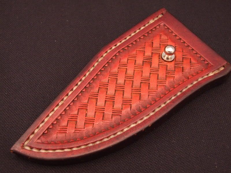

i know this is an old post , but i cant quote the original thread, as im on a pda and most options are disabled .
i am looking at the OP 's original pics with the ball stud. did, or could you, get any pivot from this?
