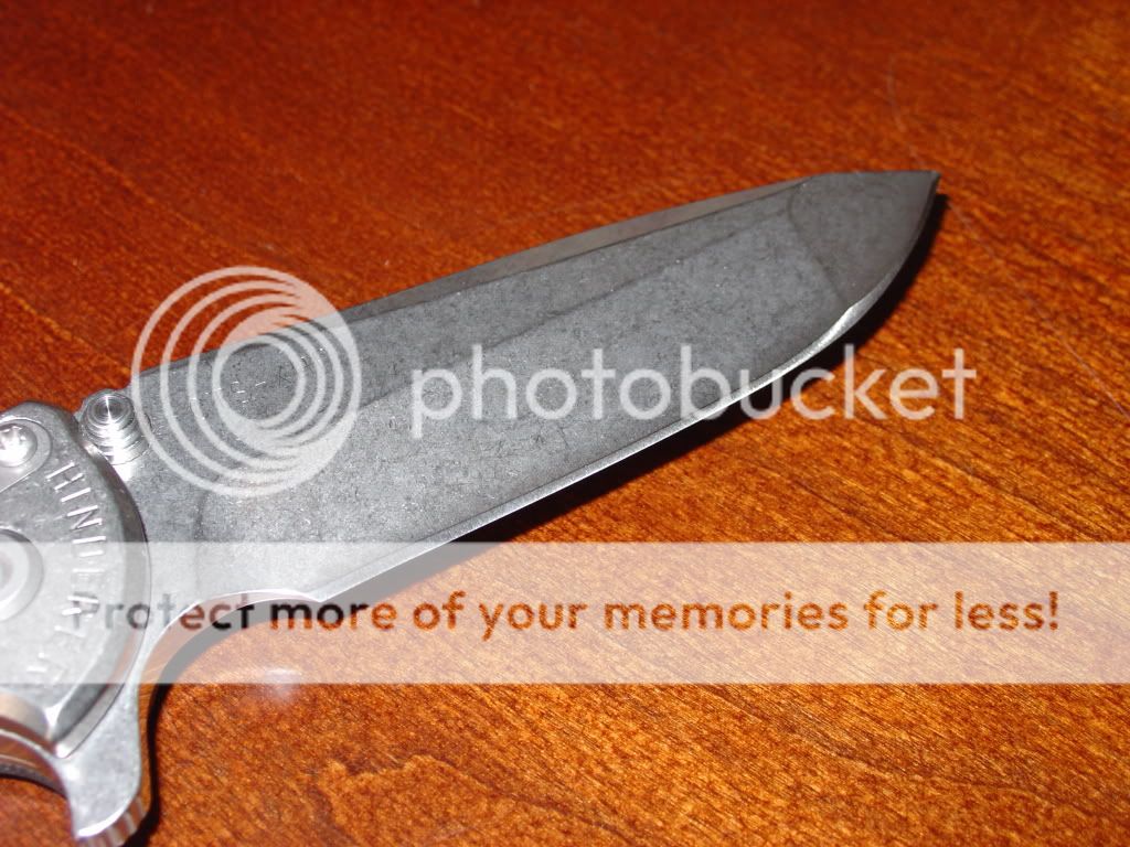

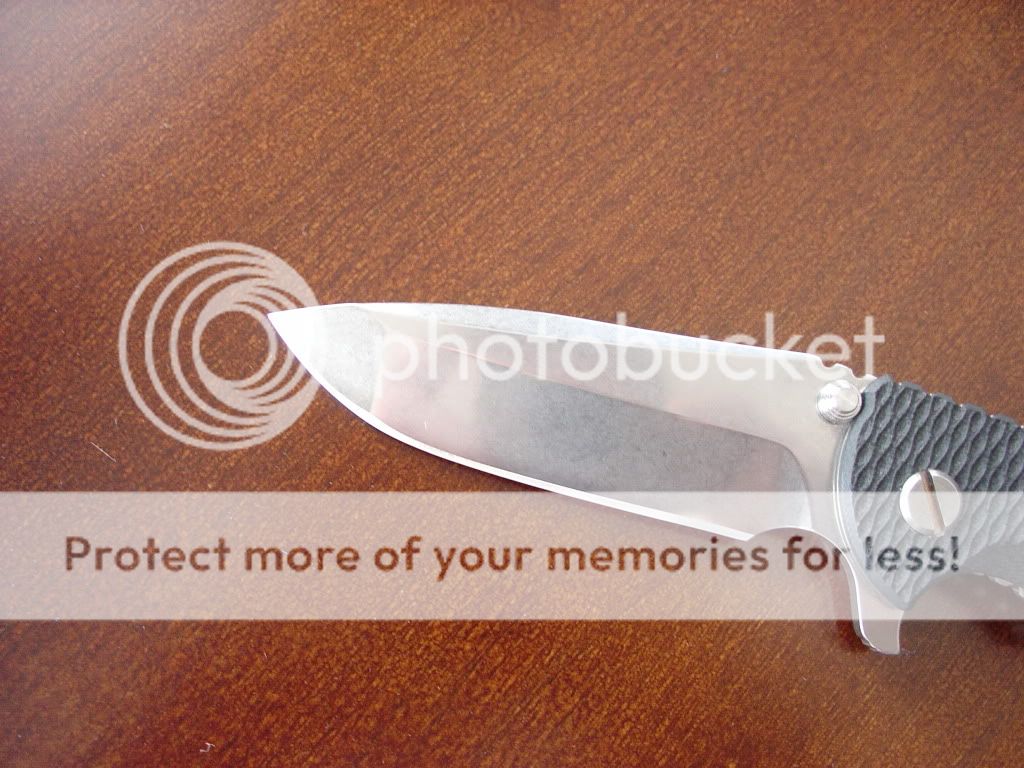

This thing is a light saber now, and just barely touching the edge makes me say, "oh sh#$" . I am very happy with the results, and relieved that all went well. IMO, convex edges are the way to go and I now have confidence that I can do my exspensive knives on the belt sander. Tried to take a few pics to capture the edge somewhat, however my picture taking, especially close-ups, leave alot to be desired. Here ya go, this convex edge makes the XM even sweeter (if that is even possible ).

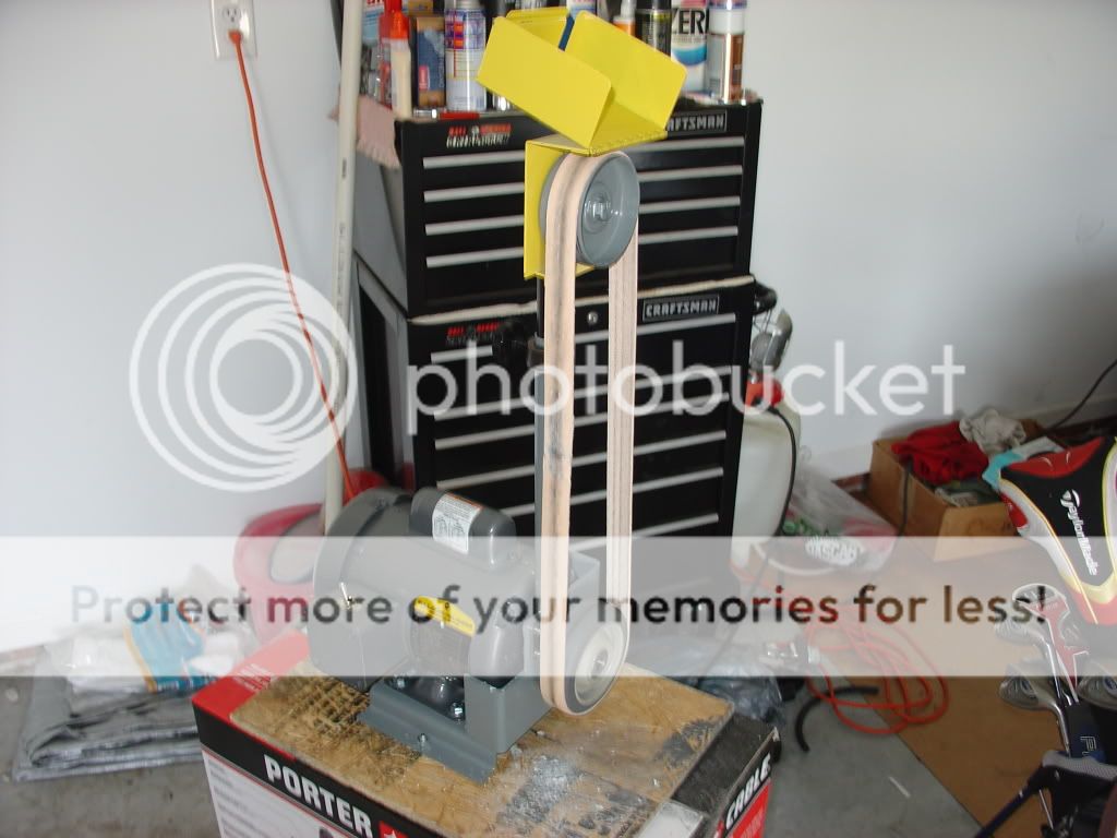

Belt sander with the leather belt installed. Been using a slotted paper wheel to finish, but wanted to try the leather, works great also.
My EDC convexed XM-18 3.5...:D
Bapple, what belt sander are you using? Thinking of buying one, but I'm looking at the Wicked Edge system as well. Your pictures make me lean towards a belt sander :).
Kalamazoo 1x42, same one i use.
Another check-in for a Kalamazoo user here, I love that thing and use it all the time. By far the easiest razor edge you'll ever put on a knife.
Ironic, BRO, I did buy one. Now guess what I'm buying as well? :D If you want to do SINGLE knives, then you might be better off with the WEPS, given the smaller footprint and having the different grits on the paddles instead of belts that you have to store as well. If you're doing more than a few knives a month, the belt is THE king. Not sure about the paper wheels, I hear they're pretty good as well, but I know and love my belt.
